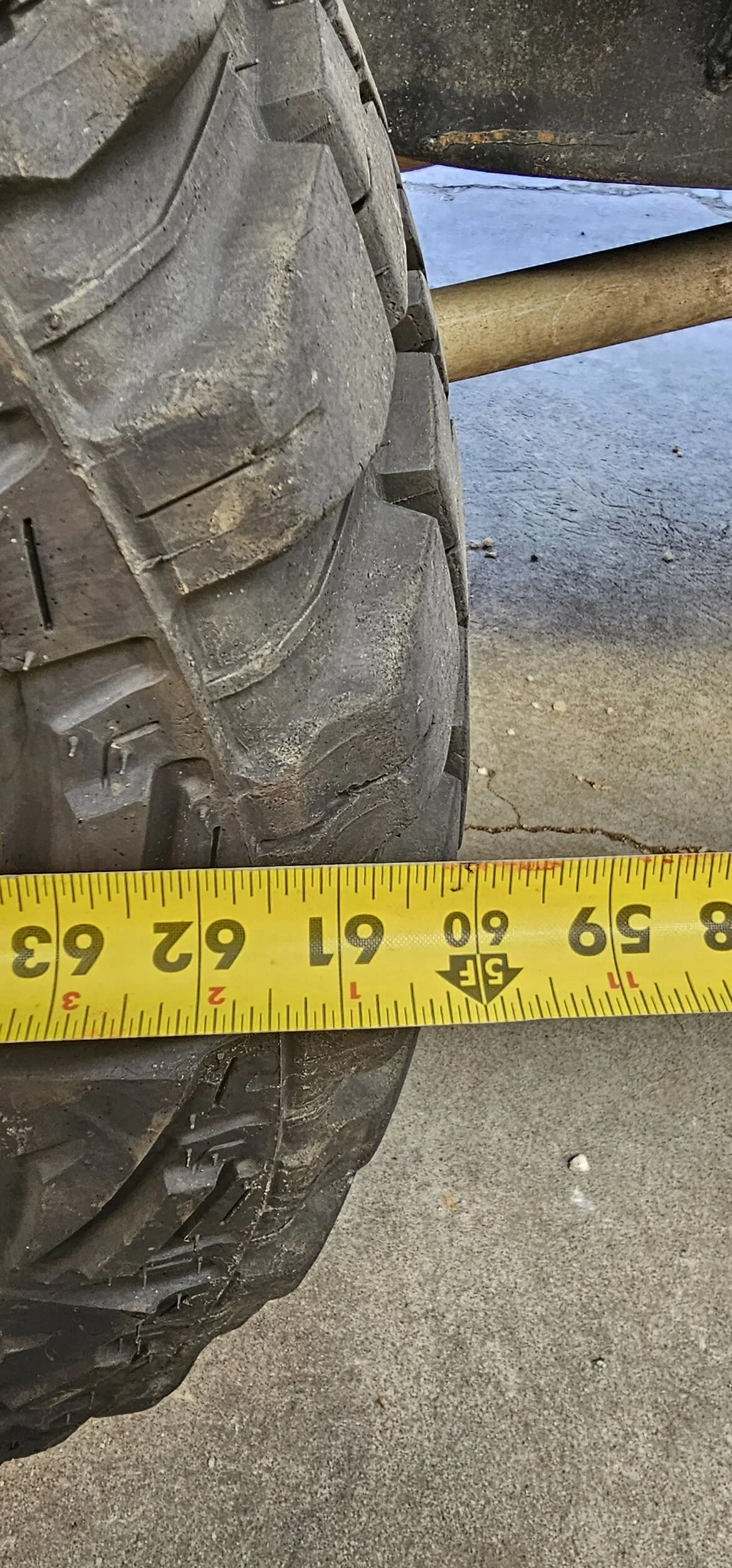

Both of our goals is to get to about 101" on 35s. Mine has 60" between tire faces, which is consistent with my plan for a 6-7" rear stretch.
It's a floating number. But if you math out the various JV tire size to wheelbase recommendations, then 66" tends to be the minimum distance across the board.
