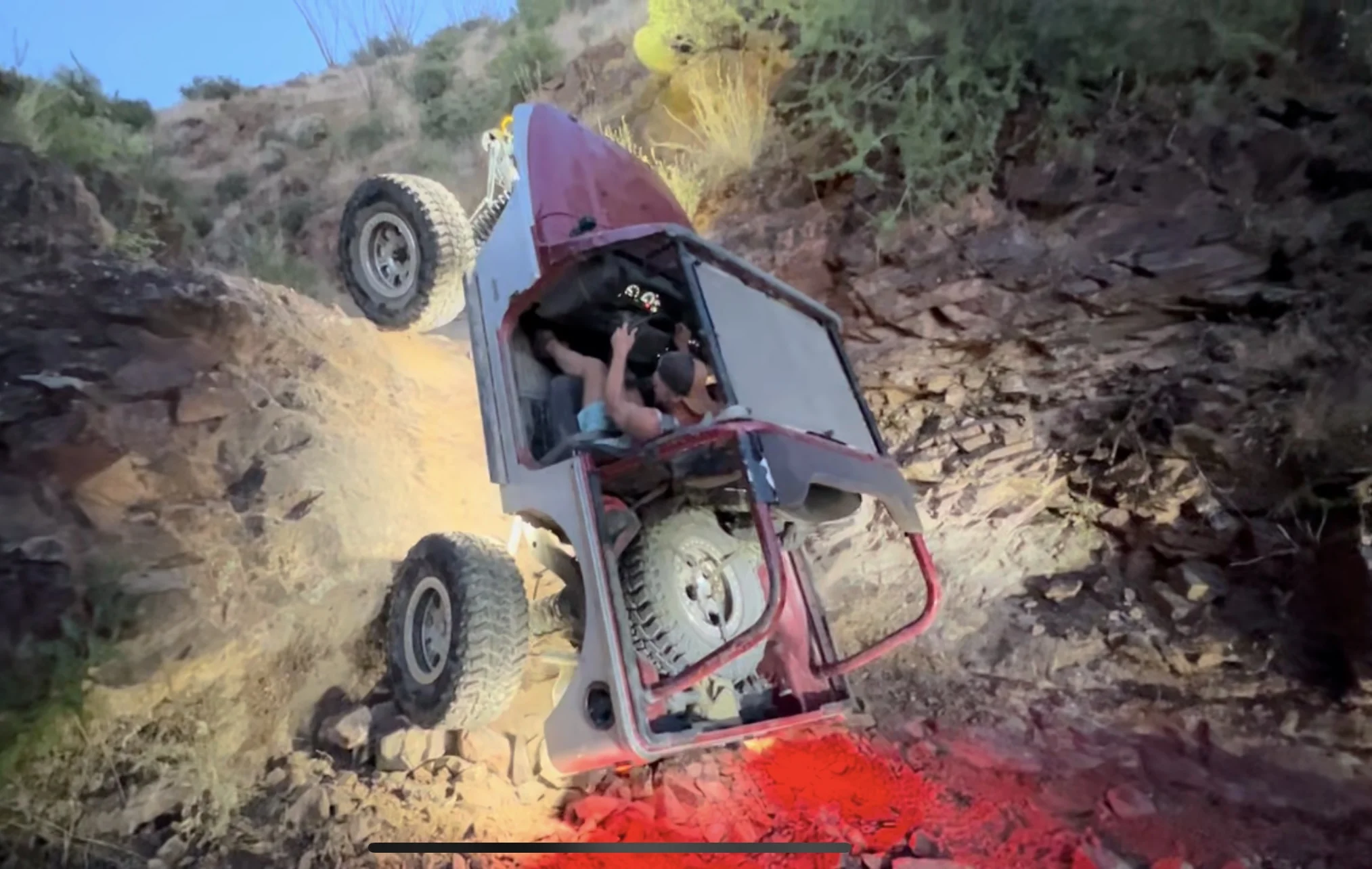

That step looks near vertical. If its as steep as it looks, how did you get your fronts up without going over backwards?
It was very light for sure but doable to get the fronts up there. Climbing the undercut at the bottom not so feasible for me.

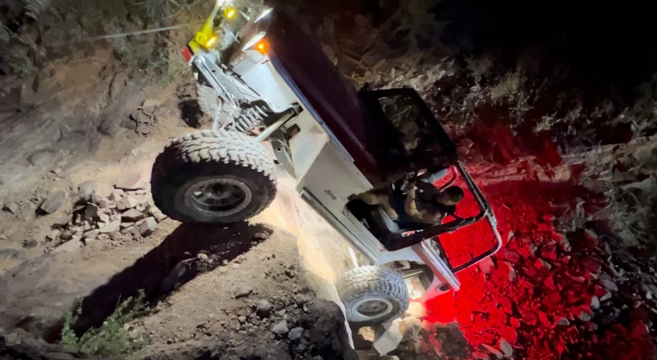

Same fall different view. No cable hooked up here yet. I’ll be curious if I can start making this stuff with an 8” stretch

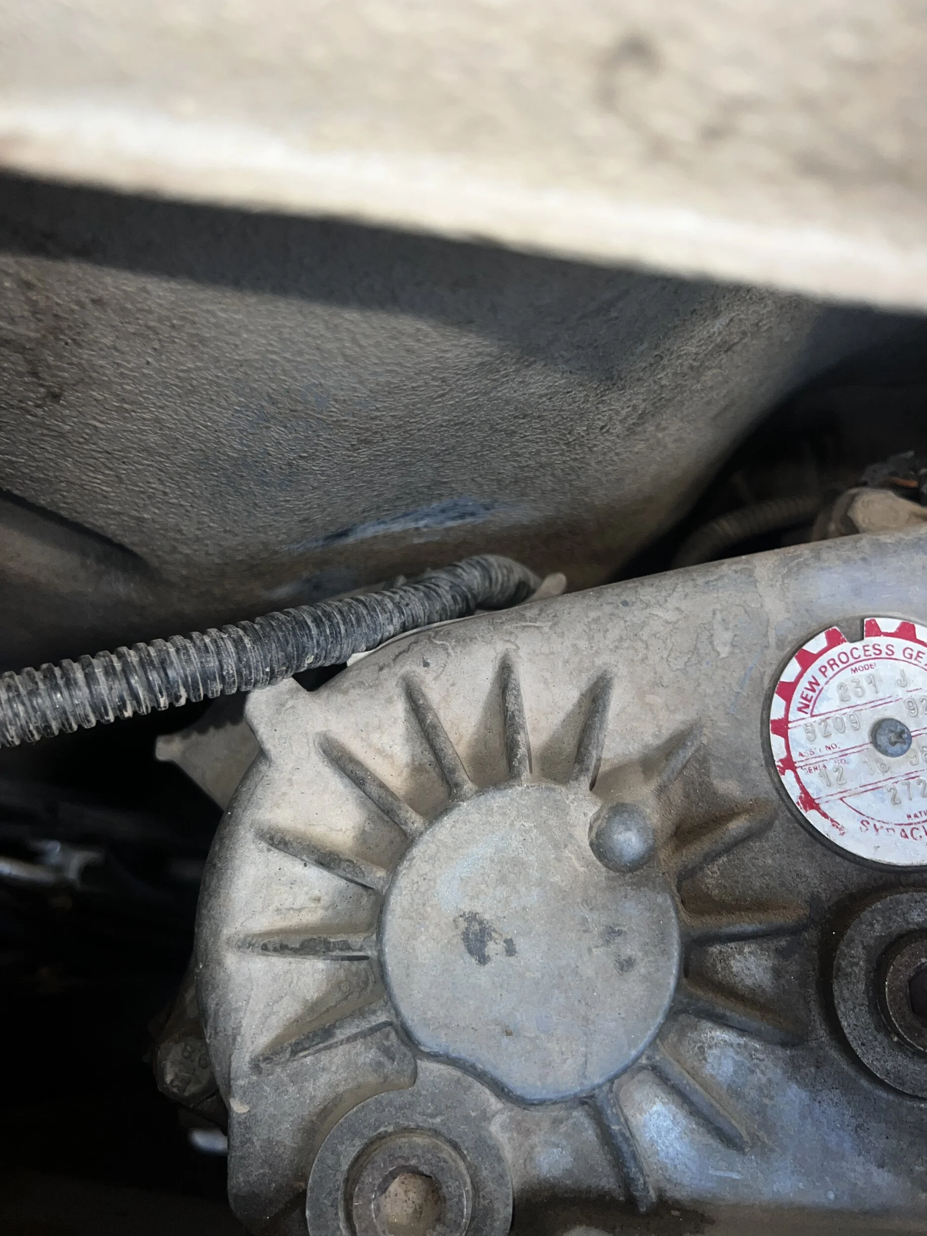

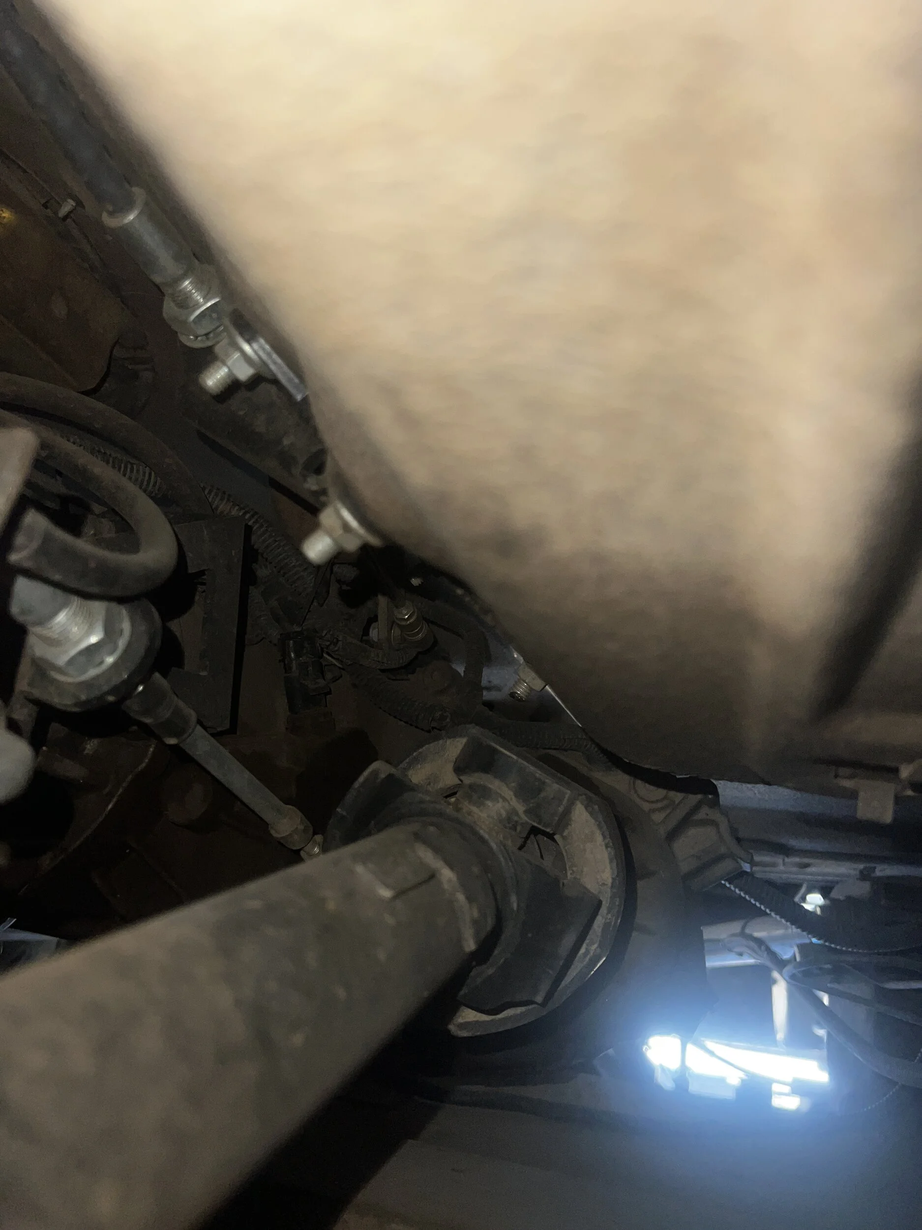

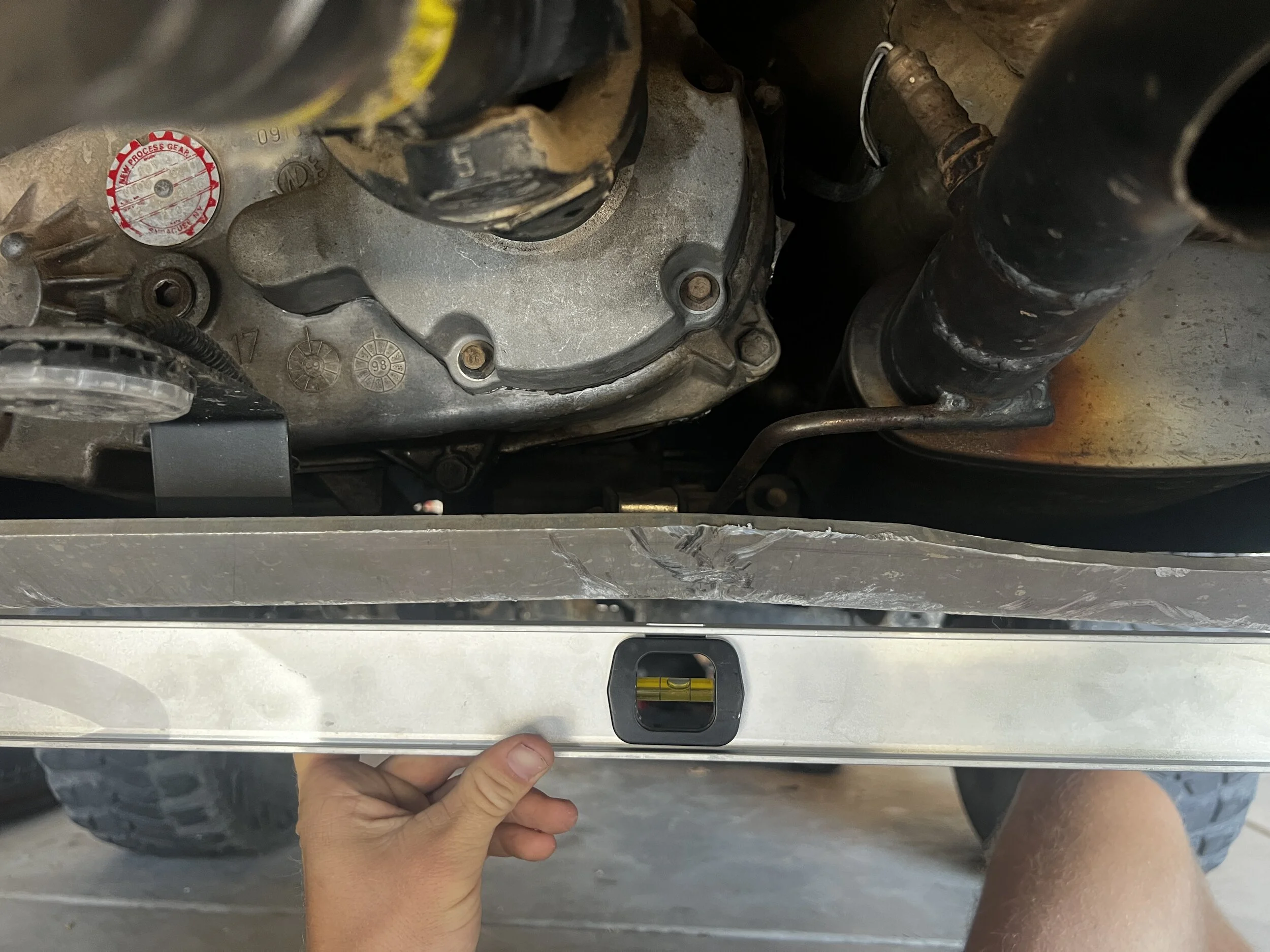

The first is pretty clear, I’m hearing my tcase bump into my tub sometimes when the Jeep is flexed out or going fast over choppy stuff. Frint driveshaft is also hitting one of the bolts that holds the savvy shift plate to the tub. Those noises are new… My skid is pretty dented so it’s probably just pushing shit higher than it used to be. The other thing is the tcase feels a little floppy just grabbing ahold of it so when I drop the skid to flatten it I’ll check the trans mount.
My 2nd problem is that when I’m at a dead stop and hit the gas hard, I get a big old stutter. Like the feeling of driving over really rough washboard road. Only from a dead stop in first. If I already have some momentum going I can hit gas hard and no worries. I pulled the driveshaft last night and inspected it and it seems fine. Probably not pinion angle because it’s fine at fast speeds although I’m sure the angle isn’t perfect right now with the bent skid. Maybe transmission mount is smoked? Maybe same issues that are causing tcase to hit the tub? I’ll report back when I drop the skid.

Same feeling happened with me on my CJ7, turned out to be the forward mounting bolts had backed out and was causing the transmission to move around...
the forward mounting bolts on the transmission mount?
