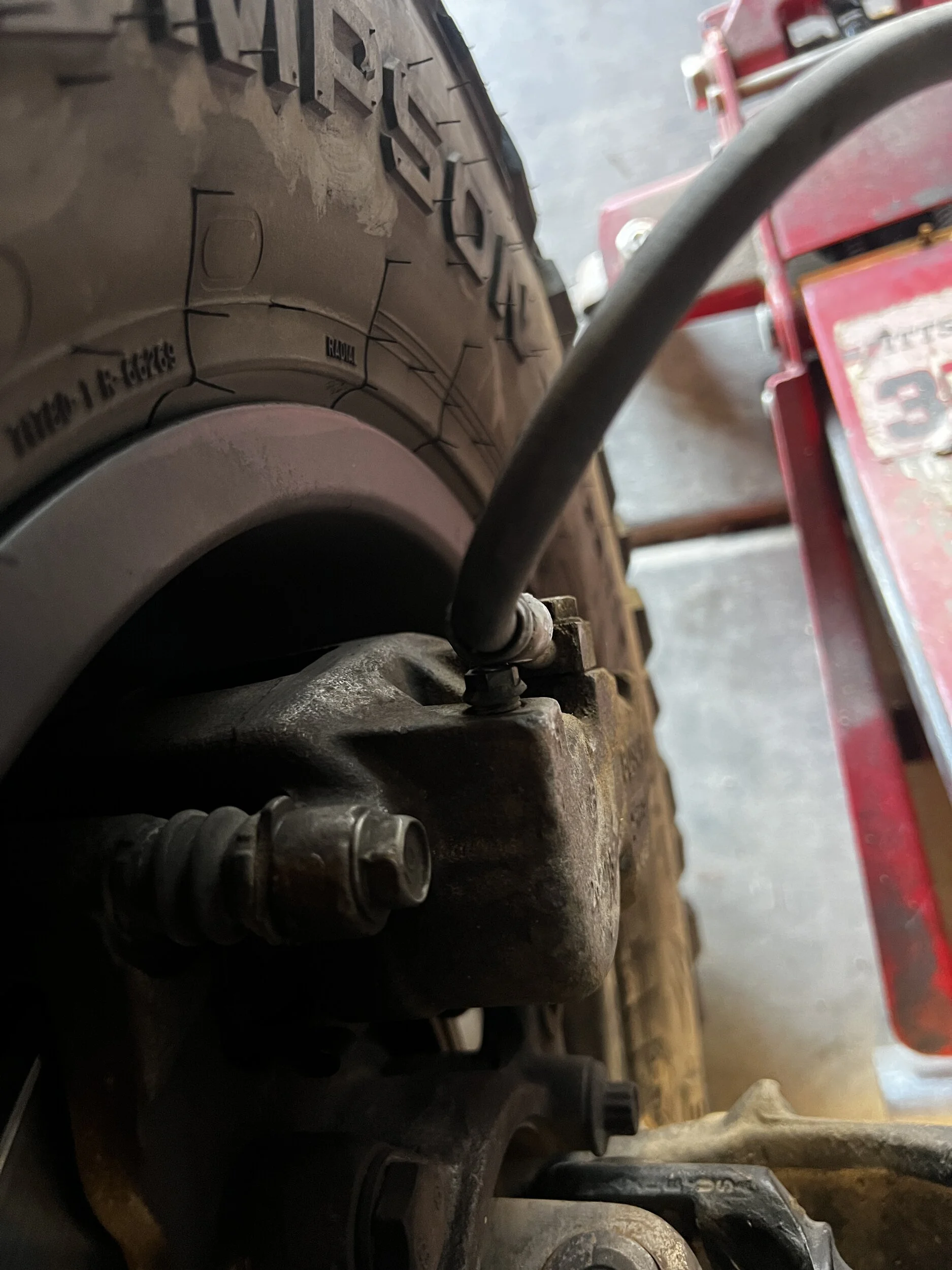

Fun day today on Highway to hell and LOD. Damn near put the jeep all the way on its side in a boulder garden and still recovered it. Slashed a tire so that sucks but thankful I carry a spare. Sucked a rock into the front wheel well and it sheared off the bleeder nipple as well as knocked the banjo bolt loose so brake pedal went to the floor. Luckily tightened that bolt back up and was good to go. Neither of my hubs will unlock for some reason now on the way home. Very strange that both of them are failing. Never had that happen before. I bungee corded my front driveshaft to the frame for the drive home.

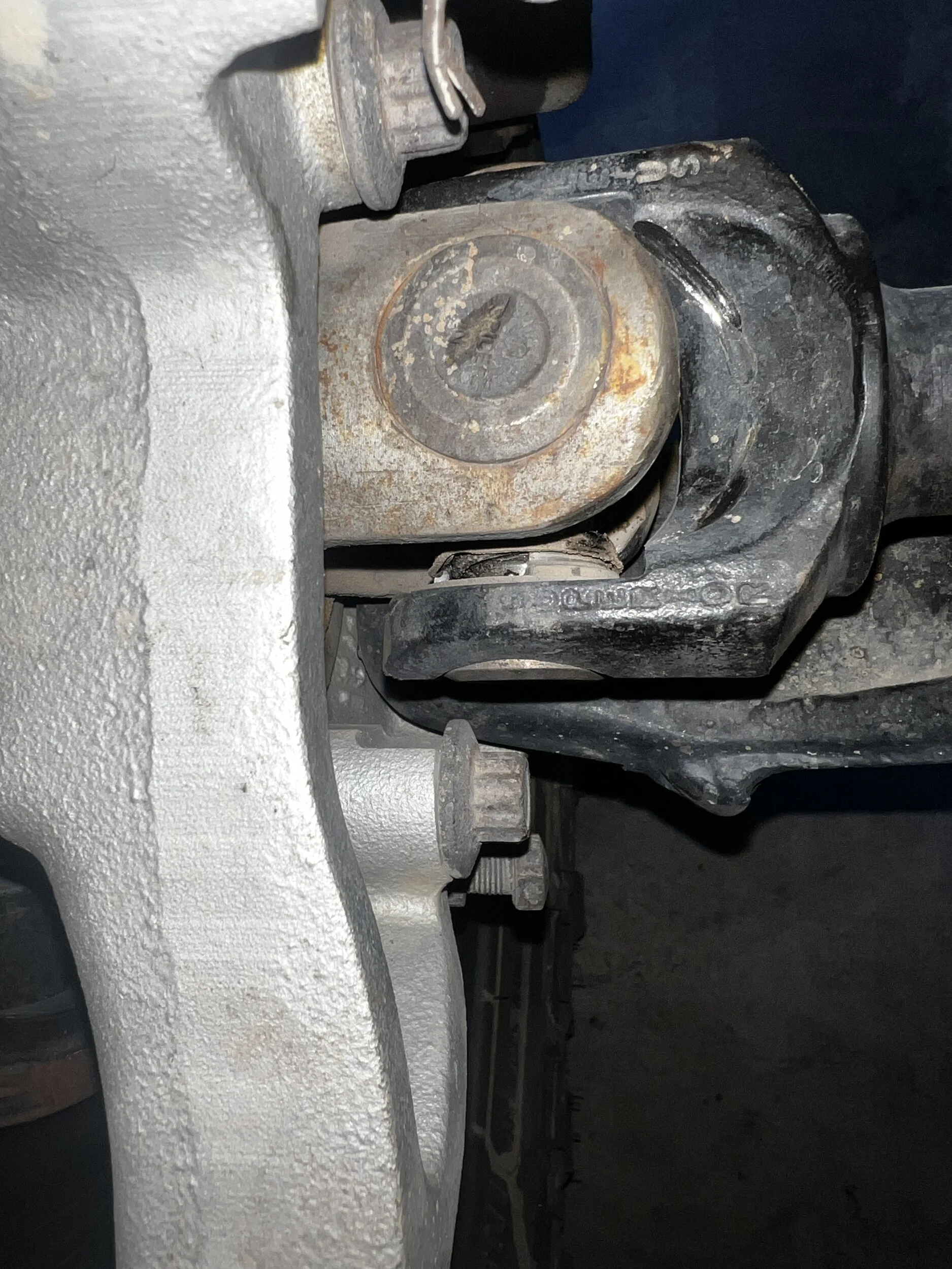

Looks like the stub yoke was rubbing on the inner yoke and caused the U joint cap to bust.

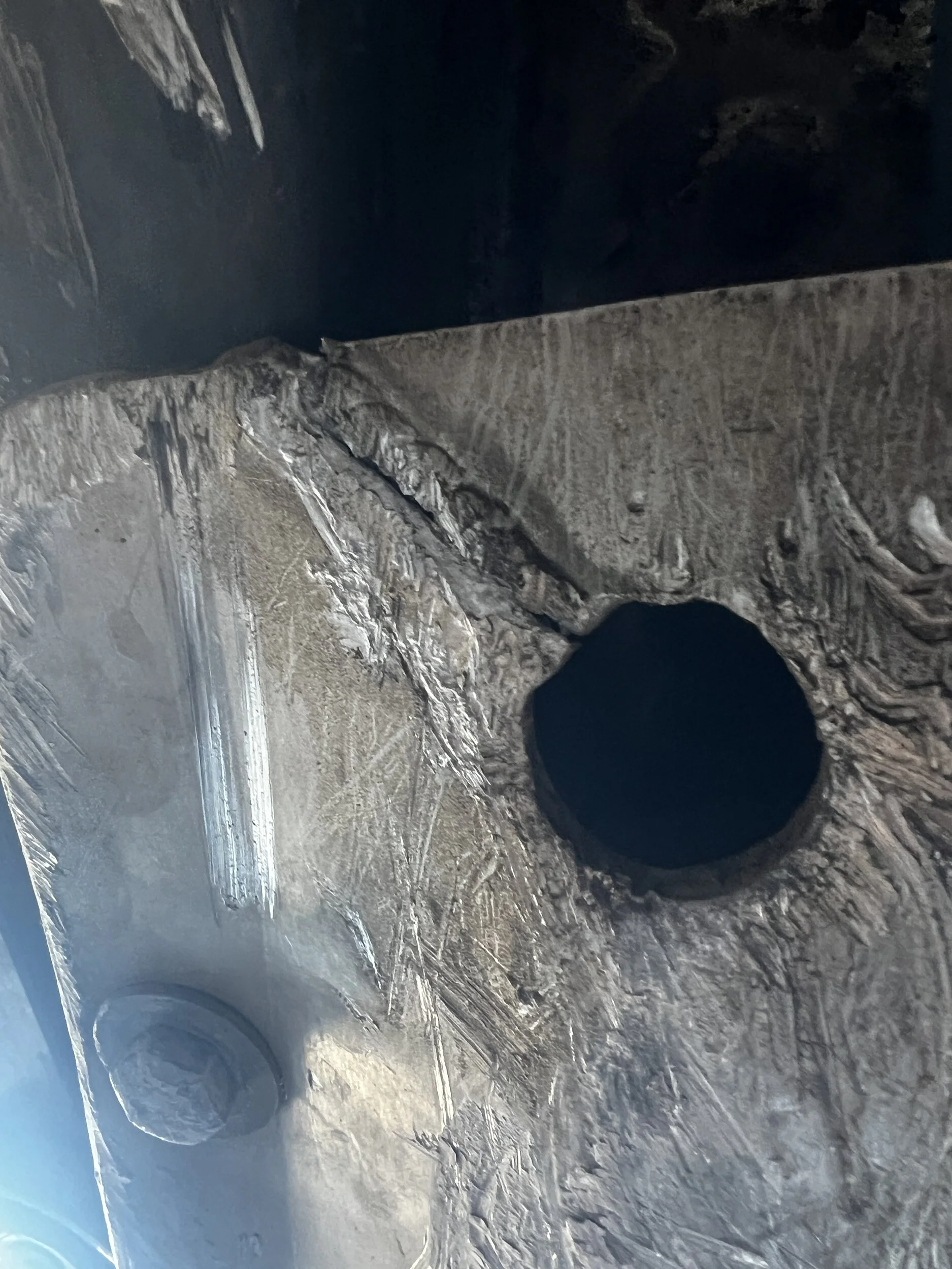

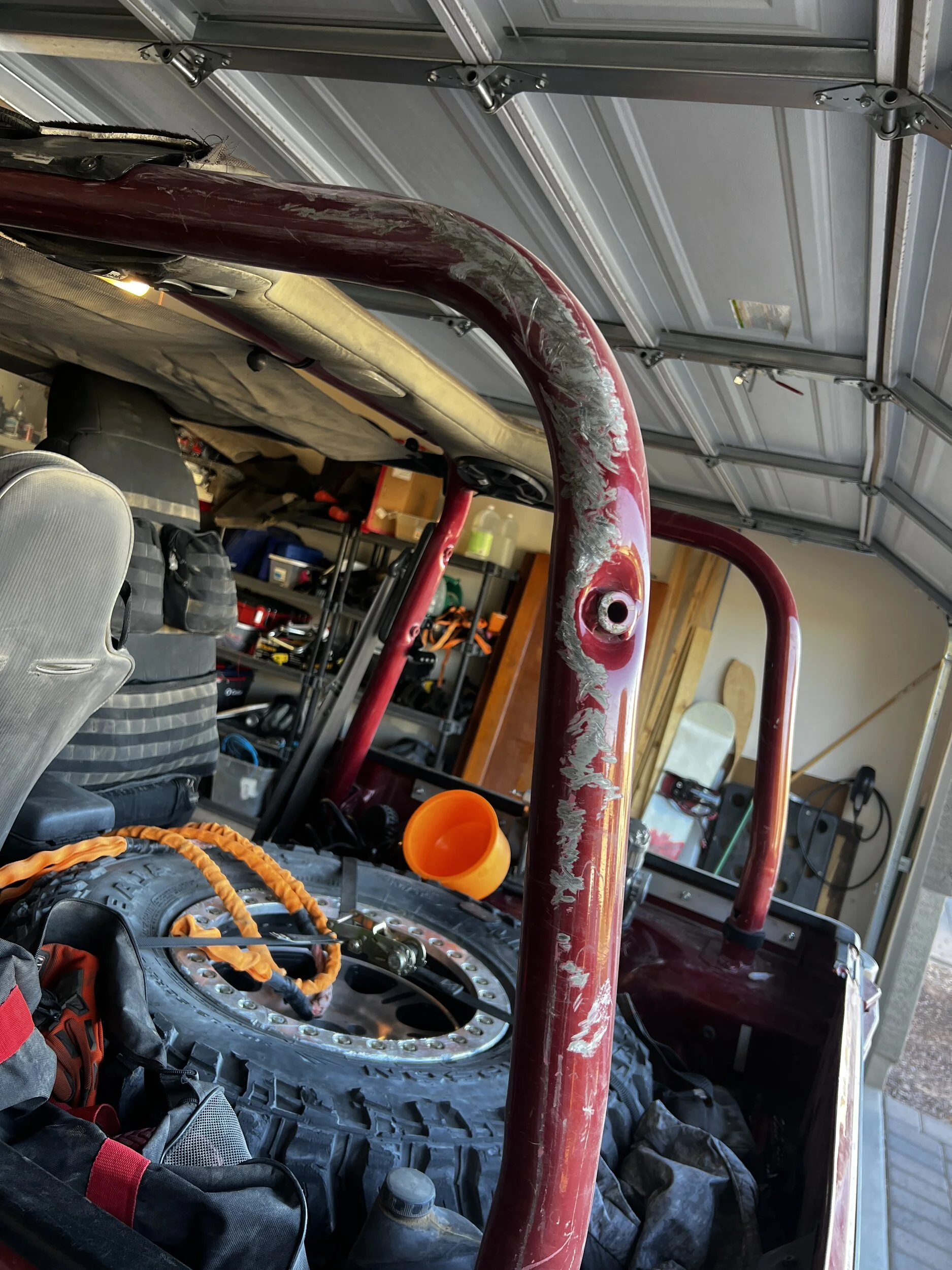

Also spun a frame nutsert for the skid and cracked some welds on the skid

Here is where the boulder bent my brake line into the nipple and sheared it off

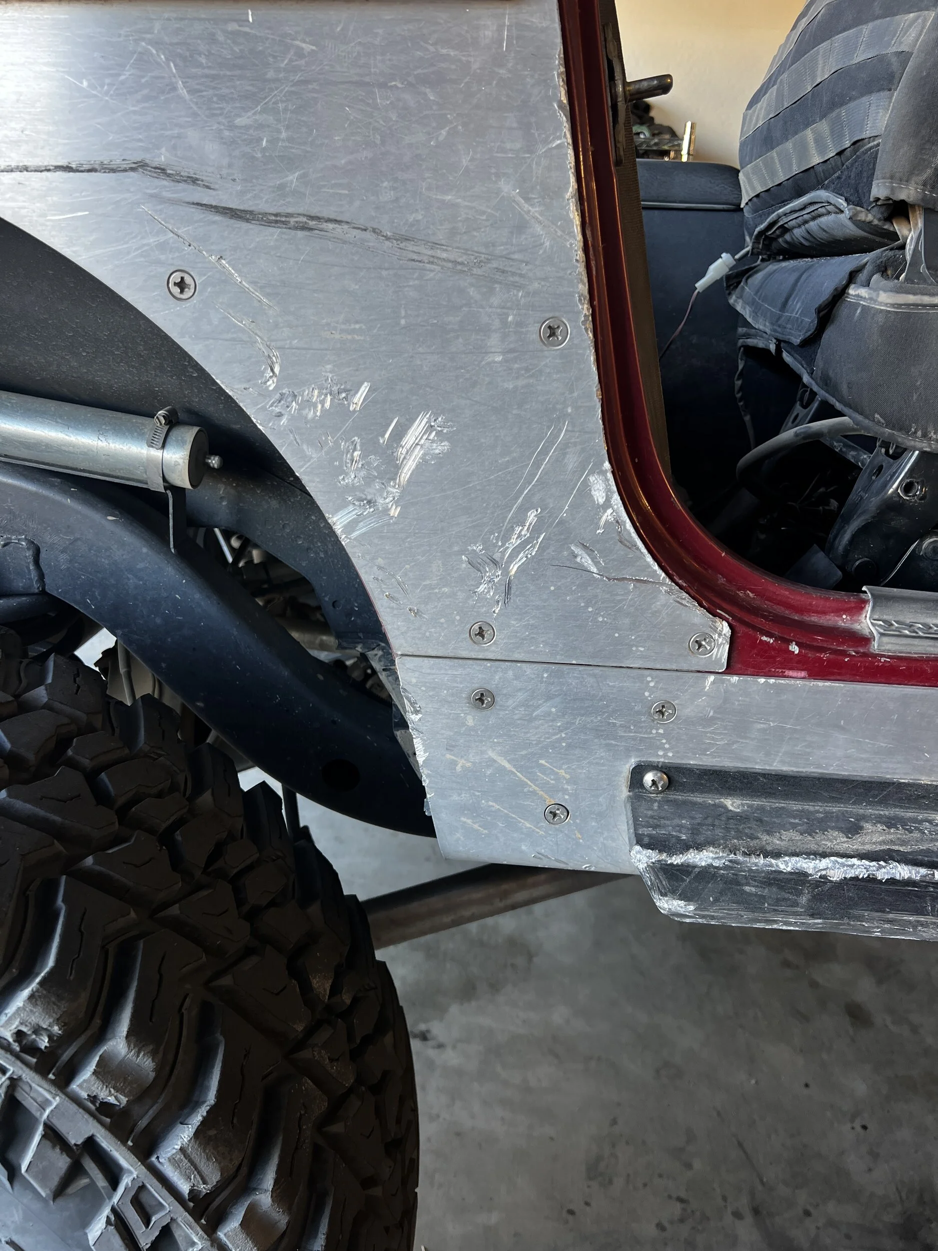

Some more new scratchies

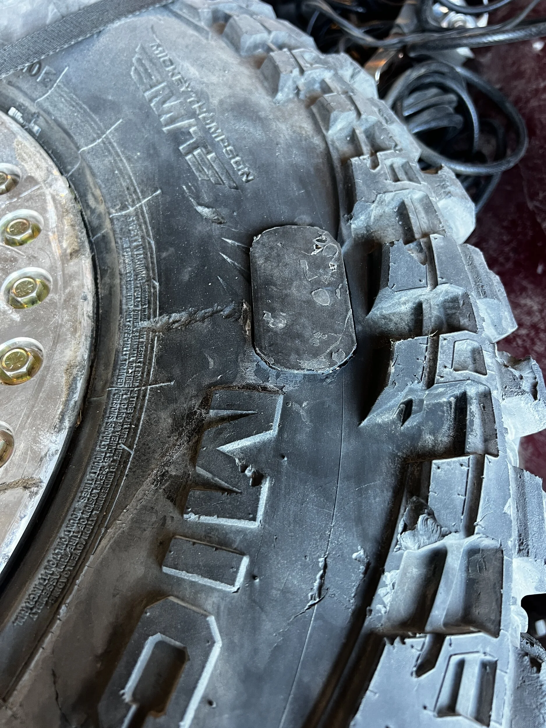

Trying out a glue tread patch on this now spare tire to see if it works

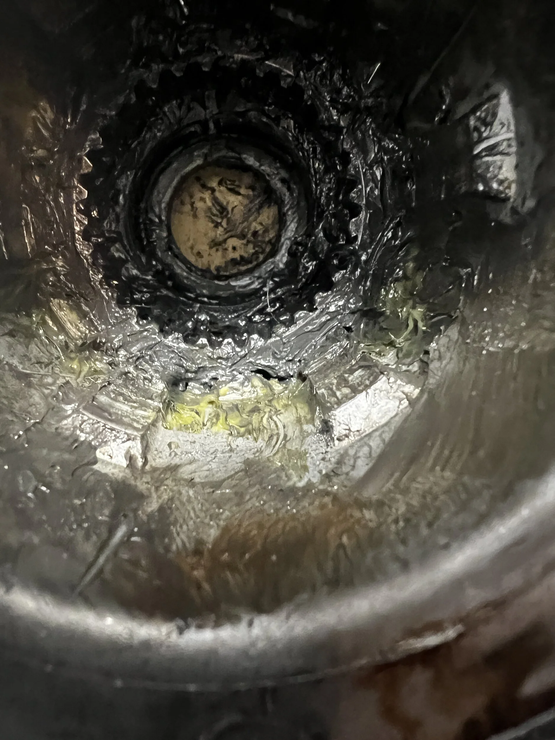

About to dig into the hubs because I need them to unlock before I can drive on the street with this busted u joint. I’m sure I’ll find more damage…
Who still wants to come take a trip to AZ? 🤣
Update on the hubs, putting my spare lockout on fixes the issue. So the problem is in the lockout which was the most likely issue. For some reason the internals in the lockout will not spin when set to free. There’s no visible damage. I guess I’ll have to tear it apart and see
looks like this spline ring twisted in the hub body so it is stuck. I’m assuming that means this hub body is trash now. Can’t believe both sides twisted like that. Luckily I have 2 spares. I just stole the selector off one of the twisted ones to replace the broken selector on my spare that had good internals.
