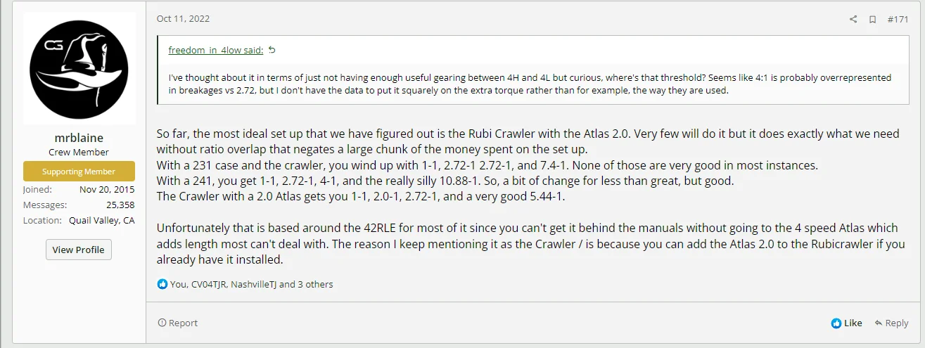

Coolest thing is you can run trails all day long in 2.0:1, hit a technical section and with one very easy pull of the rubicrawler shifter you are in 5.44:1. Just as easy to go back to 2:1 once you are through.
Almost like having an np205 and a granny trans 🤫
I’ve always thought a Rubicrawler in front of an Atlas 2.0:1 would be the perfect setup for a TJ. That would result in a driveline much shorter than stock, and therefore a much longer rear driveshaft (shorter front as well).
But crazy expensive…
I think my rubicrawler setup is too low at ~7.4:1, a 2.0 would help that.

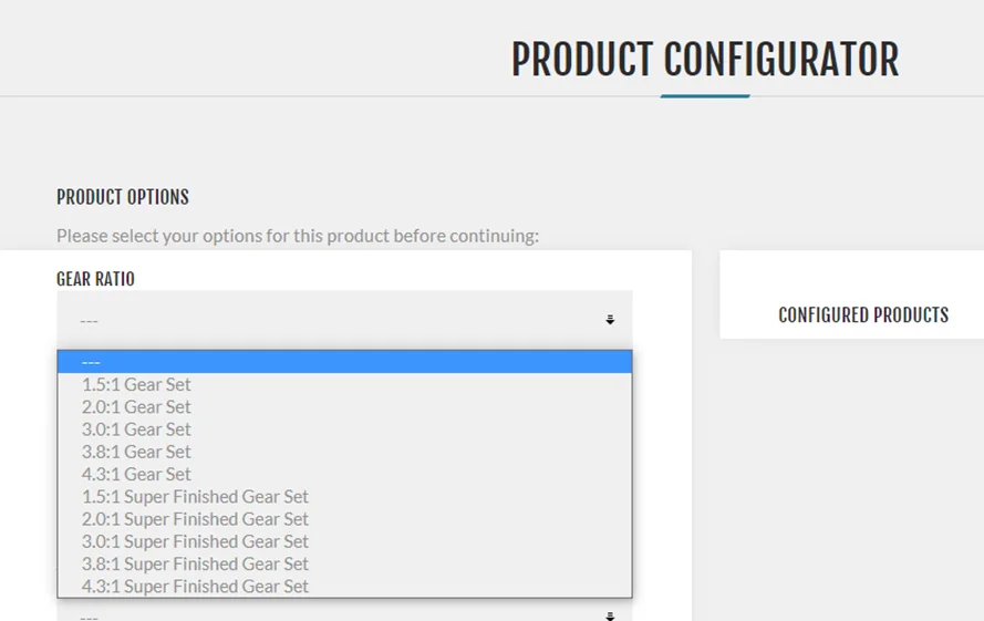

I am only seeing 3.0 as min ratio on atlas 2 speed.

I'd say it depends on what you do with it? Tons of rock crawling and limited trail riding distance, deeper ratio would be fine. I have basically same setup, 4.56 gears, 32rh, 35s. I went with 3.8 ratio on atlas. I've never felt like I've needed a deeper ratio, but where I ride, I do get annoyed having to leave low range to be able to travel faster between obstacles. In 3rd gear low range, I am cruising at 3k rpms around 10mph. For any distance, that gets annoying real quick. I don't regret my choice, and am glad its not any deeper. Again, I feel like how you intend to use it should dictate your ratio choice, not "just because they offer it"
