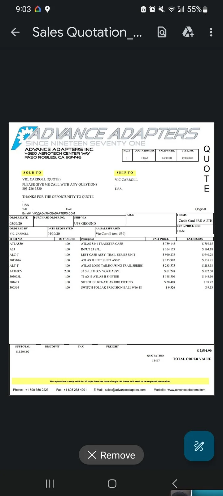

yep. I feel an AA order coming this week.

You are convincing me, not that I needed much. Do you have the trail series with the longer tail housing that holds the stock speedo gear?
edit: also, did you go bigger on your u-joints or stay with 1310?
