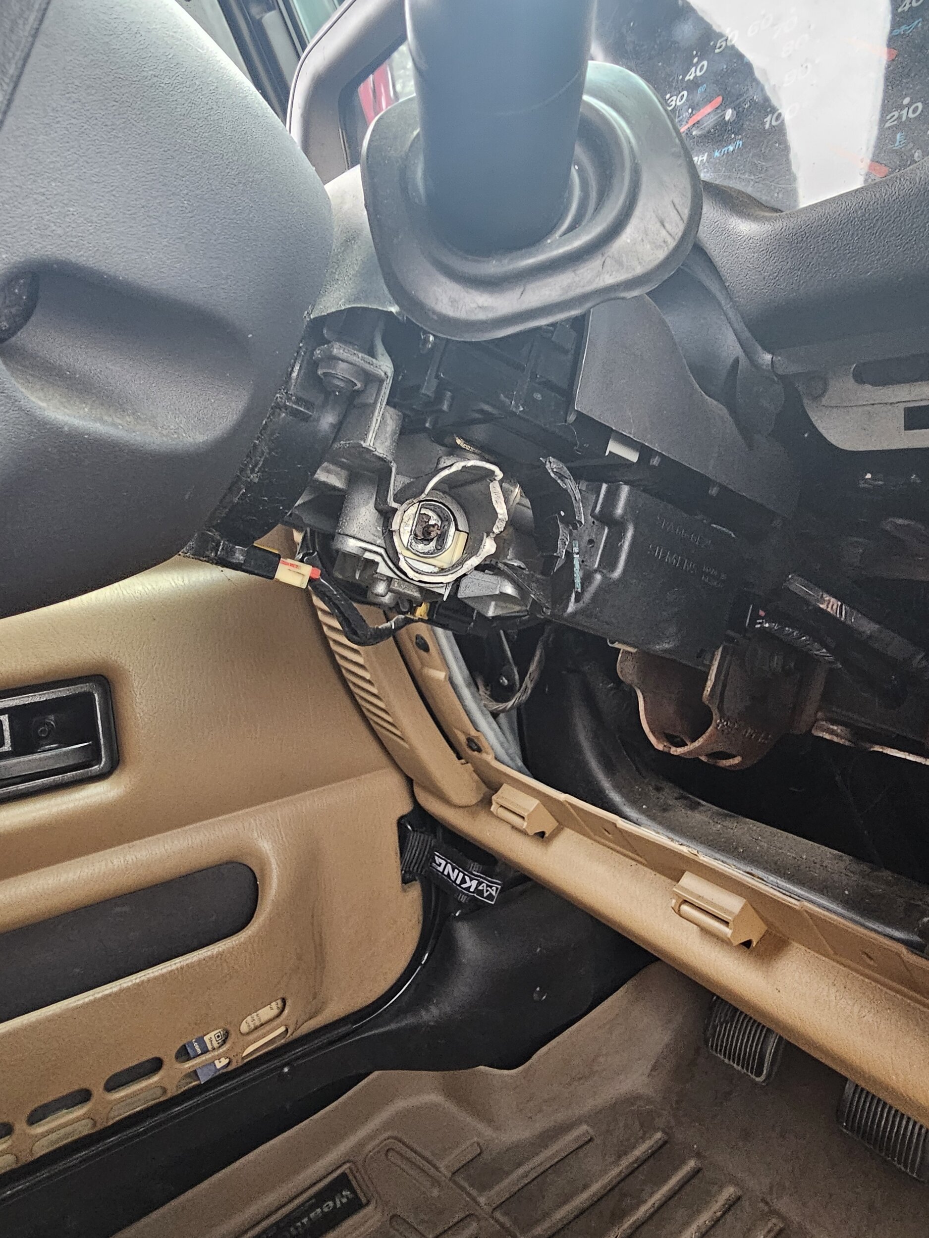

Hey Everyone. Some dregs of society decided to attempt to steal my '01 Sport while I was visiting family. Luckily I had installed the SKIM module when I first bought my TJ s couple years ago (thanks @mrblaine).

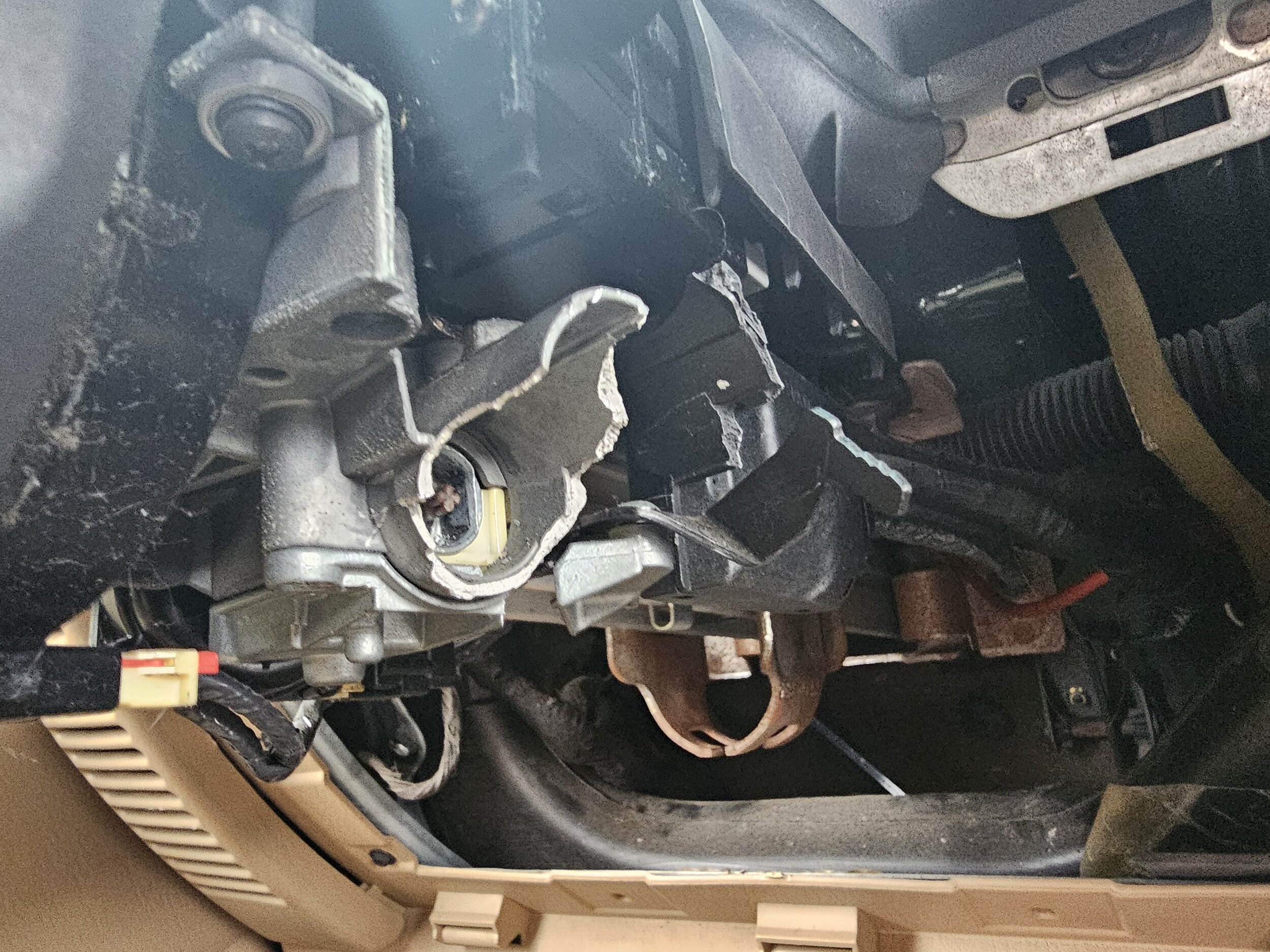

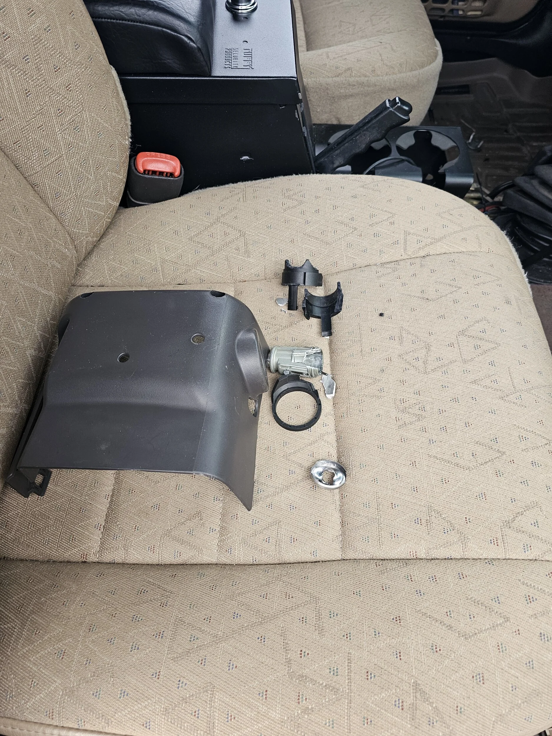

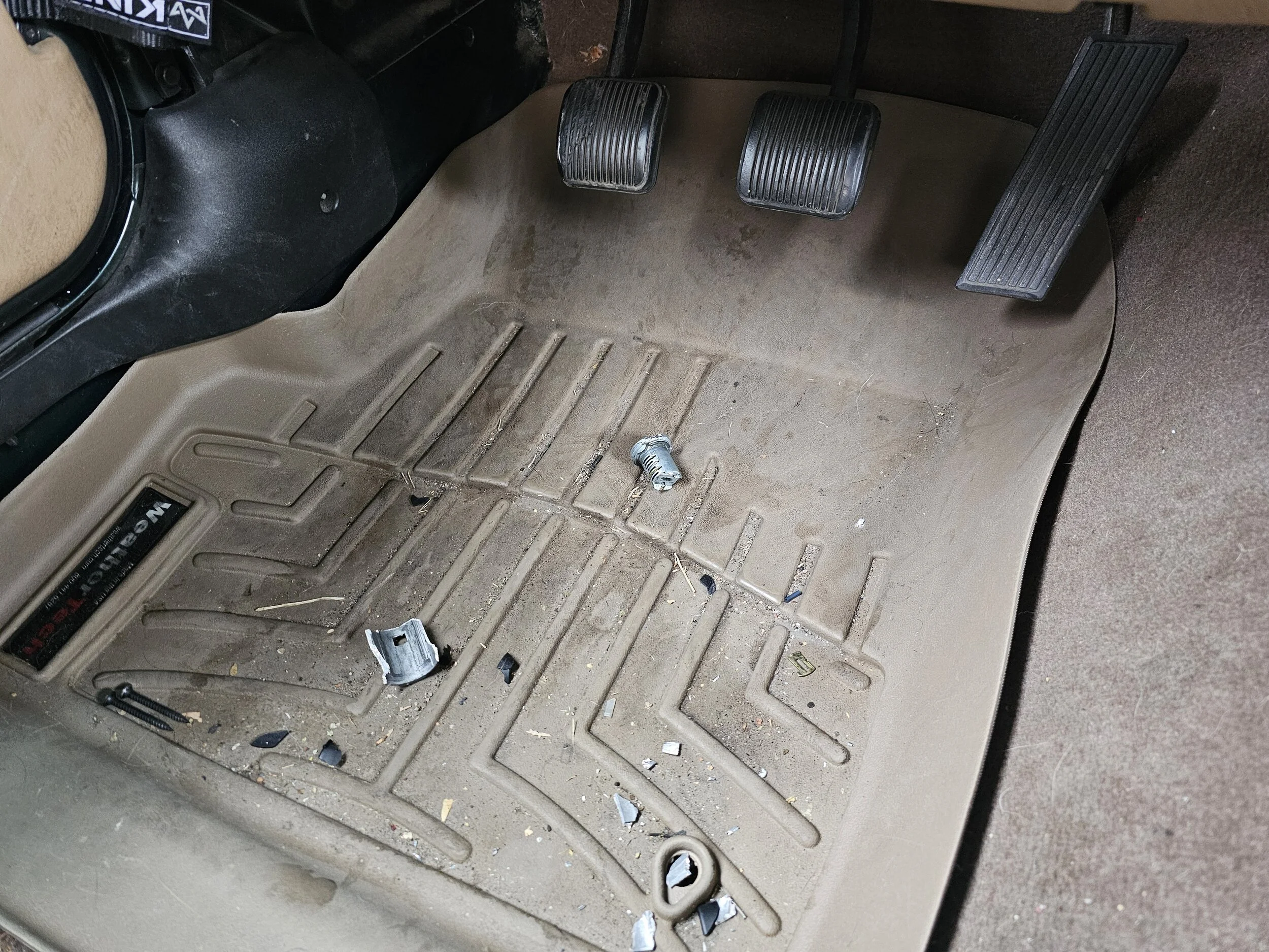

Good new they weren't able to steal my baby cause of the SKIM. Bad news they messed up my steering column pretty bad and destroyed my key tumbler and SKIM module.
I'm planning on ordering a new column soon but I was wondering if anyone could answer the following questions:
I've found some options on eBay with selling keys, skim module, and programmed ECU so no programming would be needed.
Is there any downside to buying a replacement ECU?
Anyone know a place to get a replacement SKIM module? It's been a few years since I got my old one and I'm not having much luck finding one online.
Thanks for any help you can provide.
  • Love
Reactions: Atxbold
No, repair isn't possible as it's in pieces. For a new module, I've been able to find some possibilities on eBay but haven't purchased anything yet.
As of now, they are not able to be reprogrammed to a new VIN. That can only be done to a new one.
