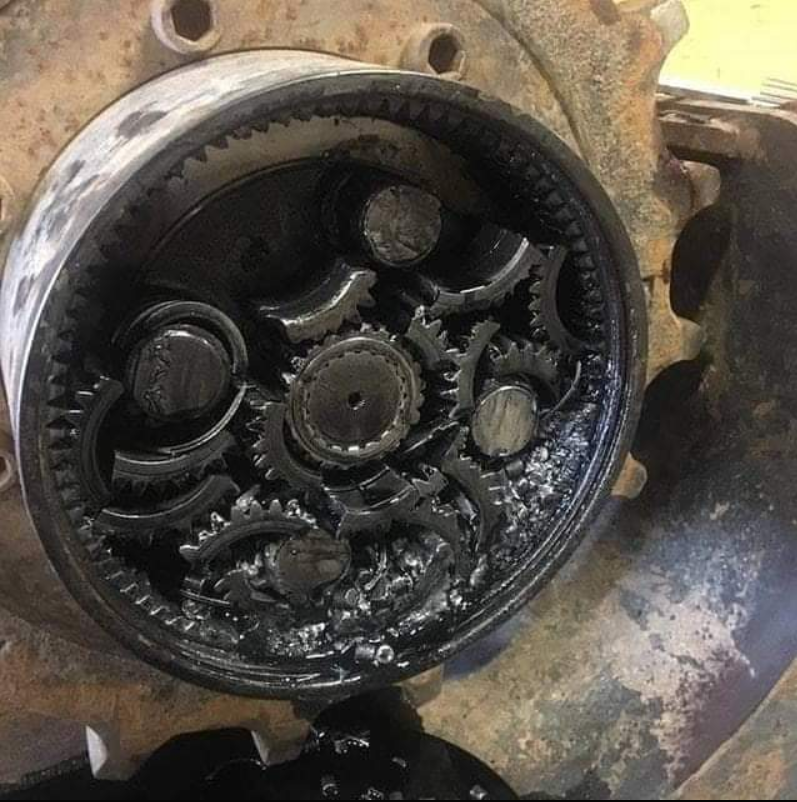

Dammit, I told you that the cross section was too thin on the planet gears and you needed to increase that or decrease the axle diameter.
WOWWWWWWWW!! For a gearbox nerd this is like a beautiful work of art. Is this on a some sort of excavator? Something you own? I'd have to speculate dynamic jam to just explode the planets like that. I mean WOW. DId i say WOW!? Whats super interesting is the planets blew up while the carrier pins help strong.
No idea what it is. Venturing a guess that it is the drive gear on a bulldozer track.
