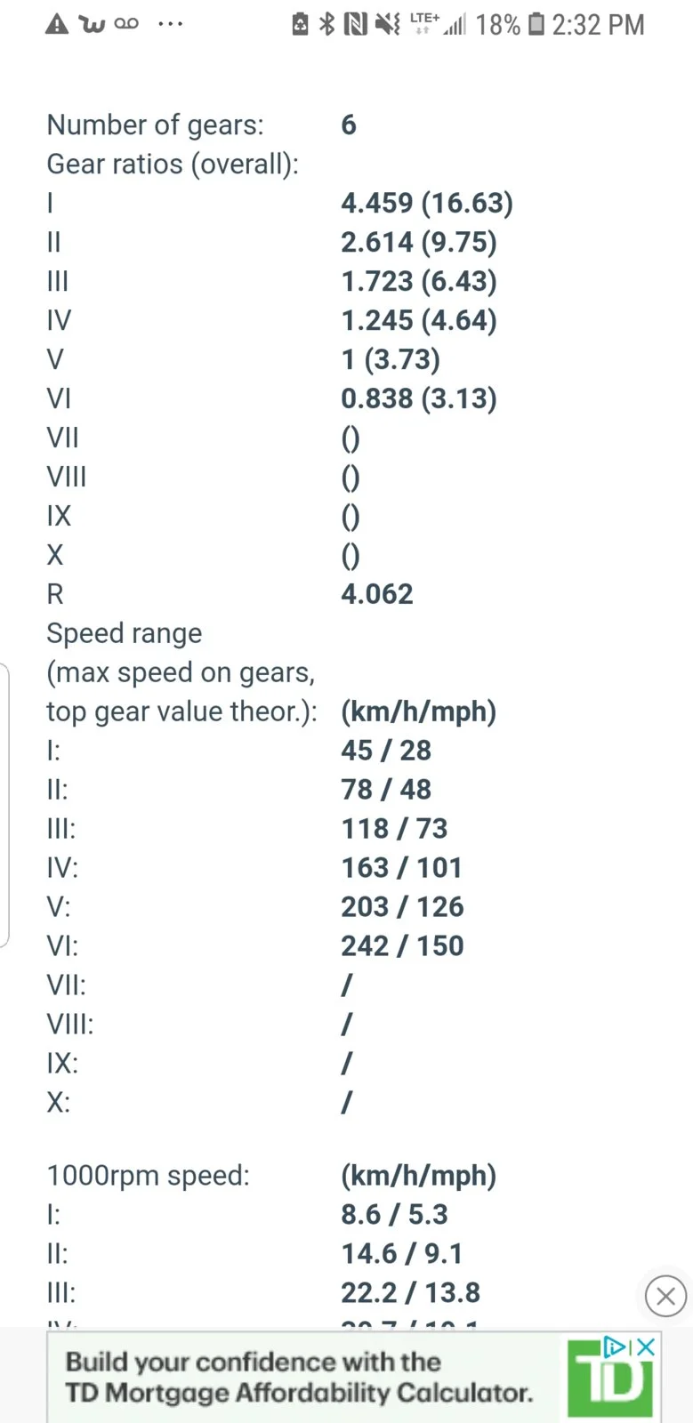

I'll have to look into the 02 sensors just kinda sucks that I'm on a trip right now and all my tools are at home. My gears are stock this is what I looked up for my model.
Your tank is 73.8l
You had about 3.8l remaining in the tank when you filled it.
You were getting 9.8 mpg (24 l/100km) if your mileage numbers were correct which is a bit low.
If you haven't calibrated your speedometer/odometer for the larger tires you are really getting 11.4mpg (20 l/100km) which isn't bad for 35" tires.
km/ltrsX2.83=mpg (imperial).
I have gotten 28mpg on the 4 banger straight hwy on summer gas taking it easy 90kmh/55mph. That would be about 23.3mpg US gallons for our friends south of the 49th. I doubt you could get much better in a TJ brick.
