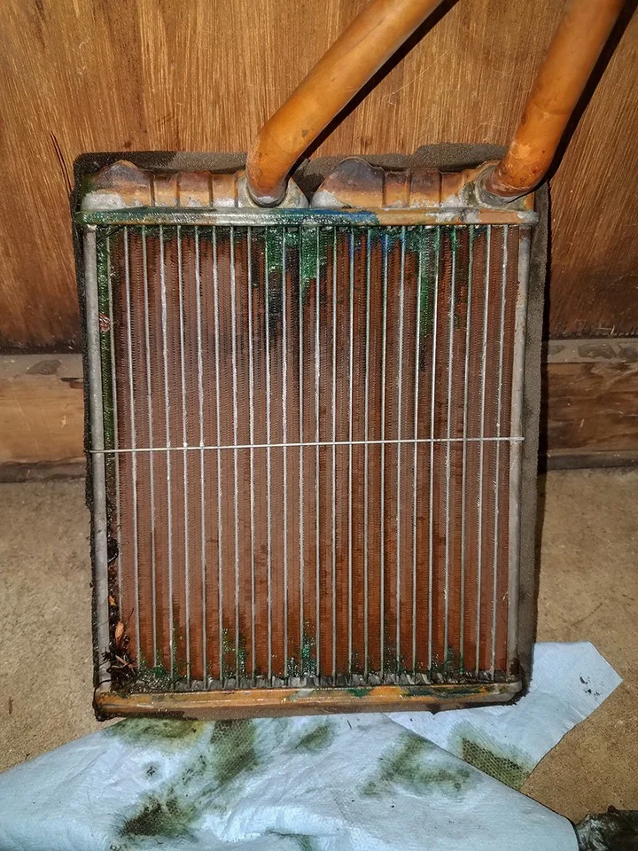

Yep heater-core, exact symptoms mine was having. Pic of old one.
