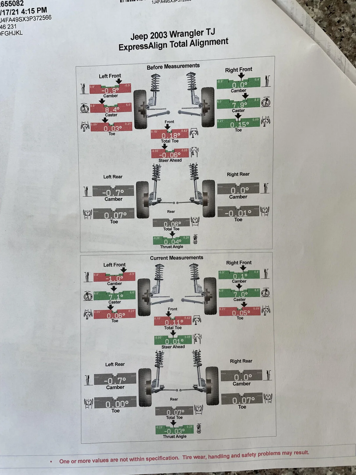

Just installed the Currie steering and got my alignment specs back. I'm concerned about the camber on the driver side as it is out of spec. When driving, it feels like when the driver side hits a bump, the steering wheel shakes more than the passenger side. Anyone ever notice that before?
