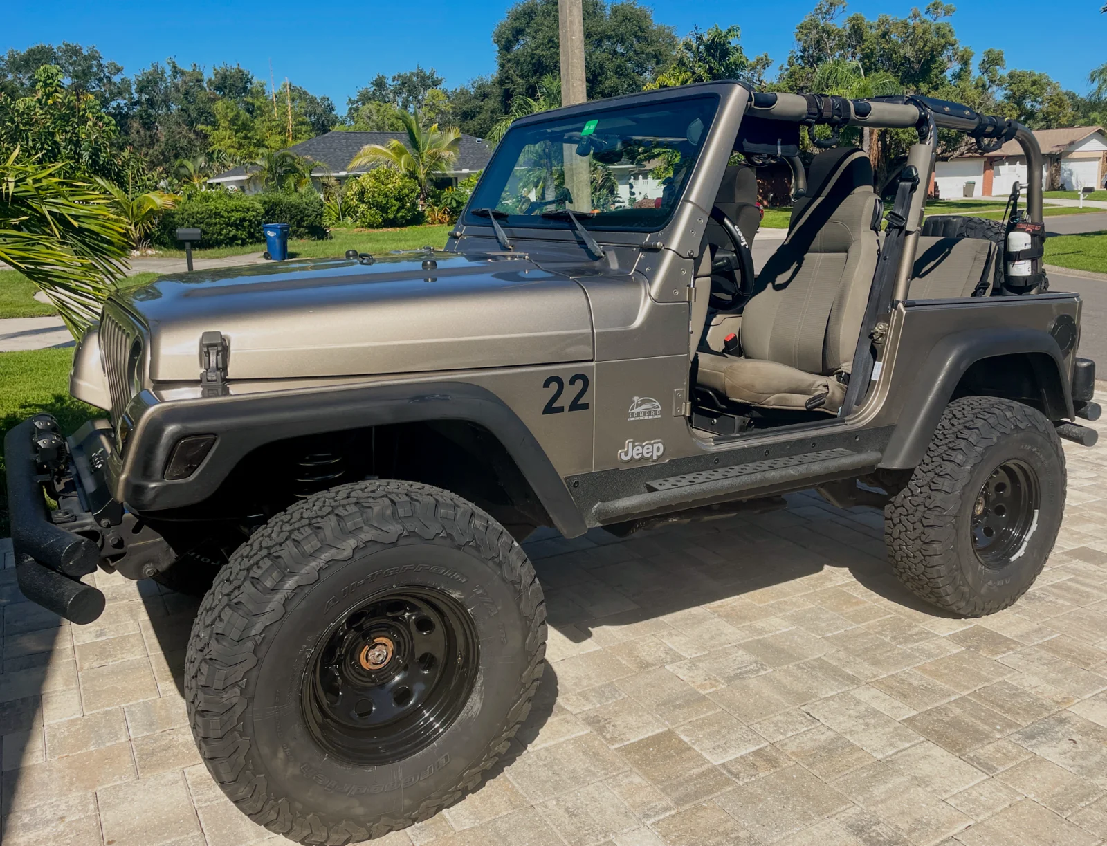

QQ, I'm sure it is elsewhere in these forums, BUT it has a really hard time shifting into 4 high, then won't go into 4 low, it just pops right out. I know it has something to do with the linkage, but what? And it did the before the lift as well.
I love where this ended up!
2.5" Suspension lift and new 33" KO2s did the trick!
The lift should have included a drop bracket for the transfer case linkage or you could change to a cable shifter which is the preferred way to go.
The fit & finish of your rig is amazing! 33s are perfect imo.
How do you like your under-seat storage box?
I apologize for rudely pointing out something I hate, but it's bs they put the wheel weights on the outside (where they are seen and can get knocked off). I had Discount Tire move the weights to the inside when they did that bs on my old dually.
Thanks, a cable shifter, from what I've read/seen is the way to go. I'm pretty confident I could install it myself, but still a little nervous dealing with any of the transmission pieces. It's my daily driver and can't risk making it undriveable. lol
