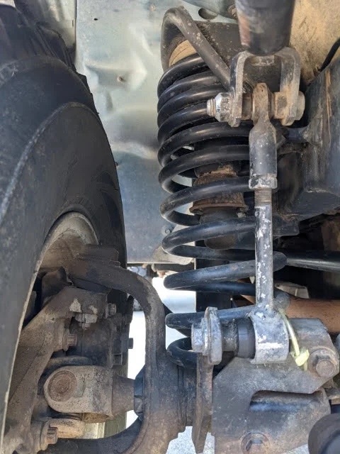

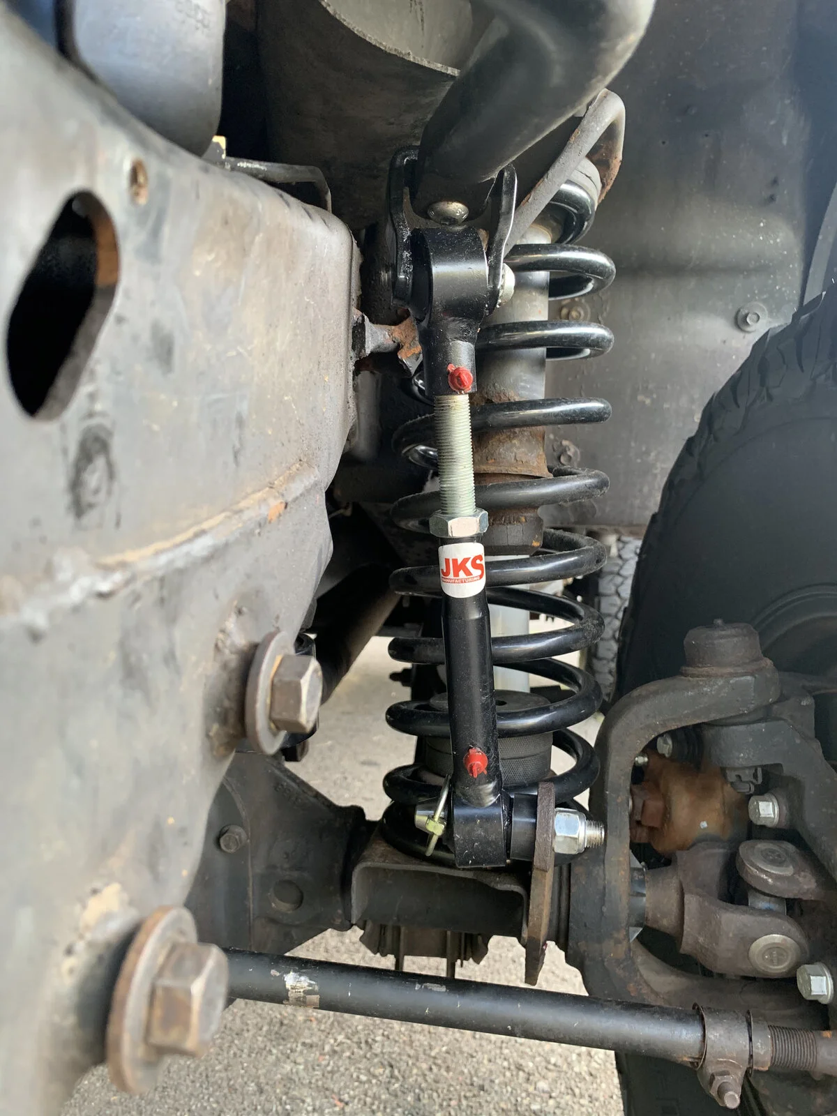

I have trouble disconnecting my passenger side away bar links, the link makes contact with the steering stabilizer bracket and I have to tap it out. Does it look bent? If so, is heating it with mapp gas and hitting it with a bfh a few times a good way to fix it?
I noticed it when I was installing my disconnects so the pin itself can’t be what’s bent
If you want to bend it I'd use a crescent wrench and just bend it. You'll have much better control than with a hammer. The steel is pretty weak. No clue if it needs it but they aren't high precision, I wouldn't worry too much.

Interesting, I could try that. It wouldn’t be at too much of an outward angle that way?
Those pins would interfere with stock wheels if they faced outward. Anybody can easily see by looking at the swaybar that they are supposed to go inward, just take two seconds and check yourself. The link would have to have a ridiculous bend to be even close to fitting. Just bend the bracket a bit if you need space.

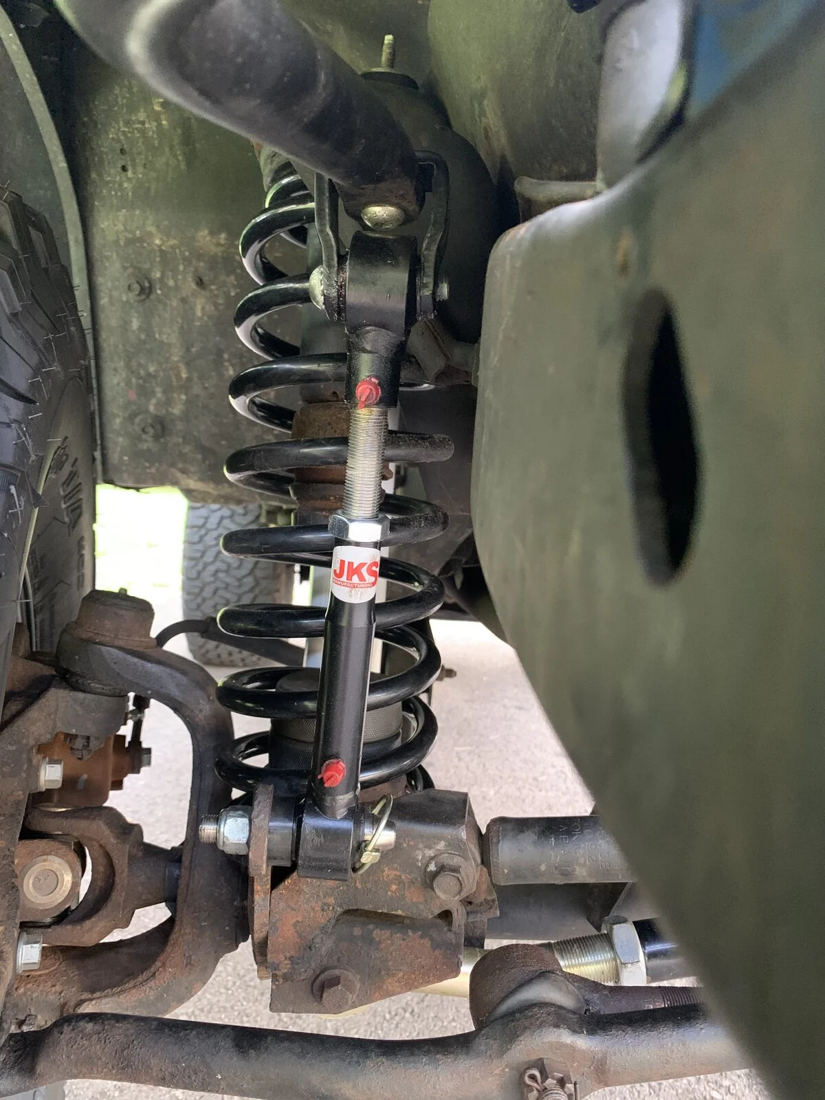

Your photos didn't show enough of the antiswaybar's position relative to the link to know that but it certainly wouldn't hurt to try it... reversing it would take all of a minute. It worked ok on my previous TJ.
@pagrey way to go! You forced me to get up off my lazy but and go look. You do have it mounted the correct direction. My memory must be backwards today. 🤪

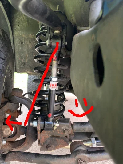

Mine are already at a bit of an angle with them going inboard, having them outboard seems like it would be pushing it too far
View attachment 261807View attachment 261808
Based on those photos I wouldn't reverse the stud either. I probably didn't remember mine correctly, it has after all been over 20 years since I last had discos that used a stud like that.
