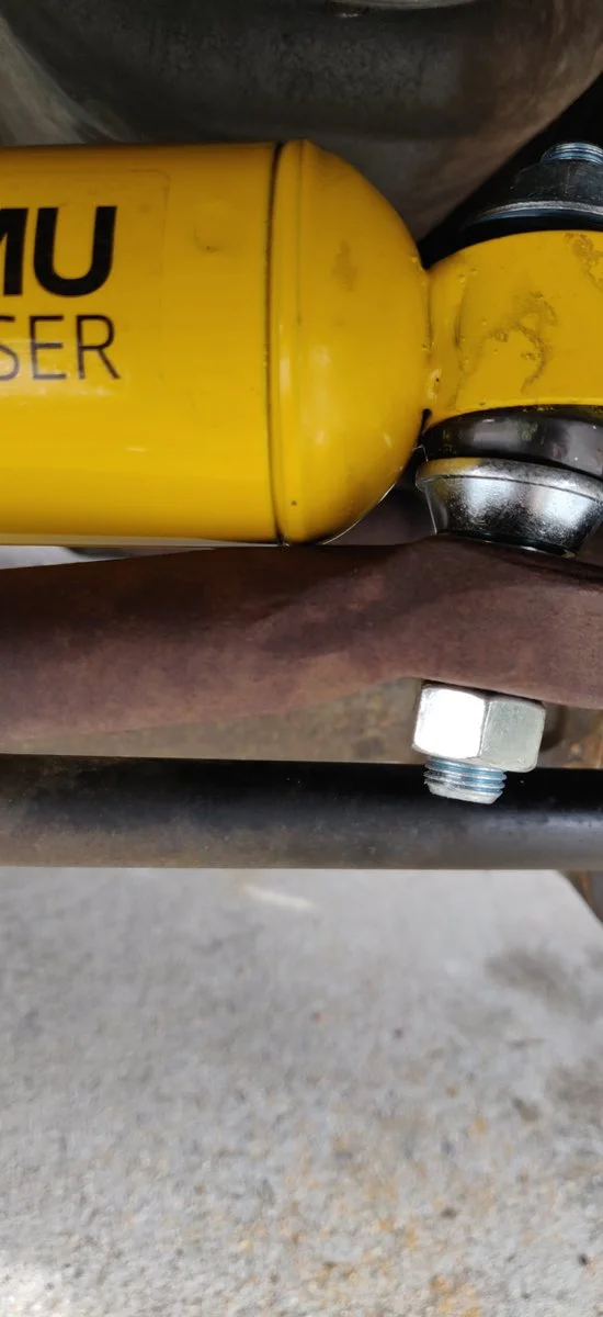

Lopenator New Member Joined Jun 23, 2019 Messages 22 Location Ny Dec 21, 2019 #22 This same thing is happening to me. Is this an issue?

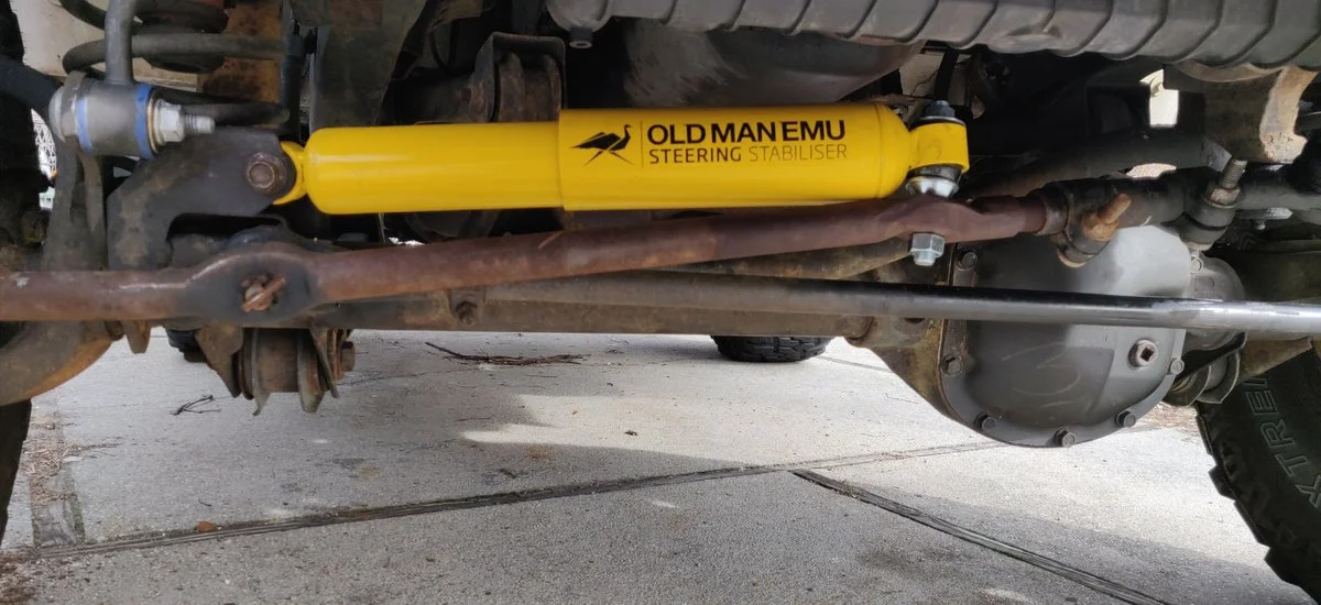

Chris Administrator Staff Member Ride of the Month Winner Joined Sep 28, 2015 Messages 79,542 Location Gillette, WY Dec 21, 2019 #23 Lopenator said: This same thing is happening to me. Is this an issue? View attachment 130365 Click to expand... Can we see a distance show to see how you have the stabilizer installed?
Lopenator New Member Joined Jun 23, 2019 Messages 22 Location Ny Dec 21, 2019 #24 Certainly. How's this?
Pcleaners2 TJ Enthusiast Original poster Joined Jun 23, 2017 Messages 494 Location Pacifica, CA, United States Dec 21, 2019 #25 Use the energy 5/8” bushing They come in packs of two Amazon. Ran it for two years already . Doesn’t squish
Lopenator New Member Joined Jun 23, 2019 Messages 22 Location Ny Dec 22, 2019 #26 I just ordered. Thank you.
