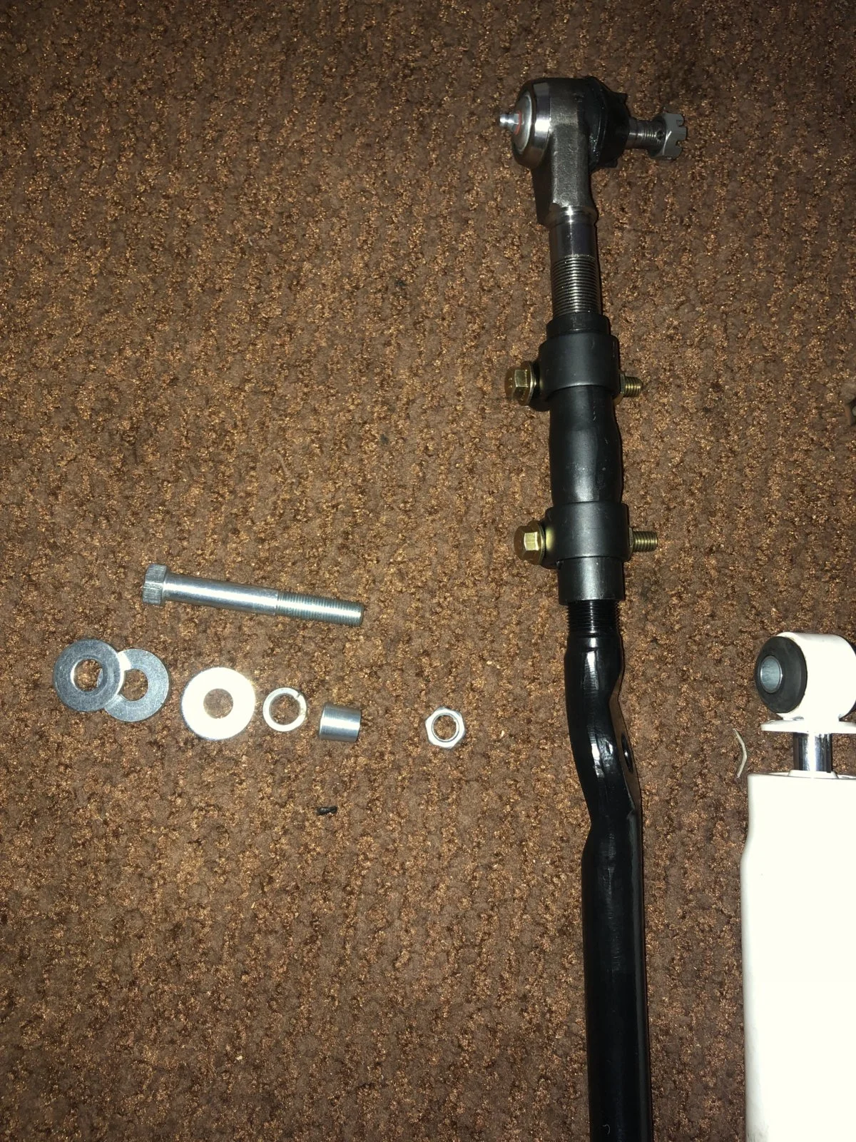

Hello
I have a question regarding installing a steering stabilizer for my 2003 TJ. I bought the crown steering HD kit and I wasnt to sure how to properly use the hardware to attach to the stabilizer to the drag link . If you installed one before let me know how to do it properly . Thanks

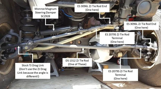

???? the mounting points are fixed at the frame and on the shaft and so will mount in the correct location regardless of the wheel position.
The Monroe Damper I bought came with exact replacement parts. But Crown's site has this pic in their instructions

I just did mine in this order. Put a large washer against the head of the bolt. Put the bolt through the bar (looks like a spacer was included in case the hole in the bar is too large?) then another washer against the bar. Push the bolt through the dampener, then a washer, lock washer and nut. Tighten everything down And your done.
