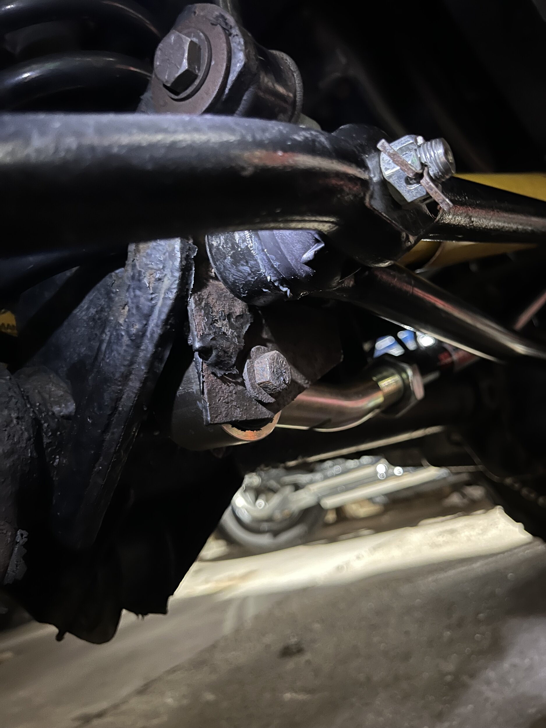

New drag link hitting steering stabilizer bracket
Pic of the bracket is with tires turned to full right on flat ground.

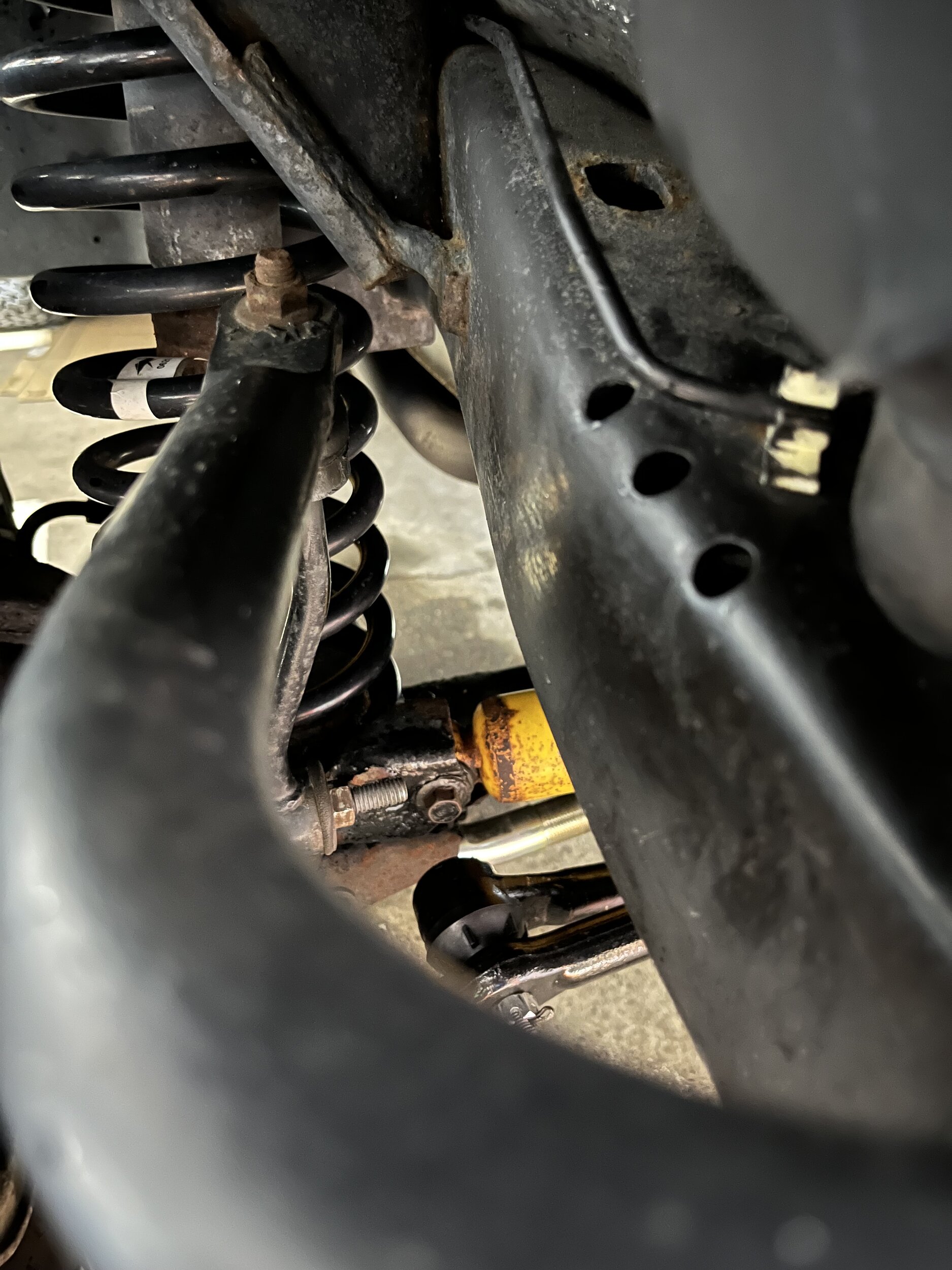

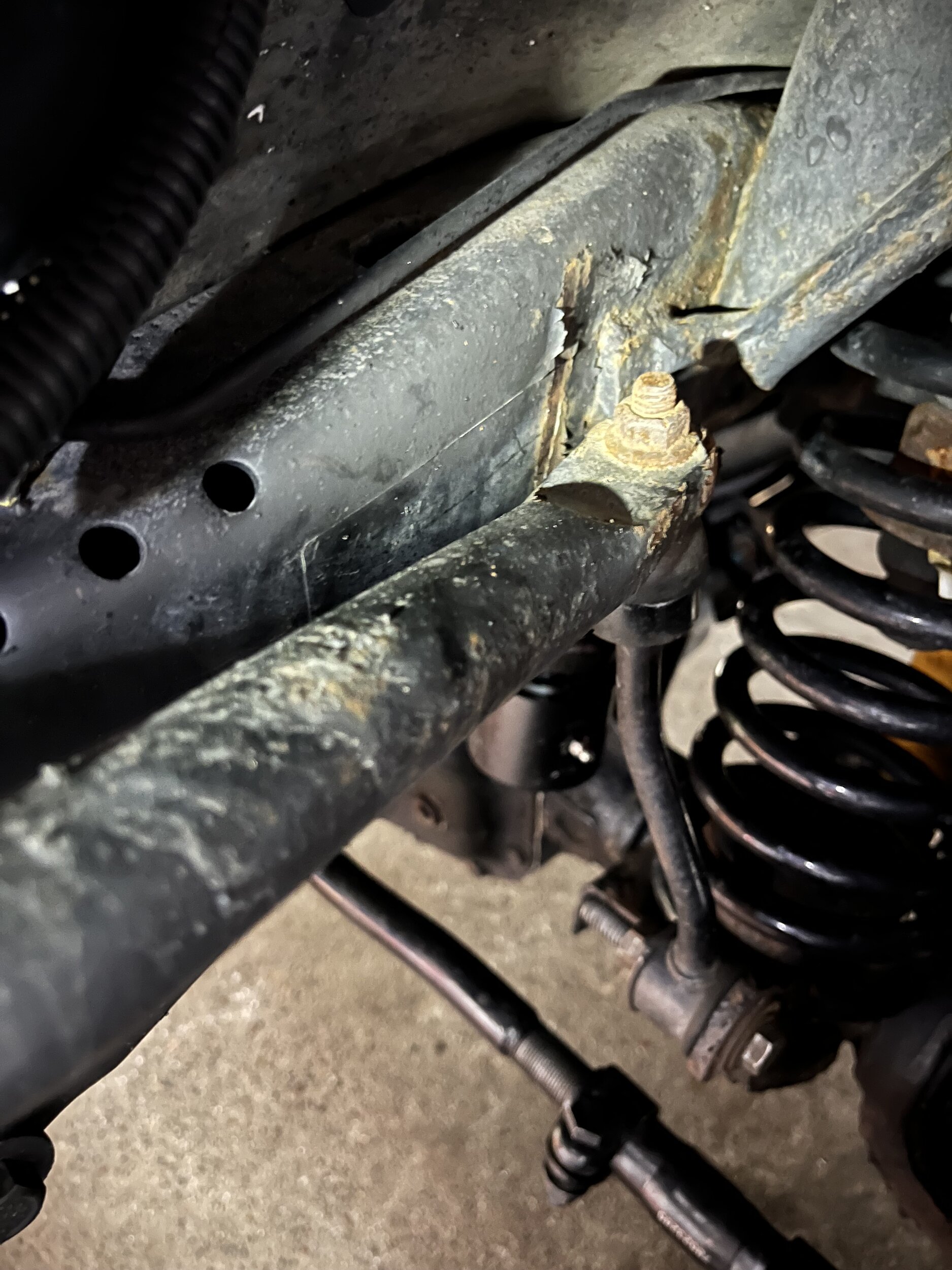

Pics of sway bar is with tires strait. The sway bar hitting the frame is why I replaced the track bar and track bar bushings. Now the axle is centered but sway bar is still closer to the frame on the driver side.
How to rule out bent sway bar?
View attachment 550219View attachment 550220View attachment 550221Pic of the bracket is with tires turned to full right on flat ground.
If you're sure the axle is centered and the sway bar isn't, then slide it over so it is.
If it doesn't stay there, replace bushings and/or add a collar to hold it there.

Interesting. I’ve got a press and the previous drag link. It’s looks to be the back of the tie rod ball joint that’s hitting. Where would you bend drag link? Is the goal to push where the tie rod connects further towards the front? Would one bend at the that point be better or multiple bends at different points be better?
i just replaced the front bushings with some from autozone and it slid back over. Might have to get a collar. These new bushings squeak at every bump though. Made the Jeep sound like a shitty trailer.
Just enough bend to get the clearance you need.

The draglink has a bend, bend it some more and be done with this mess.

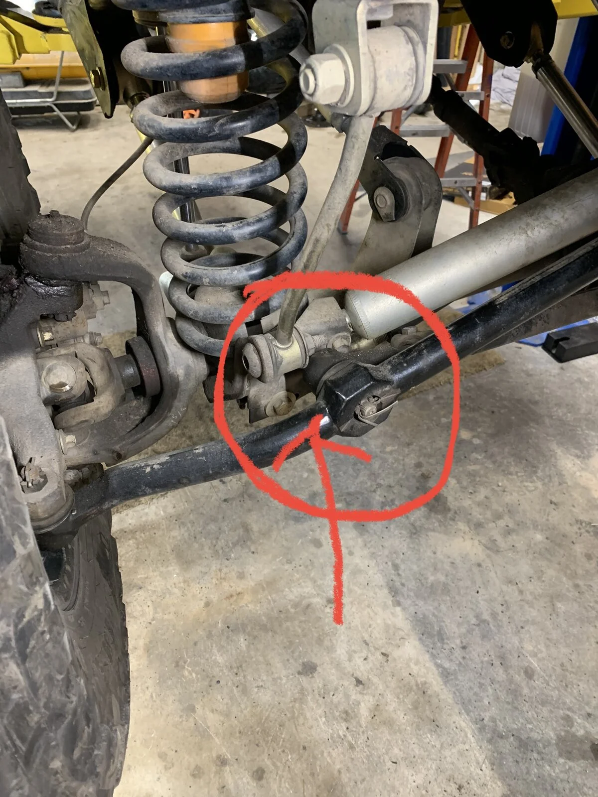

Got the drag link off and bent it using a 20T press. Just unthreaded it from the steering link. Measured from the ball joint to end of the adjustable sleeve. It’s now 1/4” shorter in length. It’s hard to measure the depth of the bend compared to the previous one but the bend is now roughly 1/2” deeper.
Think that’s enough extra depth? It was hitting without the grease fitting in the back.
Should I try to put a new grease fitting in after or should I try to find a set screw or something to fill the hole? Idk if the grease gun end will fit in there without separating the ball joint.
Has anyone ever relocated a grease fitting? If so is it worth doing vs removing the ball joint to grease?
Put it back together and turn the steering wheel. If its still hitting, put more bend in.
Yeah, still hit once back together. I think it’s clearing the bracket now but hitting the sway bar link bracket that’s attached to the track bar bracket. Sway bar link bracket sticks out past the front of the track bar bracket an estimated 1/4”.
I also heard a contact noise on the driver side and I’m pretty sure it’s the sway bar hitting the frame. I’ll have to get the sway bar locks.

I centered and installed collars on the front sway bar tonight. The sway bar was moving a solid .5” after driving around the black once. Sway bar was still in place after Collars were installed. so that’s a good thing but still didn’t solve the main concern. Might make a video tomorrow and have yall hear it.
