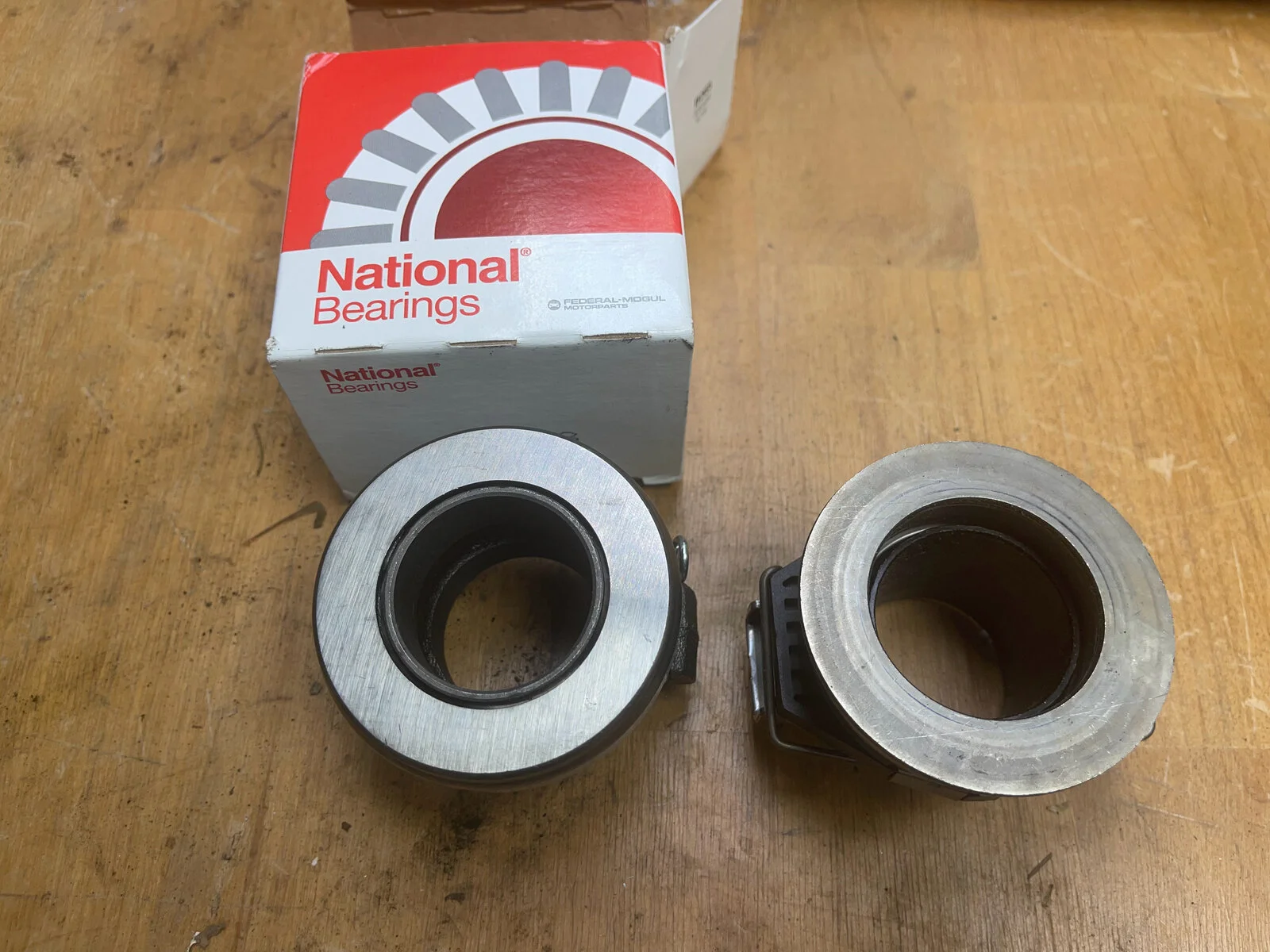

I just got the Luk set and opted for the national because I have had good luck with national bearings in the past.

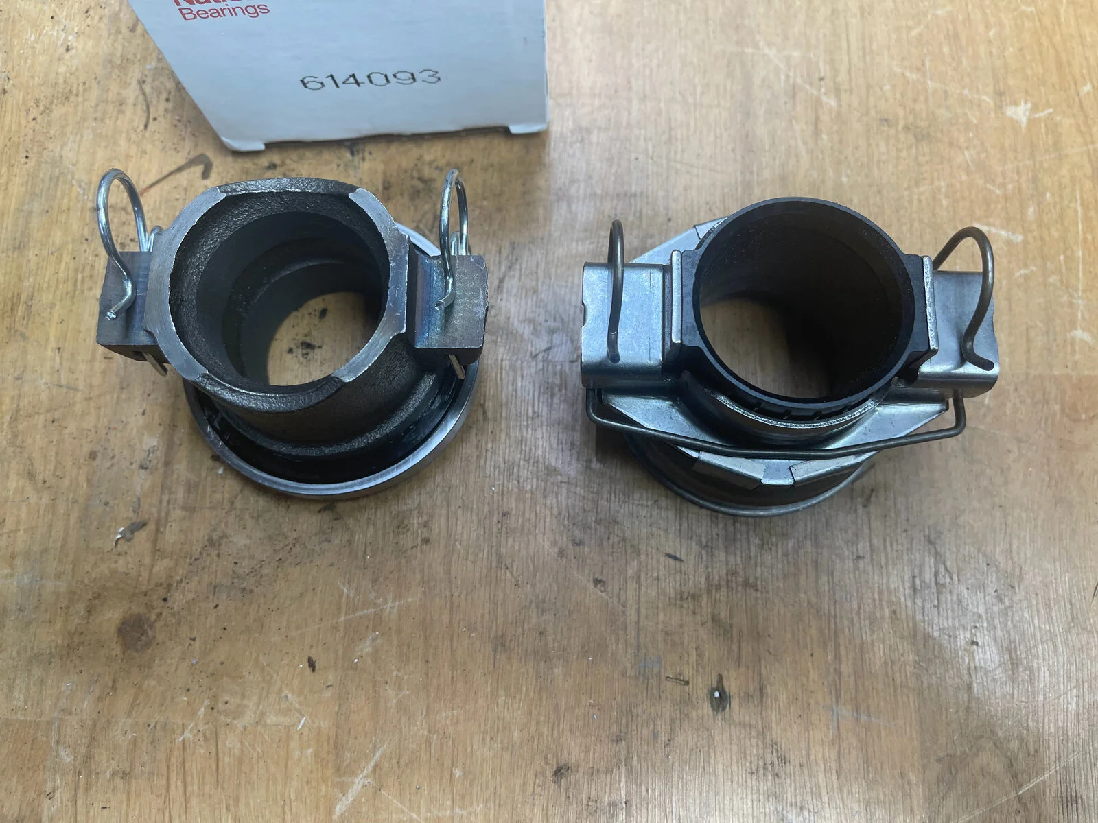

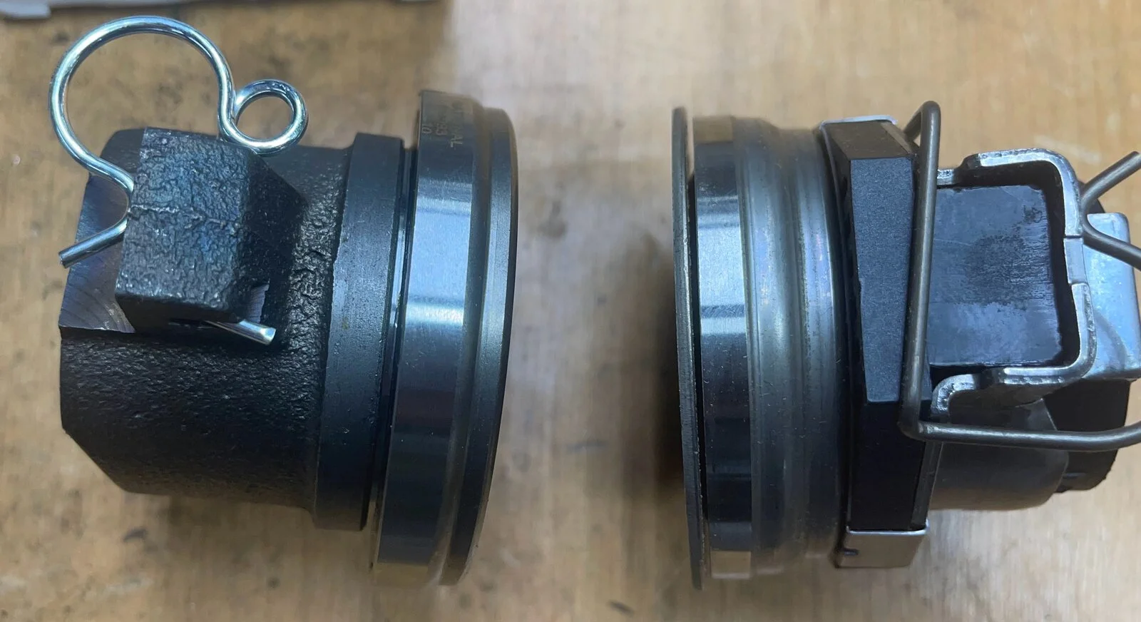

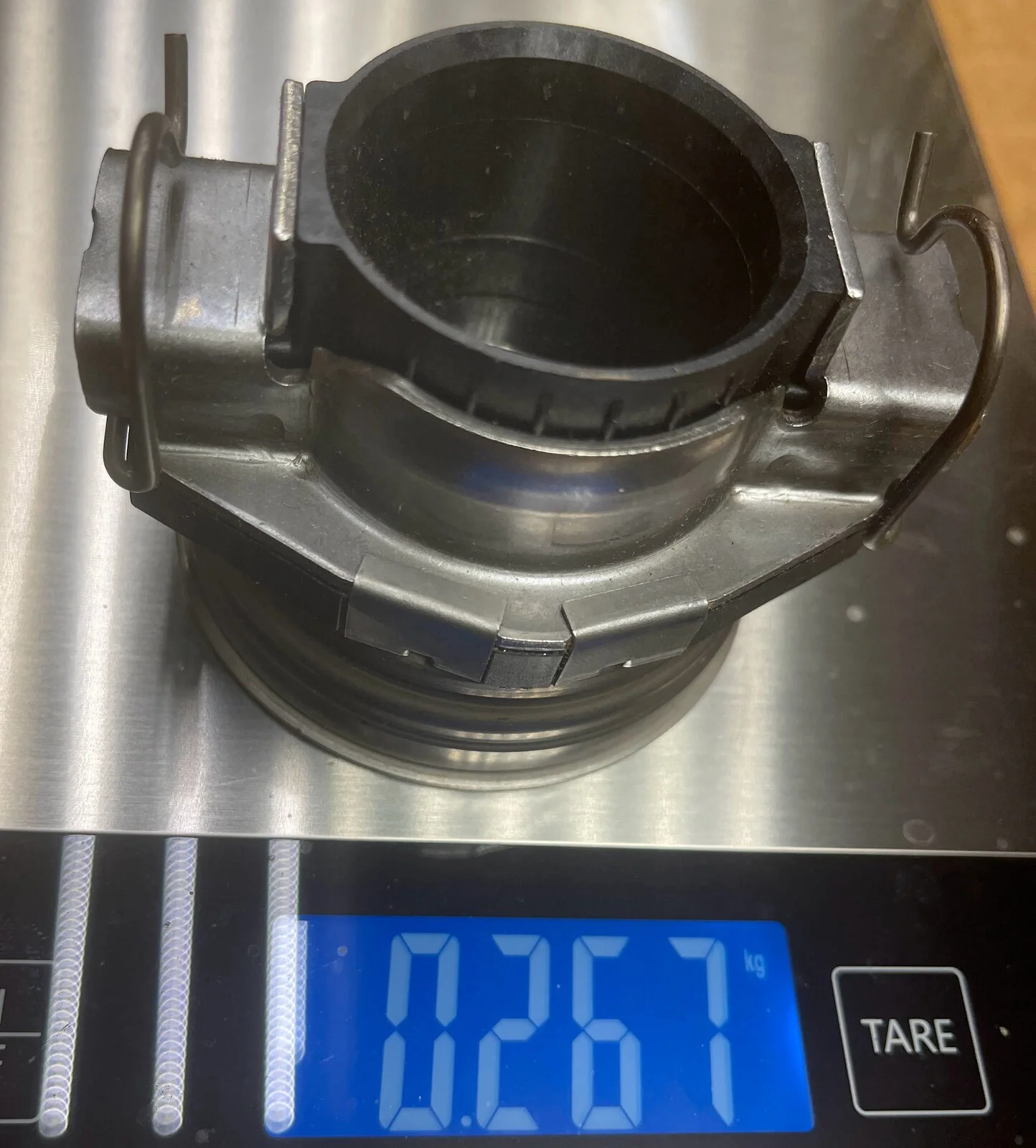

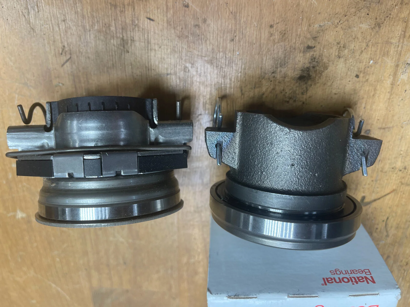

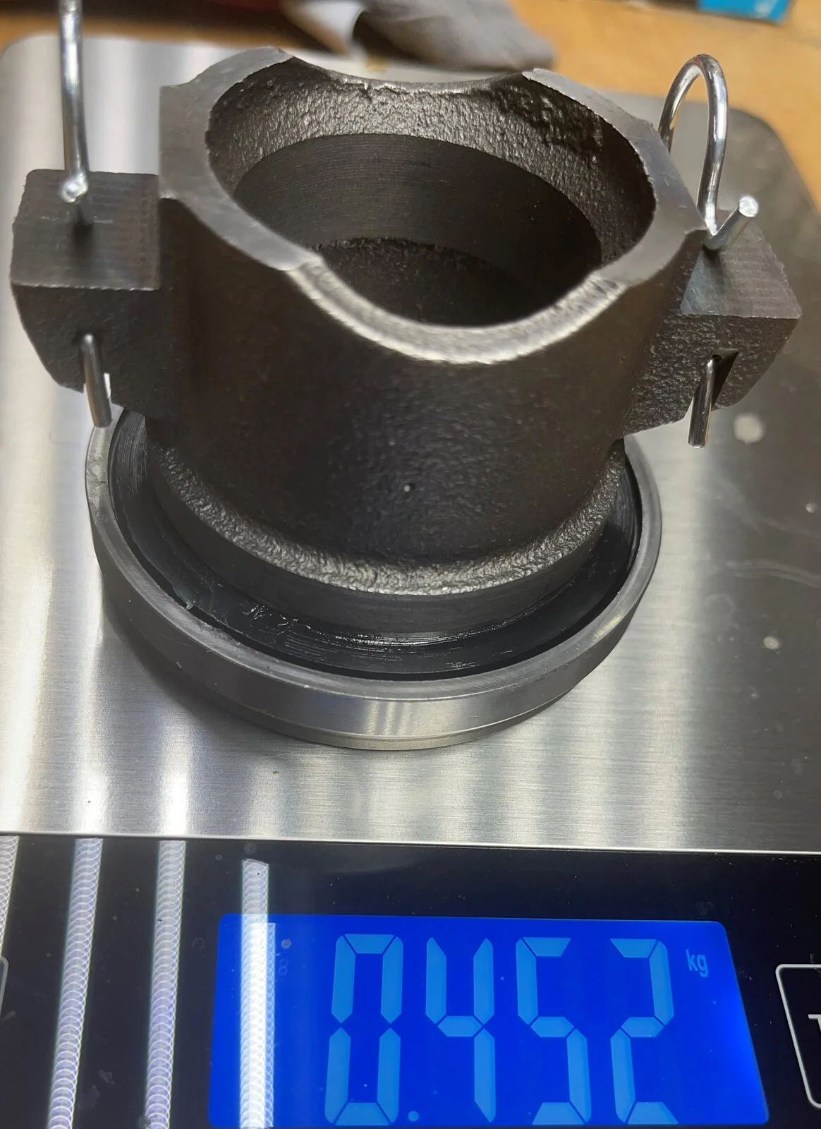

Here are some pictures of the Luk included bearing and the National. In case anyone is wanting to see the difference.
The Luk bearing feels very light-duty and a bit on the flimsy side. I would worry about its longevity. I am ok with the composite material my observations of duty are related to the bearing portion itself. The bearings side by side looks like the store brand compared to the performance brand.
Sorry, my little scale wasn't on freedom units. I generally use it for measuring components for my remote control hobbies and things are tracked in Grams.
