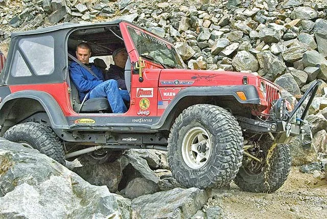

In fact the only steering box failure I've had was with an aftermarket "upgrade" that didn't make it through without springing bad leak through its front seal. You can see it spraying here, a photographer was at the right place at the right time. Fortunately I was wheeling with @mrblaine who had a spare rebuilt steering box for me in his "magic parts box" back at camp.
