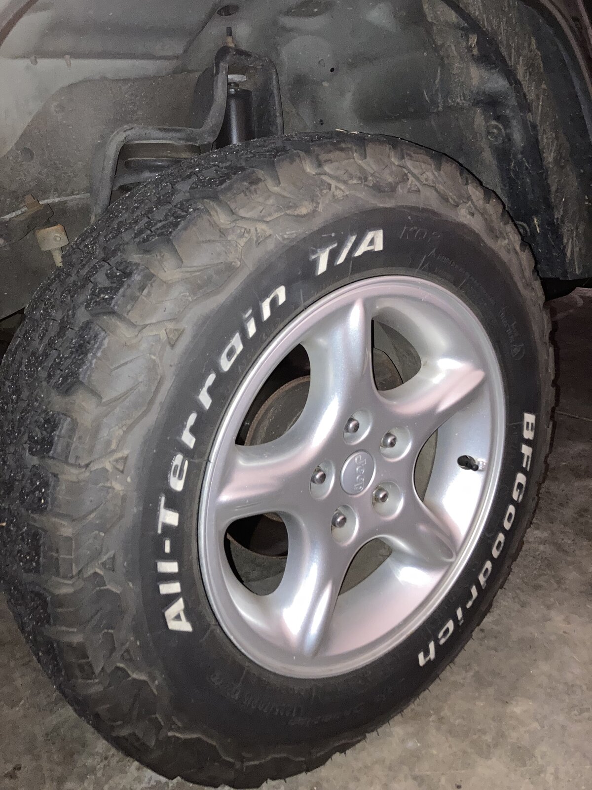

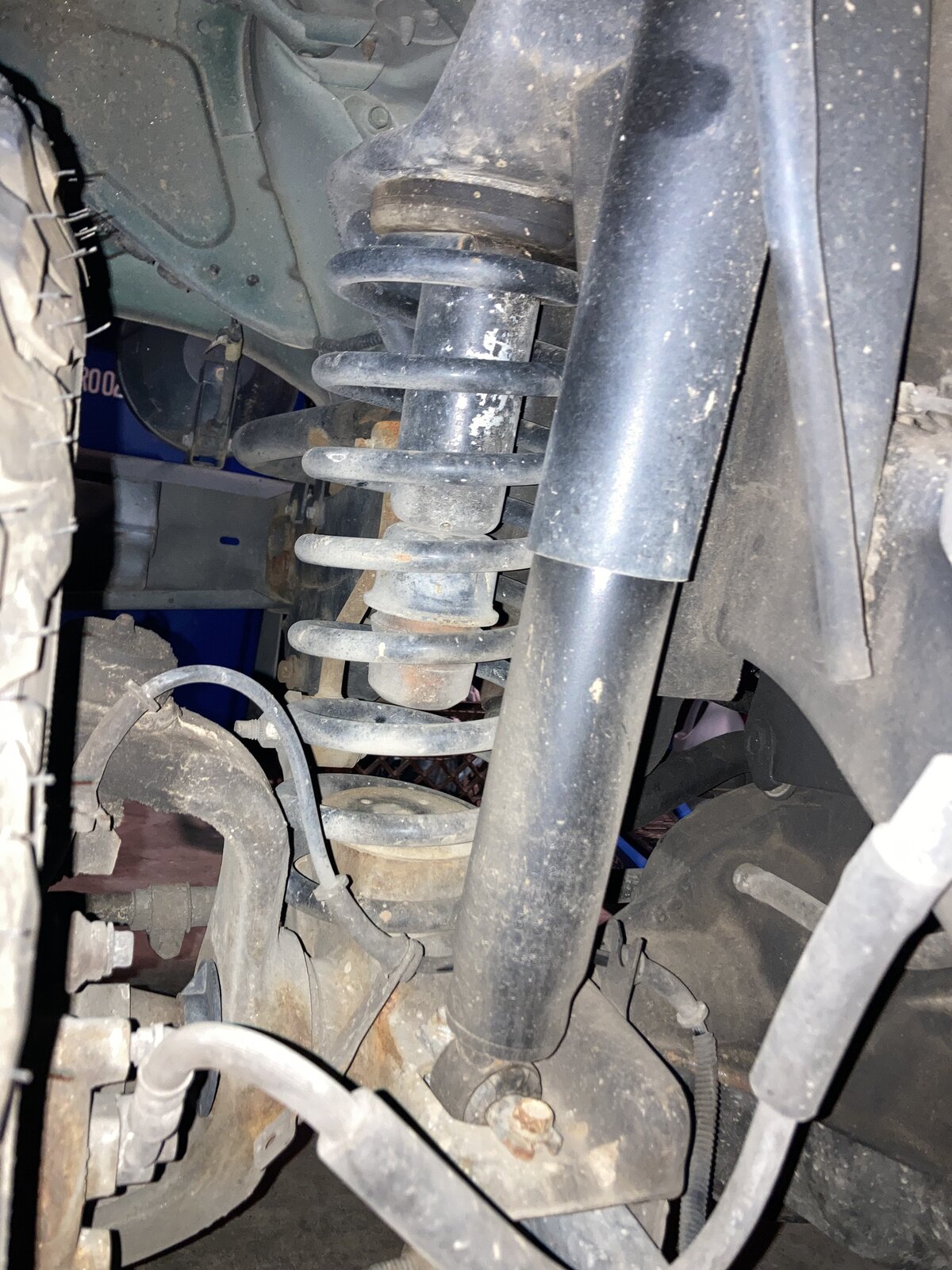

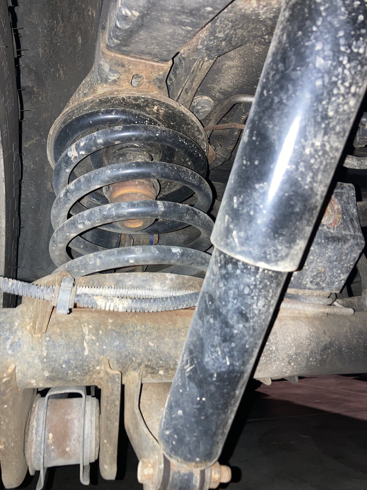

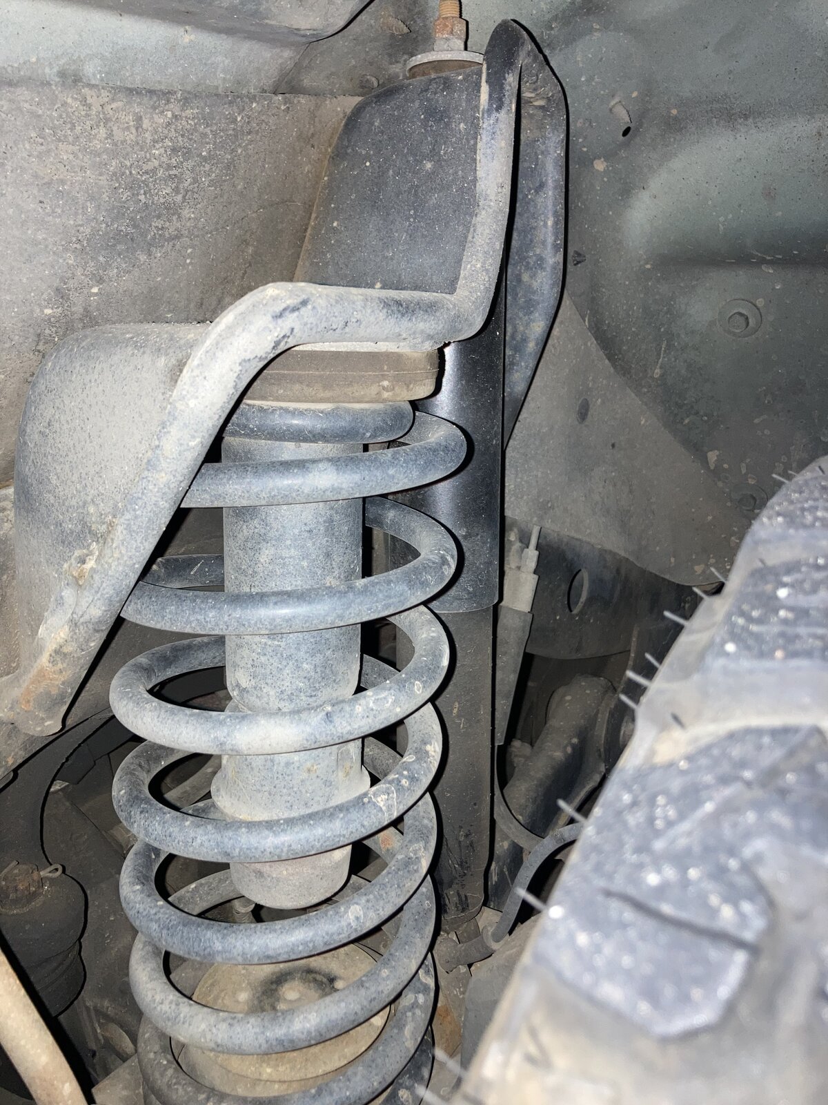

Pictures of your spring and shock setup would be helpful. What about the body mounts, how are those?
A few people mentioned pictures so coming back after grabbing these in the garage. Hope it helps confirm there's nothing obviously unusual here! Like I said, I'm kind of out of ideas and thinking it might just be the super stiff but small tires.
