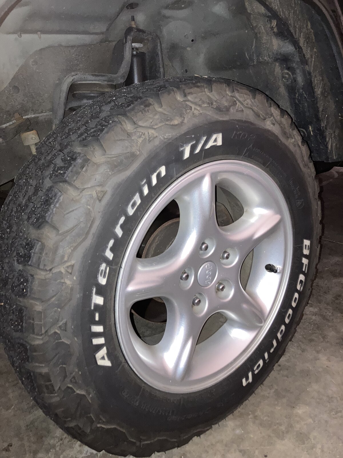

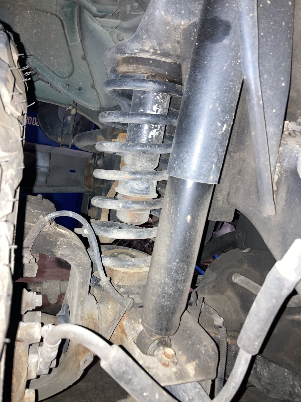

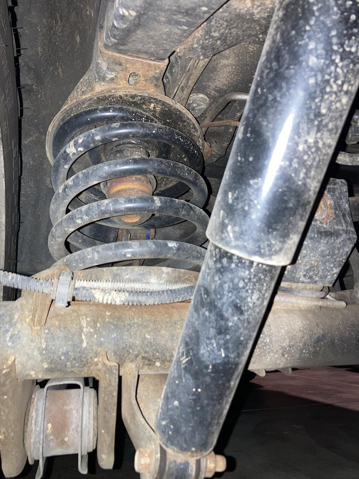

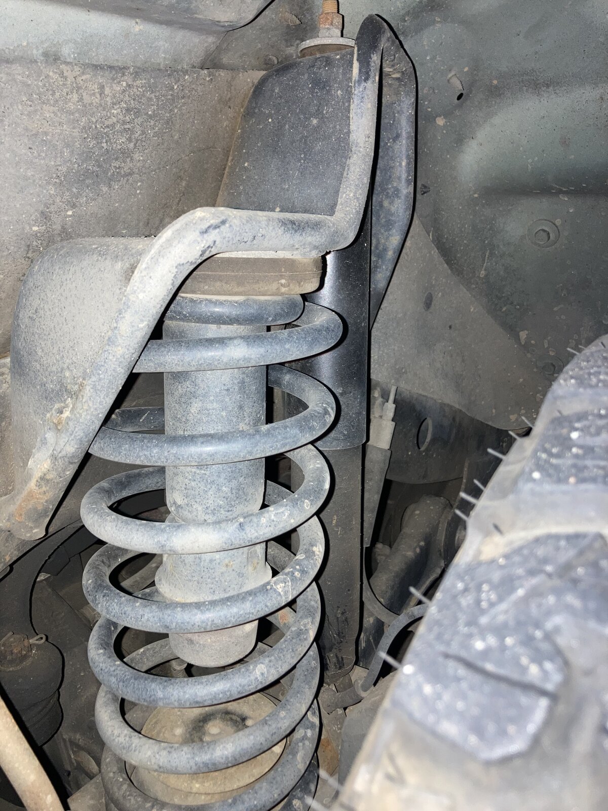

A few people mentioned pictures so coming back after grabbing these in the garage. Hope it helps confirm there's nothing obviously unusual here! Like I said, I'm kind of out of ideas and thinking it might just be the super stiff but small tires.

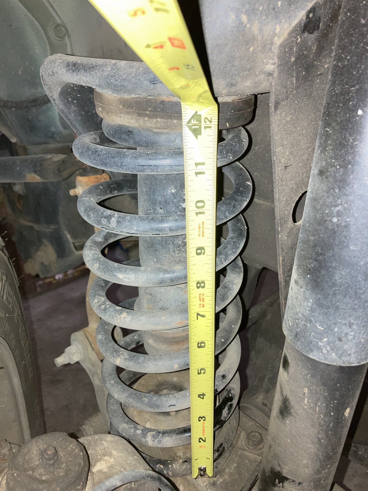

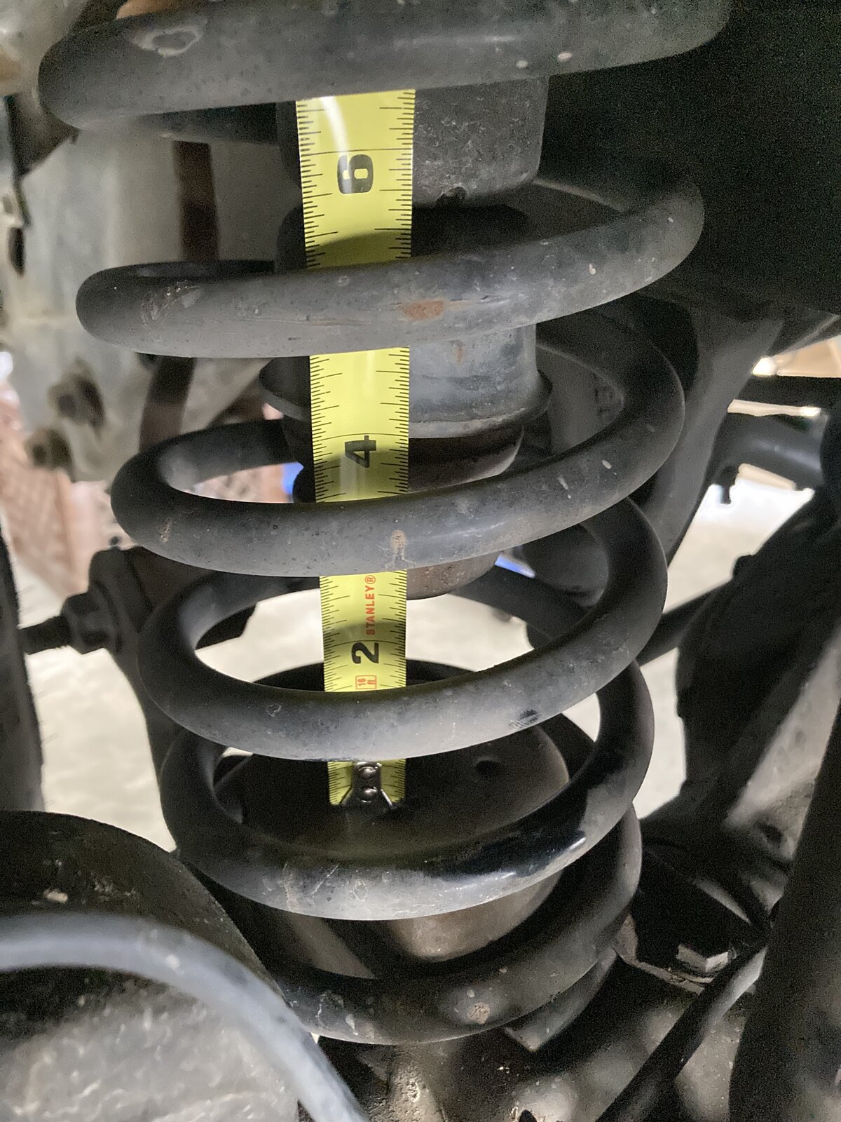

The front bumpstock looks like its making regular contact with the axle pad. Do you get 12" (stock)measuring the springs compressed height? Minus the upper rubber isolator.

Measure the gap between the steel cup and the axle pad. That will keep people from guessing. I would expect about 3.5", give or take a bit, on a stock TJ.
Measure the springs, too.

You appear to have the optional 16” wheels that were available on the Sahara. Are those stock? And if so, what was the stock tire size, and what was the recommended inflation for that particular OEM tire (on sticker below driver’s door)?
Yep they're stock optional 16" wheels. Came with 225/70r16 Michelin LTX tires. I know this because the original spare was on the back when I bought it. However, the door sticker only states for 15" wheels which is: 30x9.5x15 @ 29psi
