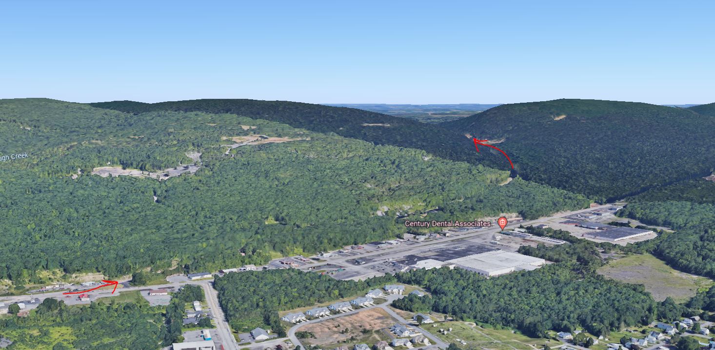

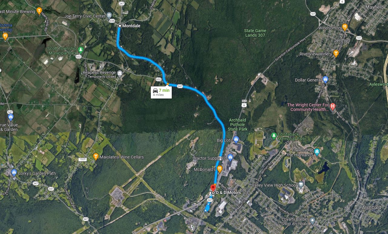

Here's a perfect local example of why a lack of usable mid-range sucks donkey dick, and why those "select few" who insist the 4.2L "wAs KiNg!" are wrong... Wildcat Hill Rd:
It's a relatively short, local stretch of road (about 4 miles long) that winds and goes from ~1040' ASL to ~1420' ASL (which at ~380' of elevation rise, is larger than the highest point in Florida!). The grade varies, but is ~2-3% in most spots. There are a few flat spots but they are short and usually around a curve.
My dad's old CJ-7 could do a wicked burnout and lay rubber for days - while at the same time could barely maintain the speed limit up this hill (in any gear!). I give the 4.0L shit for being a glorified tractor motor but it feels like a rally car by comparison up this hill! I couldn't imagine my dad's CJ-7 in Arizona, where you go from ~1300' ASL in the Phoenix Valley up to over 7700' ASL above the Rim (Payson/Prescott) in ~60 miles. It has to be worse than the 2.5L YJ guys on 35"s and factory 4.10's...
