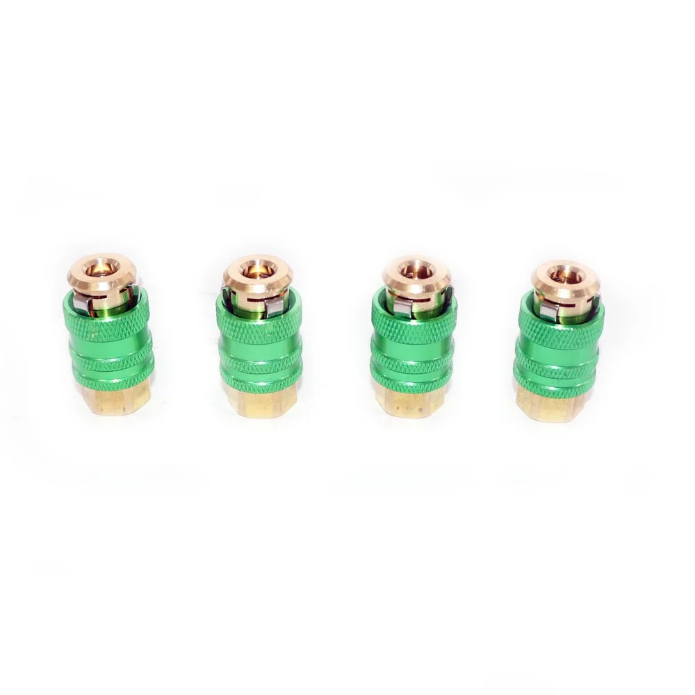

I am still trying to figure it all out. WItt's End makes some nice nipple plugs for the disconnects. If you decide to mount them on the outside I suggest these. I've got a pair for mine.
https://absolute-wits-end.com/quick-connect-air-coupler-pacifier/
I saw those referenced in my very early research today (seriously - bought OBA pumps on a whim....). I like the simplicity. Certainly wouldn't keep a connector without some sort of cover or plug.

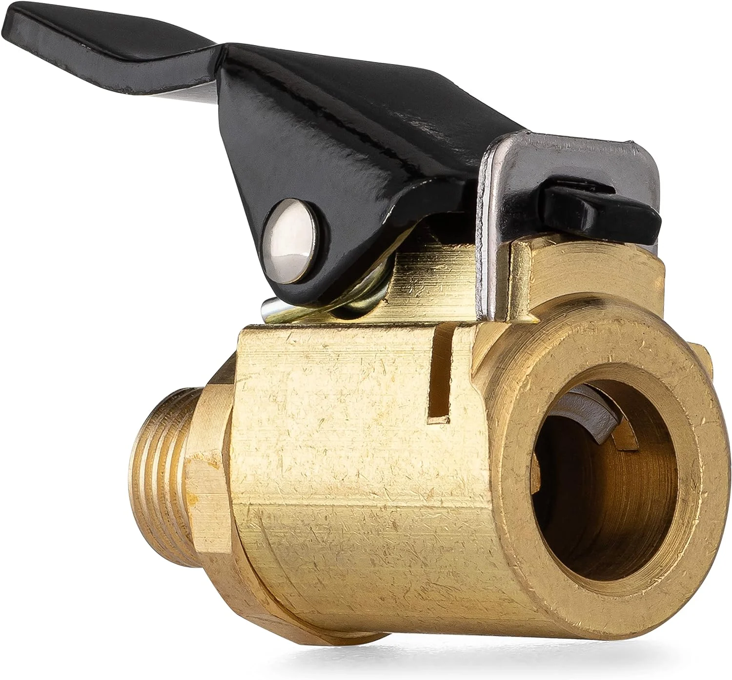

The Morflate locking air chucks do a pretty impressive job of grabbing the stem and not leaking
https://morrflate.com/shop/morrflate-accessories/morrflate-locking-collar-air-chucks/

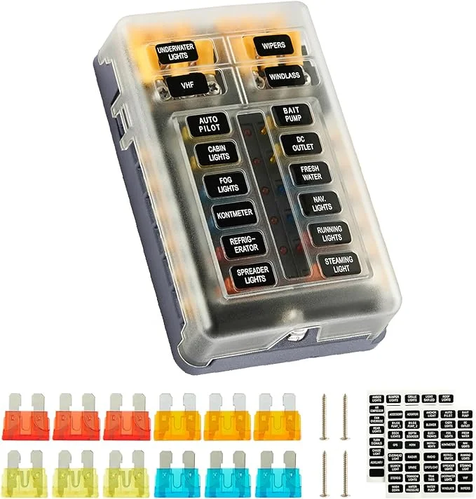

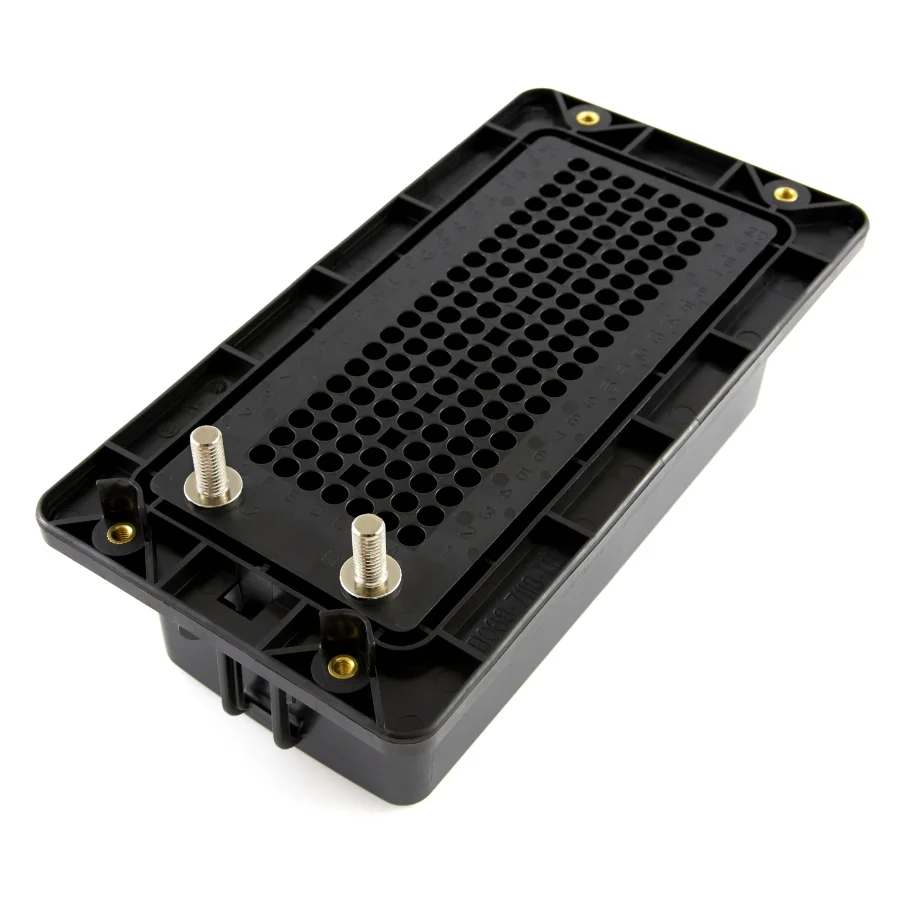

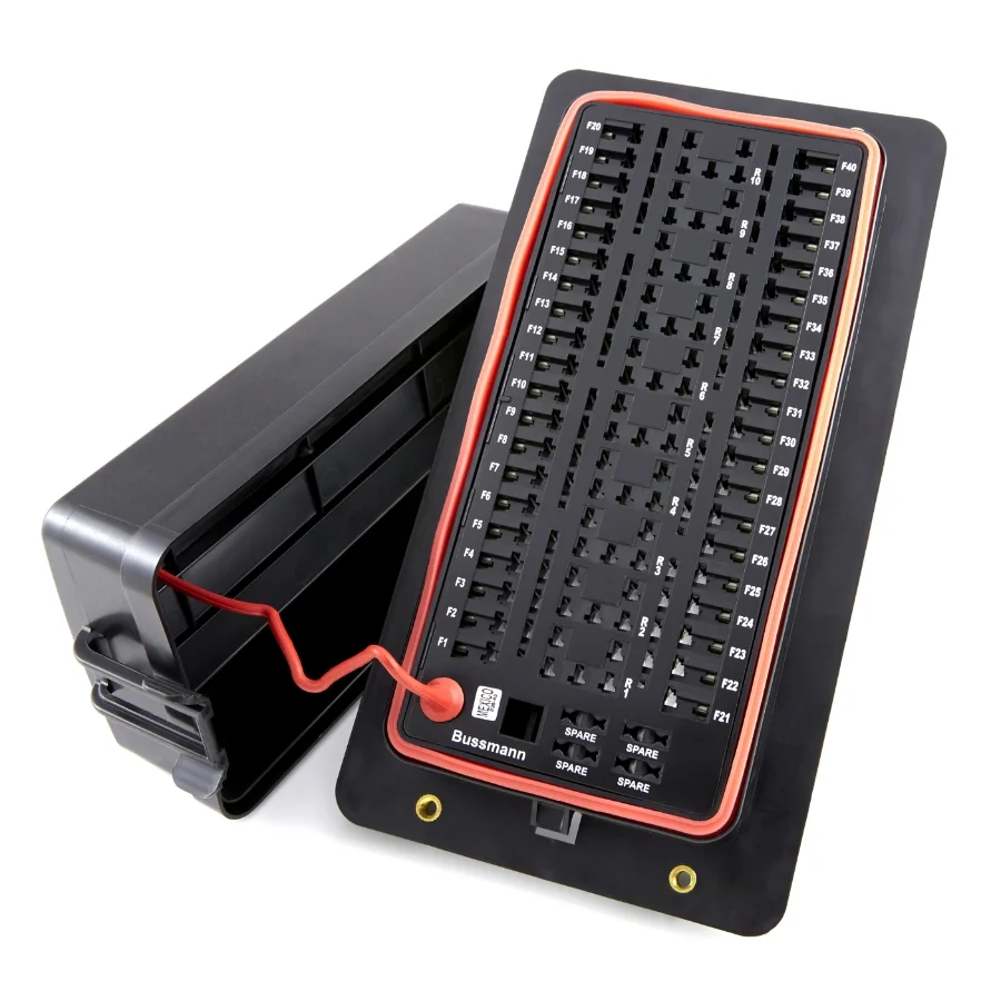

I'm thinking this isn't what I want to use in order to avoid future potential corrosion issues creeping in...
I'm building a list of circuits. But looking around the forum, I've seen this used a few times.
https://www.waytekwire.com/product/eaton-s-bussmann-series-15401-2-0-1-0a-rfrm
I think this is way more circuits than I'll need - but I like the design, if in a smaller size.

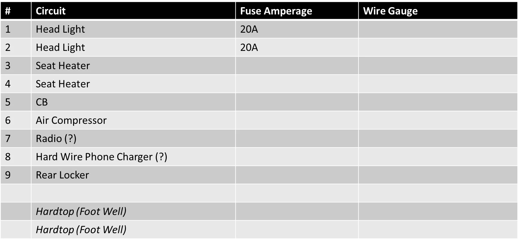

So, I'm building my list of circuits. So far, here's my list:
I'm just starting to build it, so lots more to add.
The hardtop ones were existing in the OEM add-on wiring kit I installed once I purchased a hardtop. So, if I have the space, I'll move them from the footwell, but they aren't a priority (if space is a concern).
Headlights are also up in the air. I planned to install a headlight kit because I have higher wattage bulbs —- but they are non-LED versions that I never got around to installing and I think I'm wasting time with a headlight wiring (but still TBD if I want to use the on-hand stuff I have).
More research to come. Welcome any thoughts on any of this. Likely a early spring project at this project.

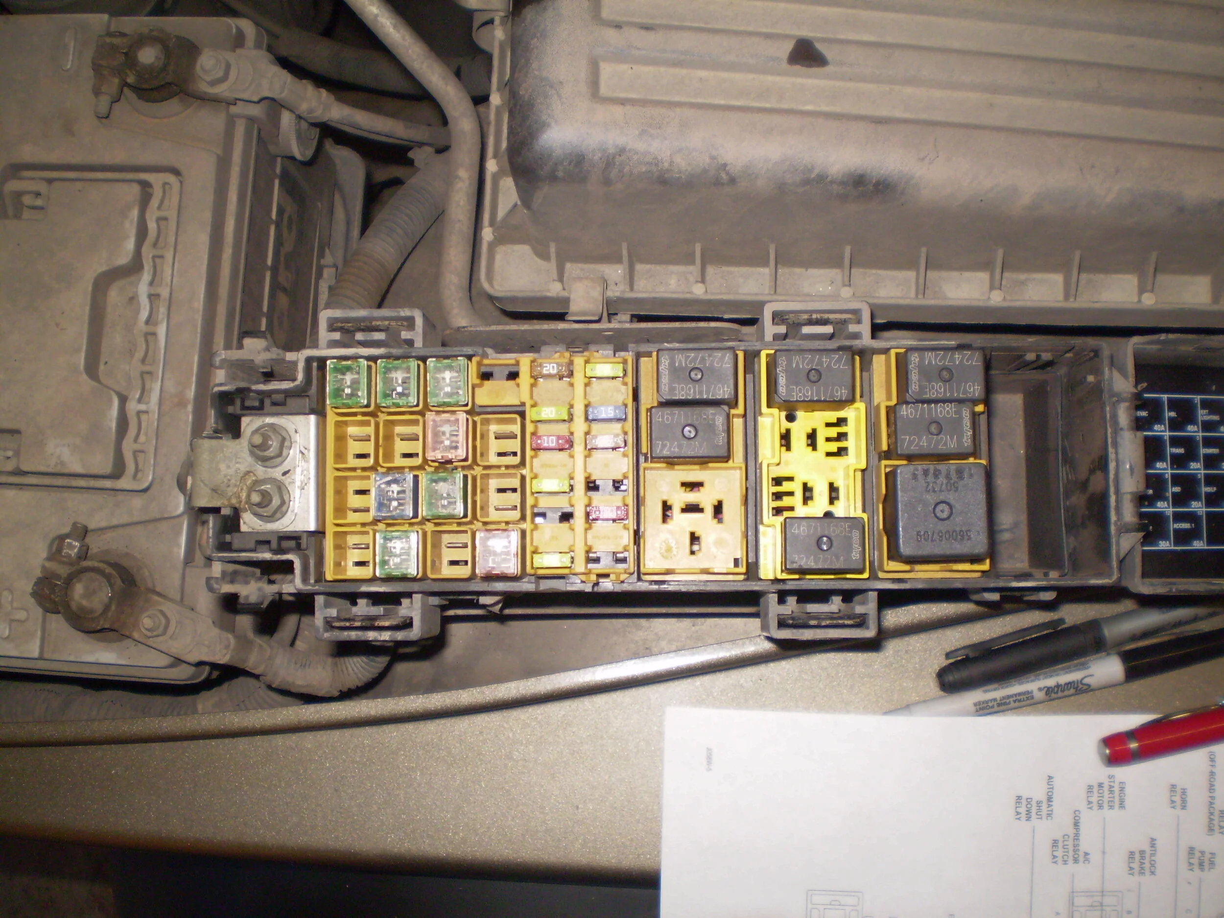

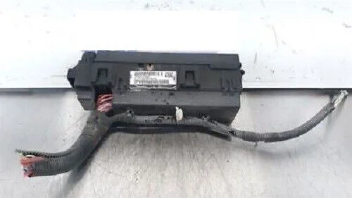

The more I researched, I decided I wanted to add to the existing PDC (or try to). My local junkyards are 'we-pick-it' or horribly overpriced so I've been working with eBay more recent - which is sad because I loved the junkyard experience when I was younger and hope that's available for my boys when they get old enough.
So looking at options, I'd be in at least $120 if I went with the large Bussmann. Saw this 05 TJ PDC on eBay for $75, so I pulled the trigger and it's on it's way to me.
I planned to try to the 12 fuse holder portion from the eBay one and drop it at the end of my current PDC. I was also thinking to move/consolidate some of my relays, since I don't use the PDC efficient.
But now I'm leaning more towards adding the eBay PDC as a full unit into the TJ and re-wire it for relays and straight fuses. I'll re-use the high amperage key-on relay and breaker I planned for the other fuse block I have on-hand.
