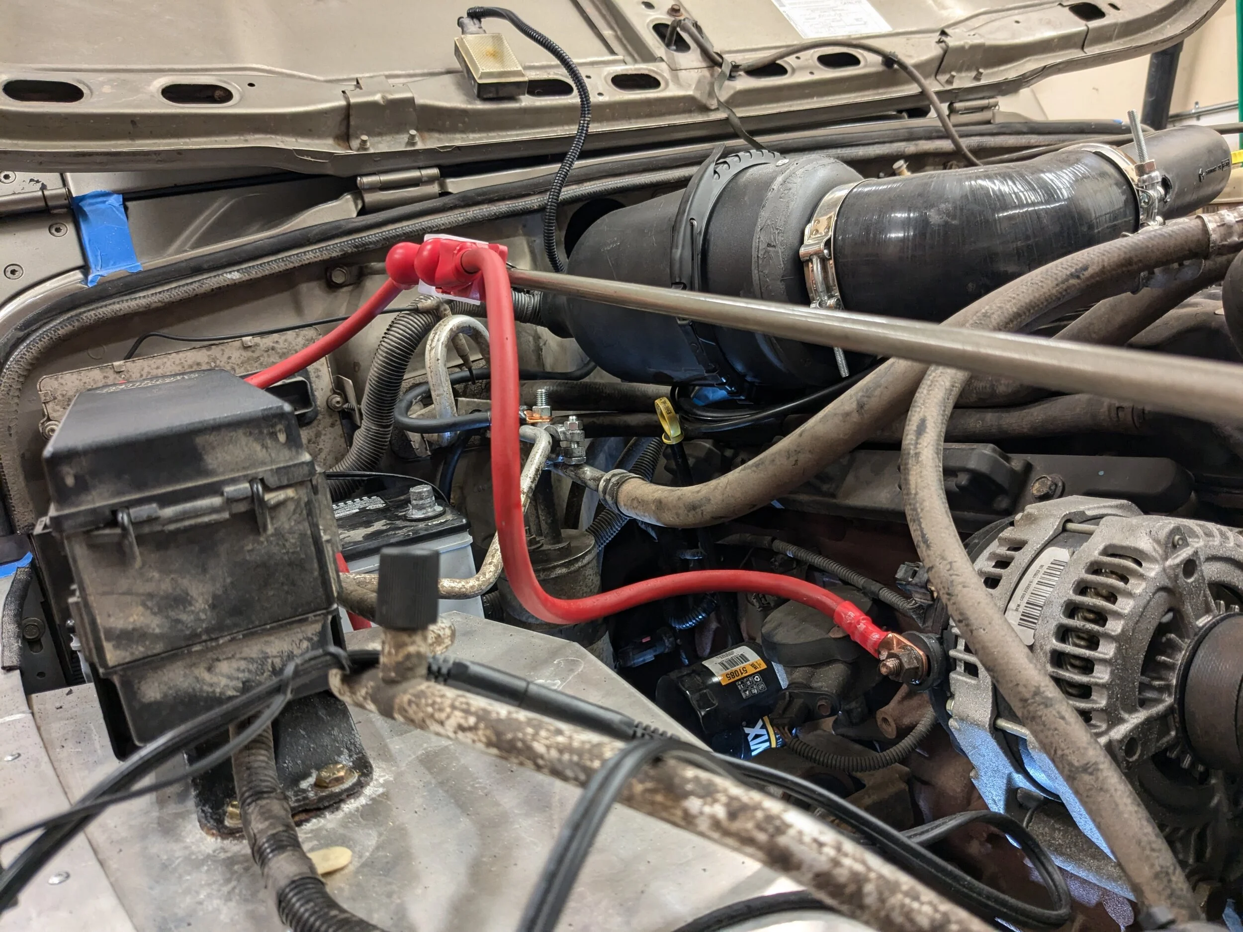

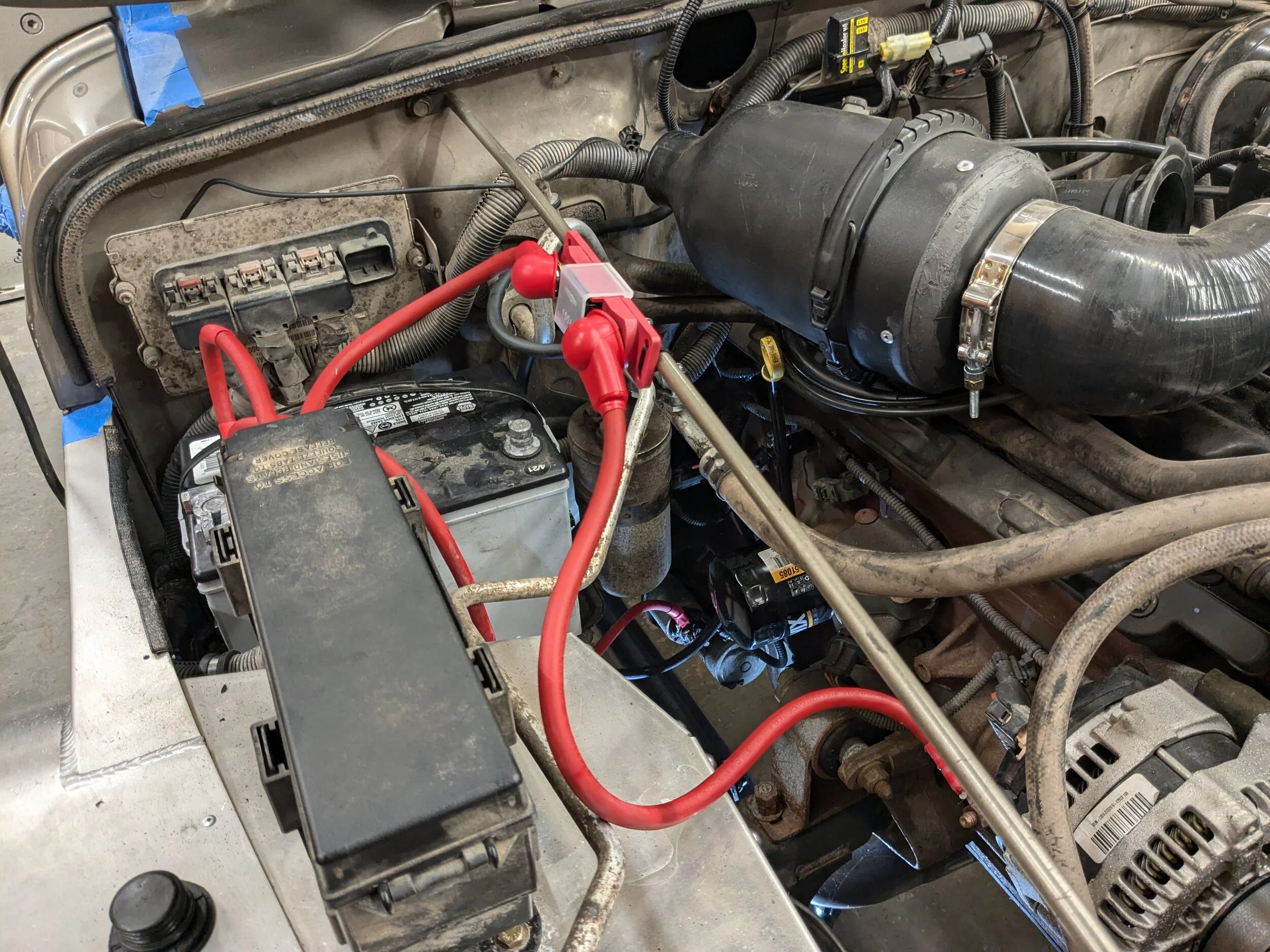

Installed Big 3.

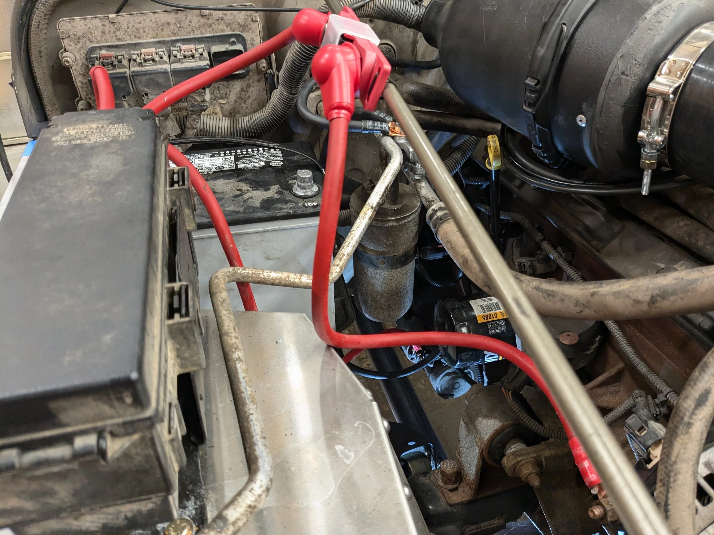

I don't love how the + cables are run and how the fuse is mounted. I'll likely put loom on the + near anything they may bring on (if still close after another adjustment).
Fuse: I may weld in a permanent mount once the second PDC goes in because the fuse has more play than I like but will likely move with the addition on another PDC. I can't get zip ties tight enough for my liking.
Reactions: Rickyd and Wildman

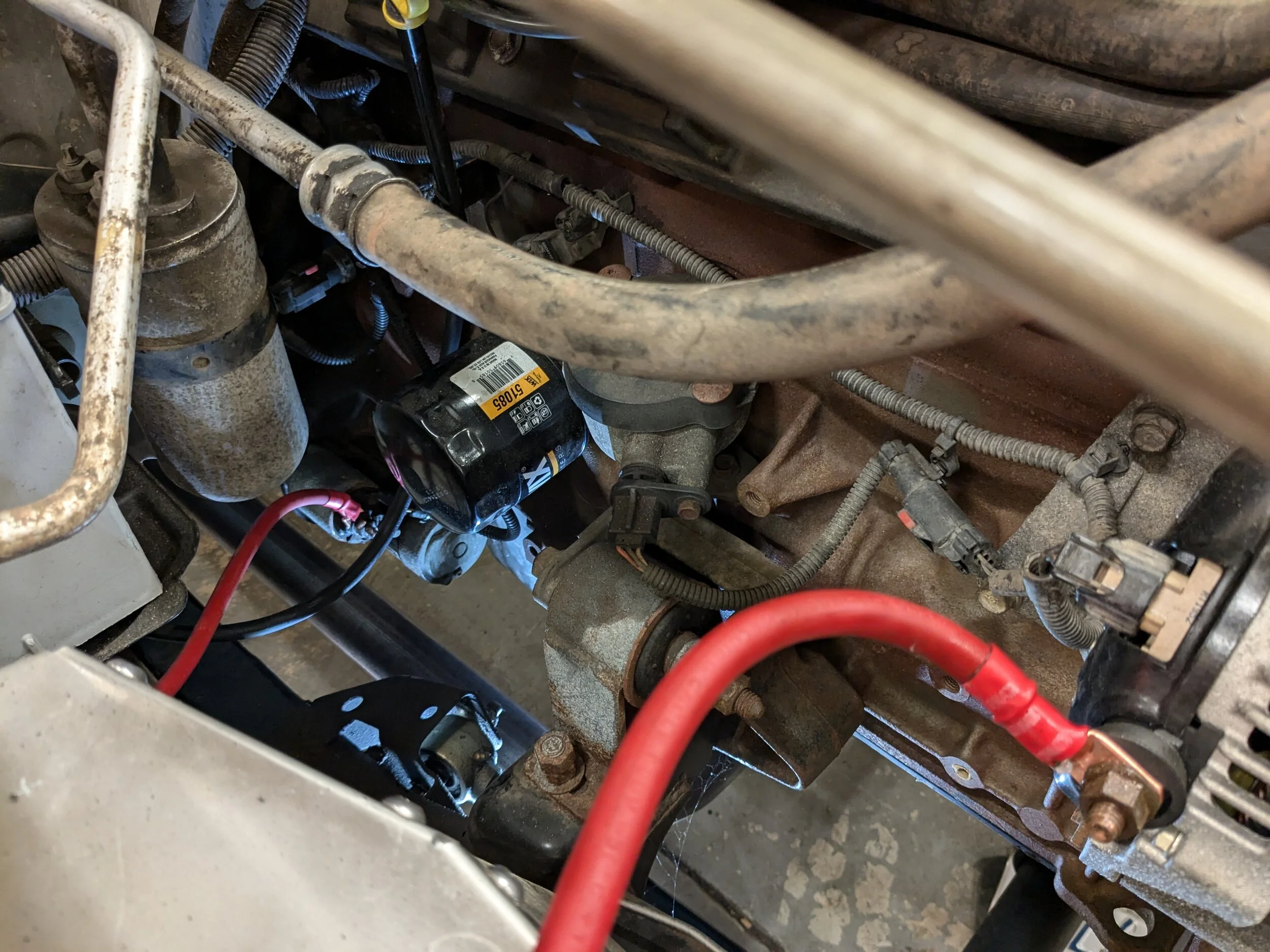

Realized the alternator cable was turned at the fuse so fixed that. It's better.
Still want to do another visual before feeling comfortable.
Land out the spare cable that is labeled 'battery' and 'fender'.
It's so long that I figure it was meant to go to the driver side. But I can't see where it would go...
All the electronics work that are mounted to the Genright fender.
Maybe I'll use this cable as a strong ground when I mount the ARB Compressors in the stock lockers pump tray...

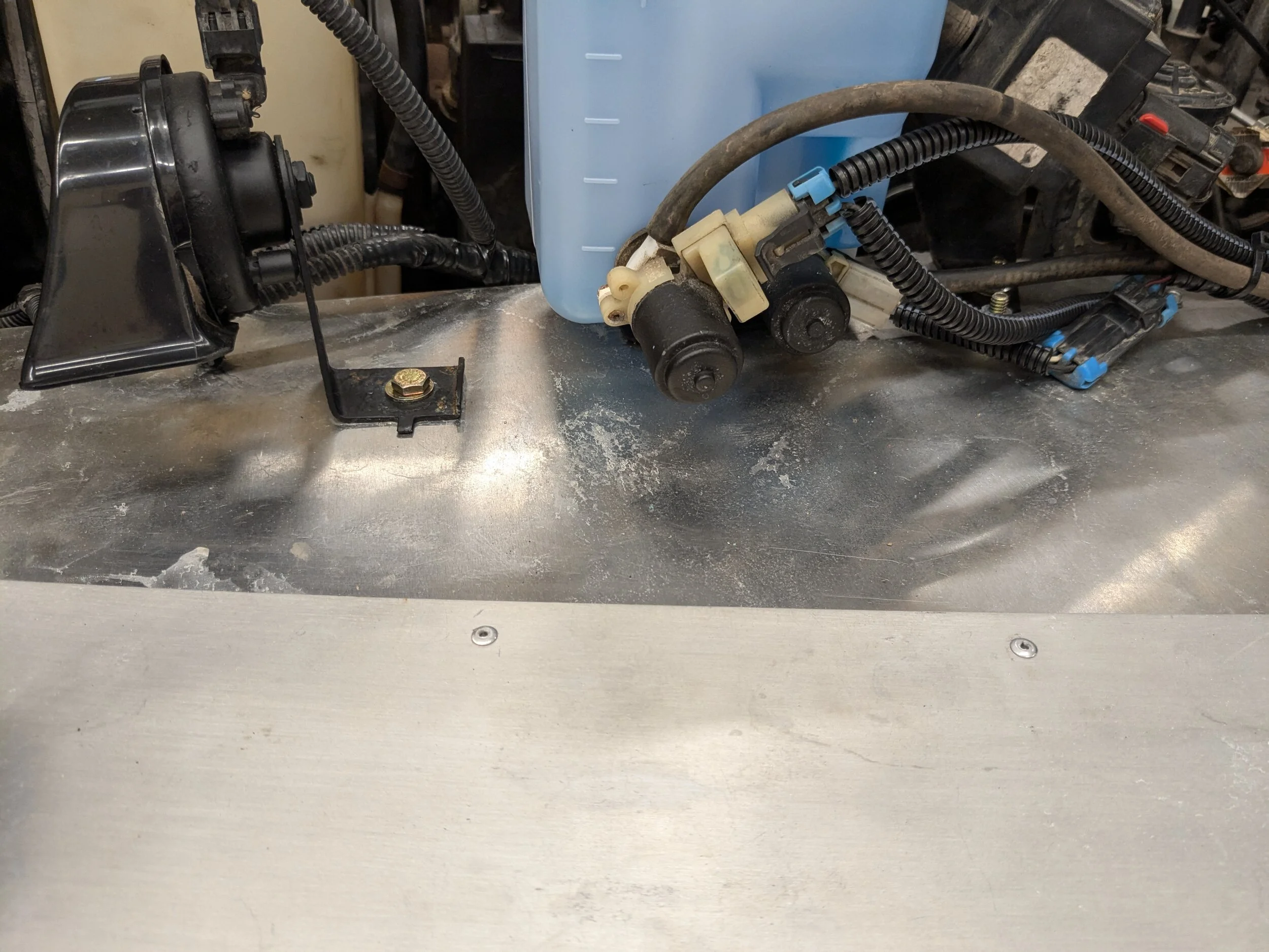

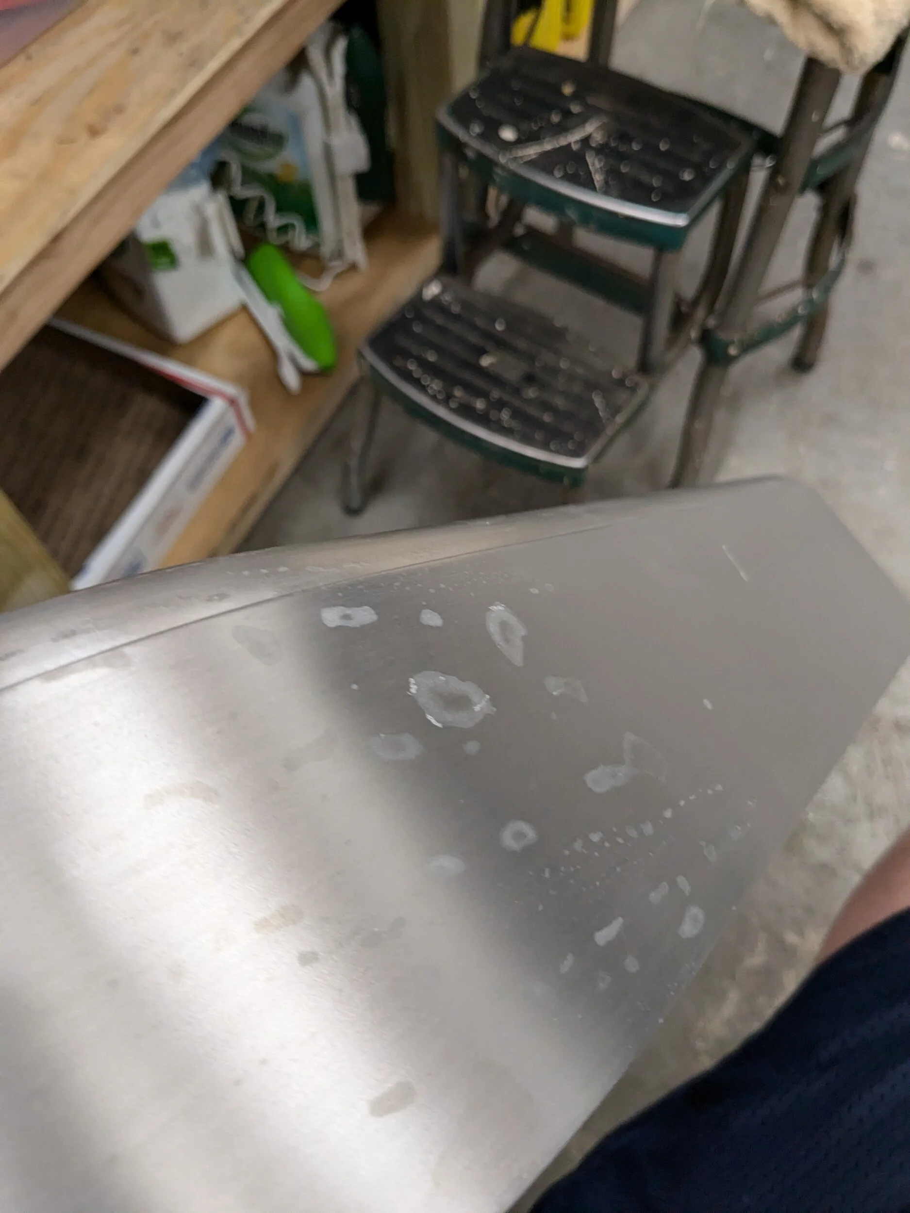

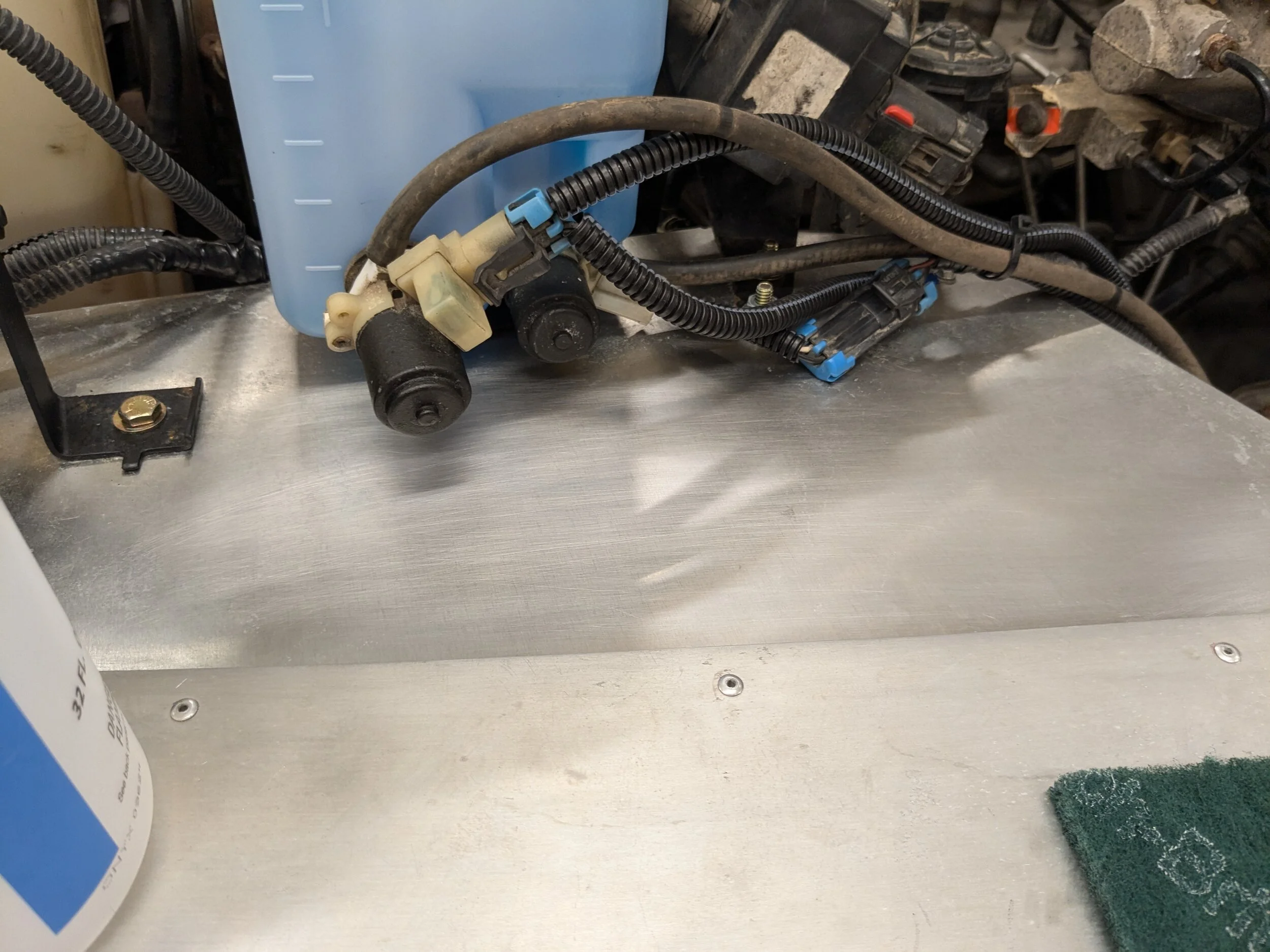

I'm tired of looking at all my aluminum (Genright fender - front and inner + rears) that look like shit.
I left lots of sweat and loctite sitting on them during the install (contaminates sat for years...). Haven't had success with my approaches (dish soap, 97% isopropyl alcohol, aluminum cleaner).
So reached out on the forum.
Test tonight:
Pet forum, tried 99% isopropyl on paper towel & Quick Detailer on a microfiber cloth.
No change.

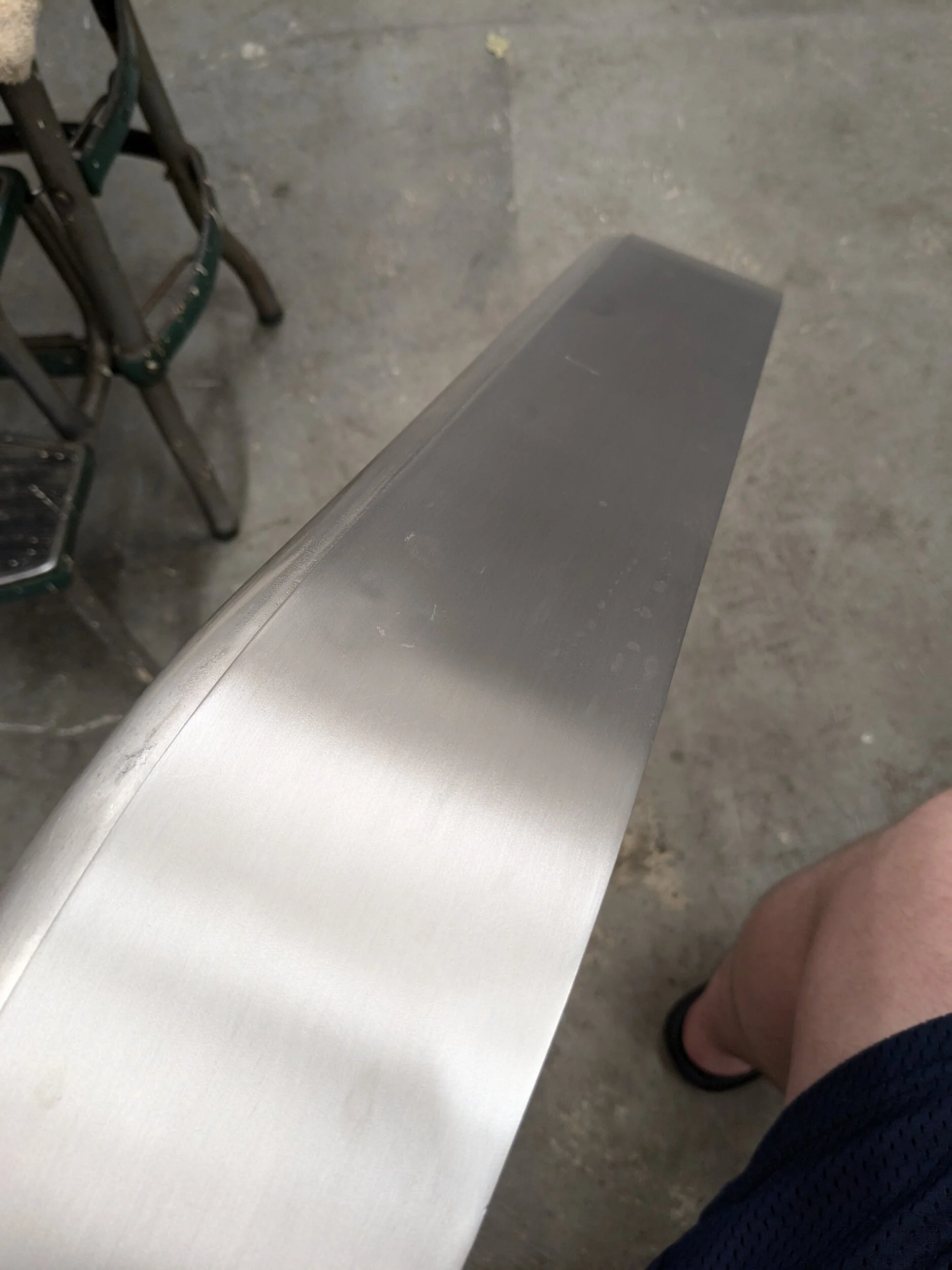

Saw the idea of WD40 with Scotch Brite on a post for @Fluxor's bumper that someone did to great effect.
As a test, I just grabbed the green Scotch Brite from into my kitchen sink and used WD40 as lube....
This is the result after about 5 (low pressure) wipes...
:oops:
Still more to go but trading complete, I have a path forward hopefully that the staining isn't beyond the top layer...
I'm beyond ecstatic that I may be able to fix $1k+ worth of parts that I worried I ruined... 👍
🥹 There's hope!
About 7-10 swipes of the pad with WD40.
The grit is all wrong (too aggressive) but I have a path forward with a more appropriate Scotch Brite pad!
I can't express how happy I am to see a path ahead for the aluminum!!

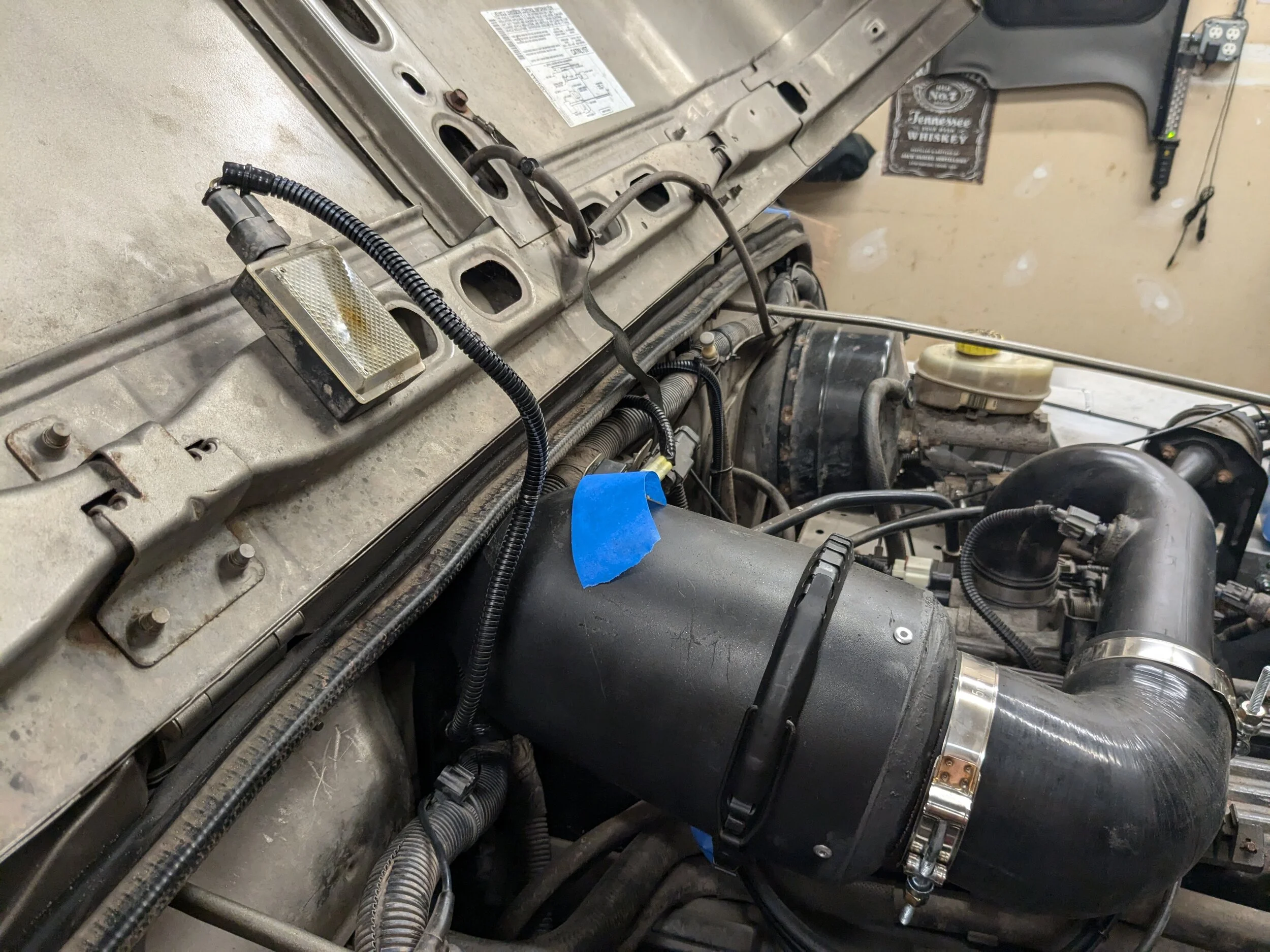

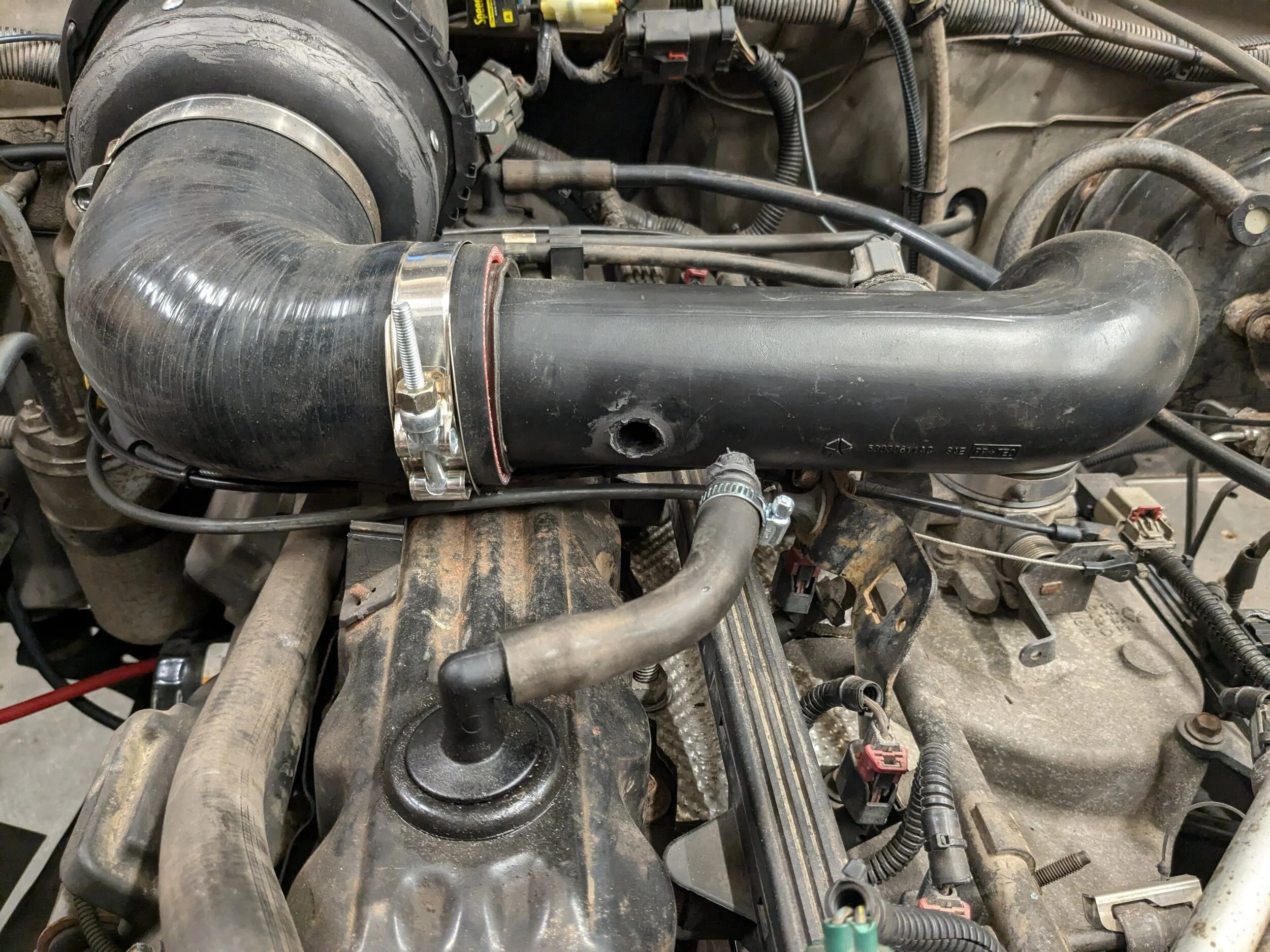

Intake had a lot of issues. Hitting the hood is biggest issue. Getting out off sitting on all the cables is next. Crappy connection of the breathe hose.
Hood issue needs to be tracked first.

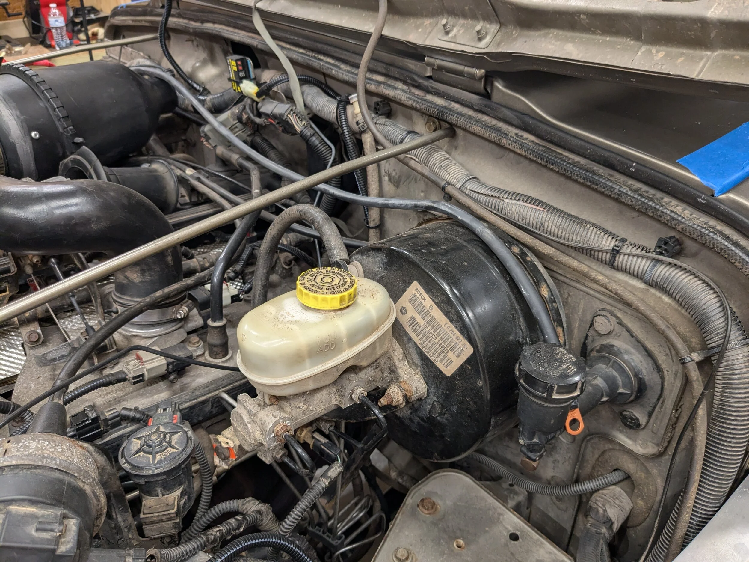

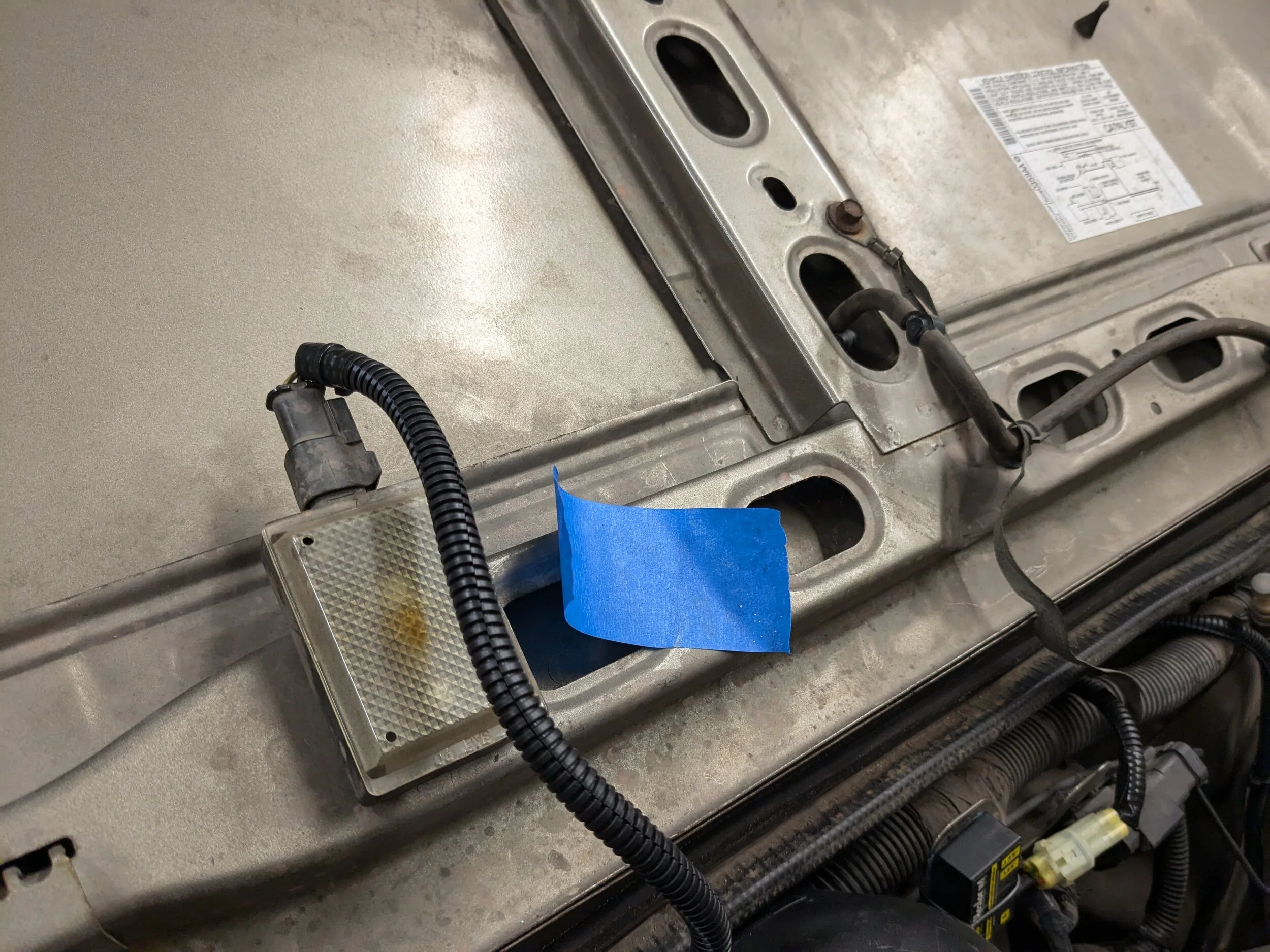

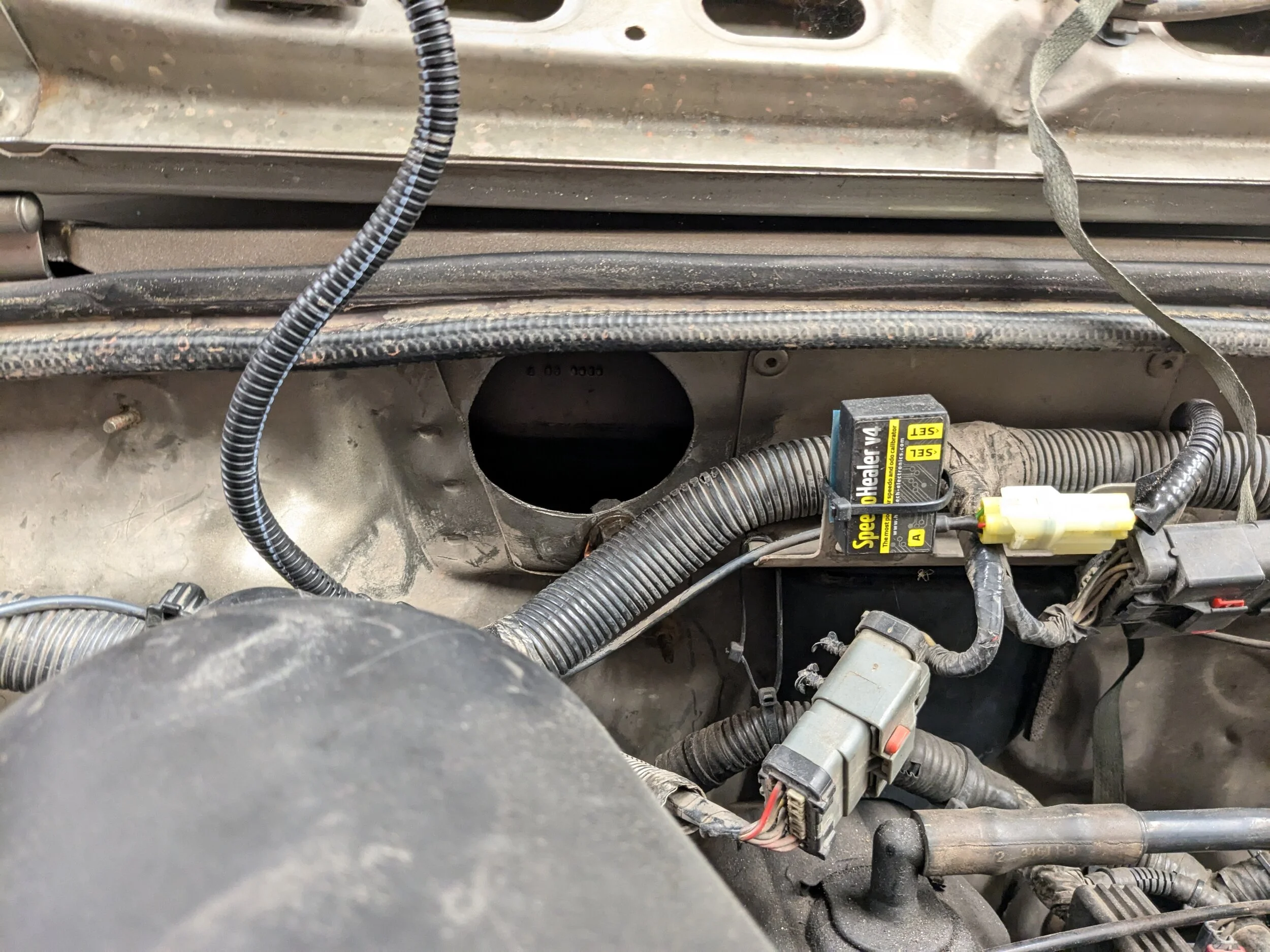

Here's where I drilled the firewall.
Clears the grounding nut and the spot welds.

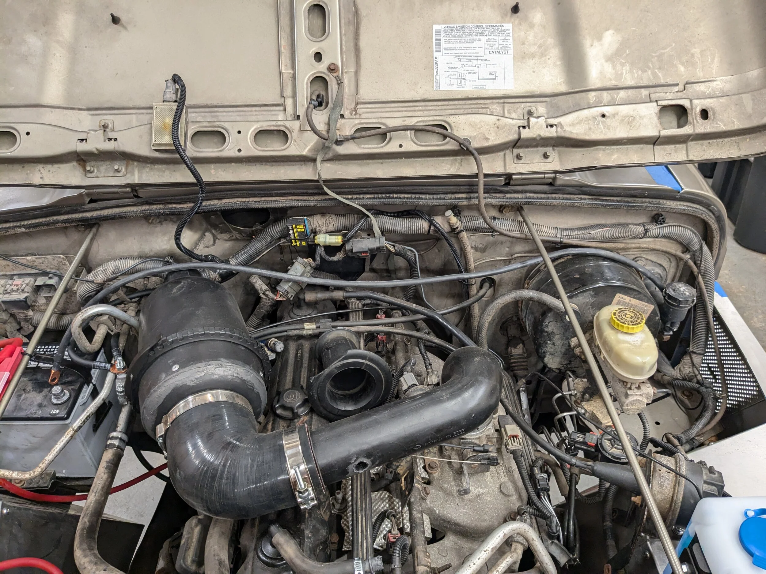

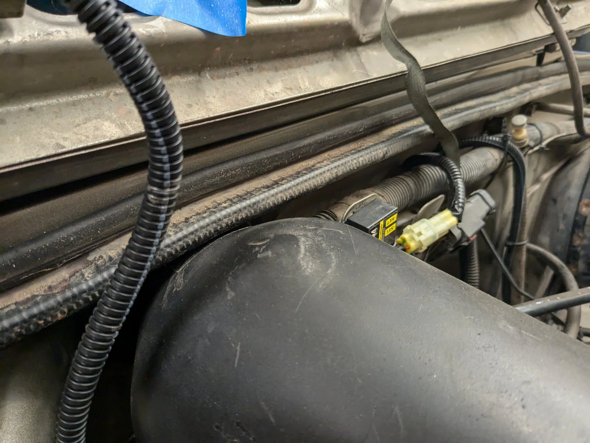

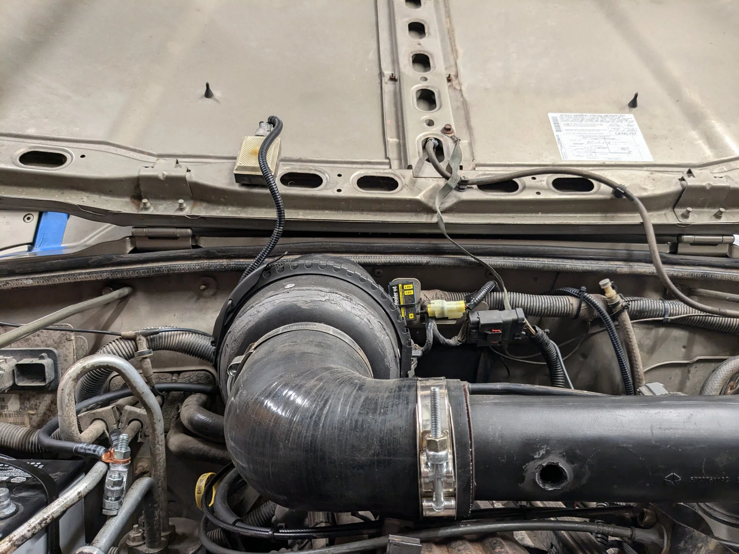

Loosened all the clamps and ran a tape test.
You can see where the hood rests on the filter box.
I need to lift the rear of the filter box to clear the cables by at least a bit. But that causes the filter box to go even higher at the firewall making the problem worse.
I'm struggling to think I have a better solution than cutting into the filter box and adding a flat panel... I placed my hole in the firewall just like others I'd seen use this so I'm struggling. Surprised that they didn't deal with this issue of Hood impact..
This is using the Windstar filter box that so many others have used and I'm struggling that I'm having a problem here that I didn't see others having...

This connection is also proven to be a failure point.
I need to be able to remove the intake and a clean the throttle body and I don't think getting this hose off the breather will be any easier when I want to clean the throttle body.
So I'm thinking maybe some sort of quick disconnect might be needed here too...
This Windstar air intake is presenting itself as less a solution and more of a problem...

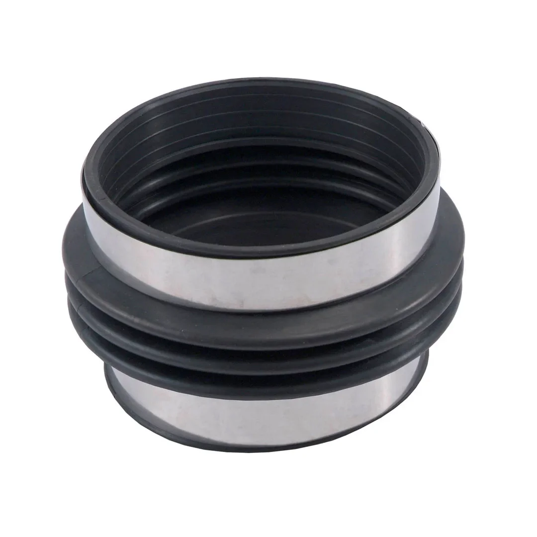

Is the Windstar 3 1/8" tubing? If so then we'd need to reduce from 4" to that? They make some reducers to 3.5" so then a short piece of hose that went from 3.5" to 3.125"
