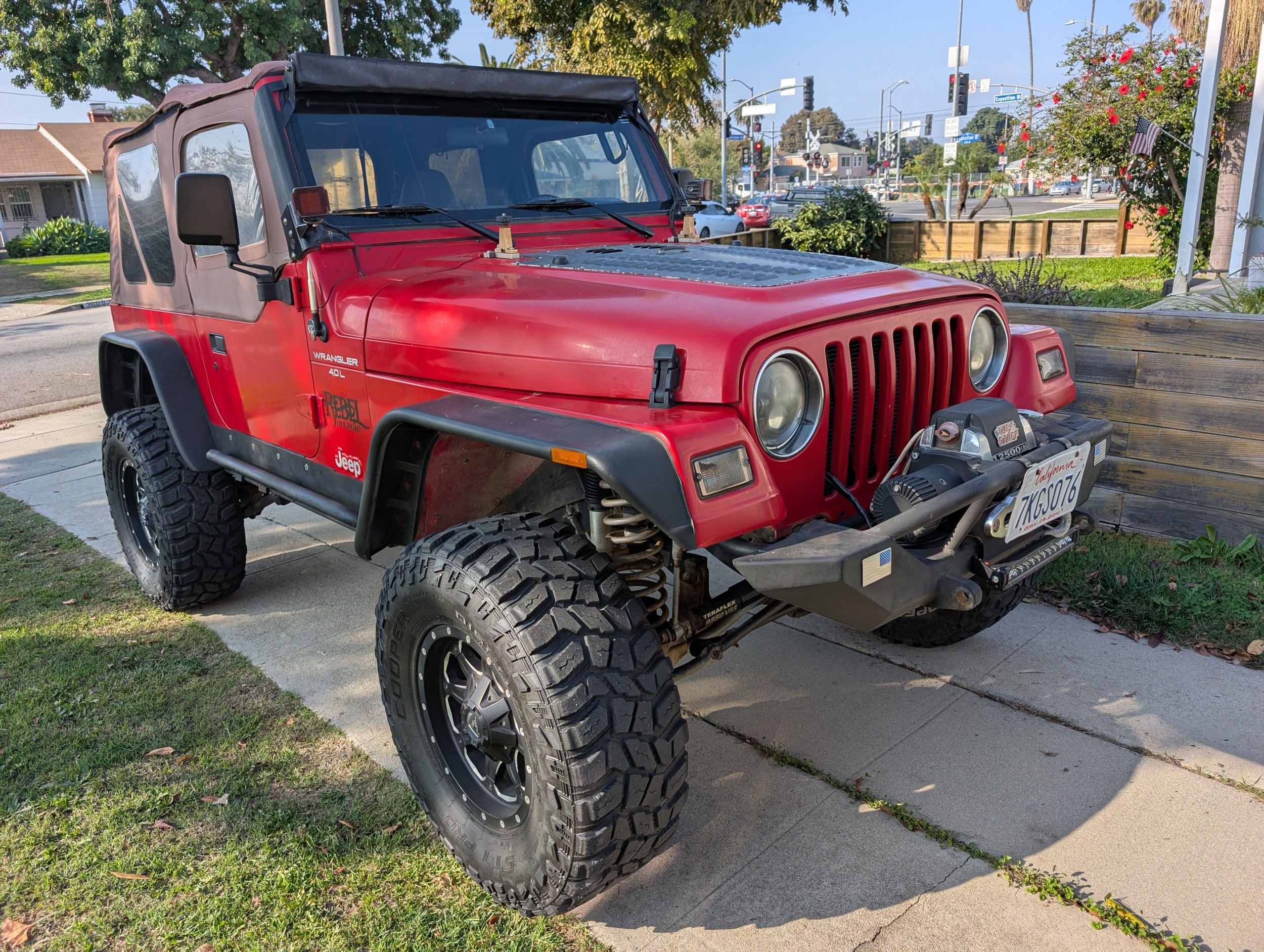

Figured it was time to start a proper build thread instead of just hoarding parts and ideas.

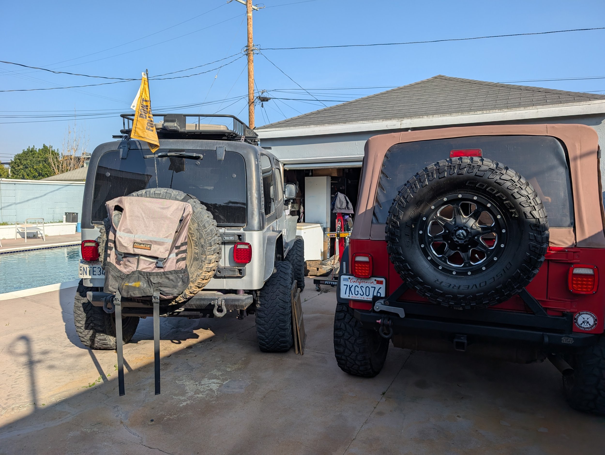

This is the starting point: a red 1997 TJ, mostly stock, honest, and unpretentious. It’s not pretty in a show-Jeep way, but it’s exactly what I wanted — a straight, rust-free frame, clean title, relatively low mileage at 109k, a 4.0L that runs strong, and a 32RH that’s rebuildable. It has a few light mods already — winch, mild lift, wheels and tires — all of which will get sold off as the build progresses. It drives, it wheels, and it’s the perfect foundation for a Jeep I’m building for me.
I’ve wheeled TJs for a while and know they are a great platform, and now I want to push the limits of what my driving, and a bolt on build can do.
The goal is a stable crawler that can still survive highway miles to and from the trail. I’m firmly in the buy once, cry once camp at this point. I’m building this one from the ground up in one shot. I’ve got built 2005 TJ that will stay on the trails while this one lives in my garage being built.
I’m not promising regular updates, but I do plan to keep this thread alive as the build moves forward — even when progress is measured in grinding sparks instead of shiny new parts. My next post will lay out the overall vision and parts direction, followed by a request for input on build sequencing before I start cutting brackets off a perfectly good frame.
More soon.

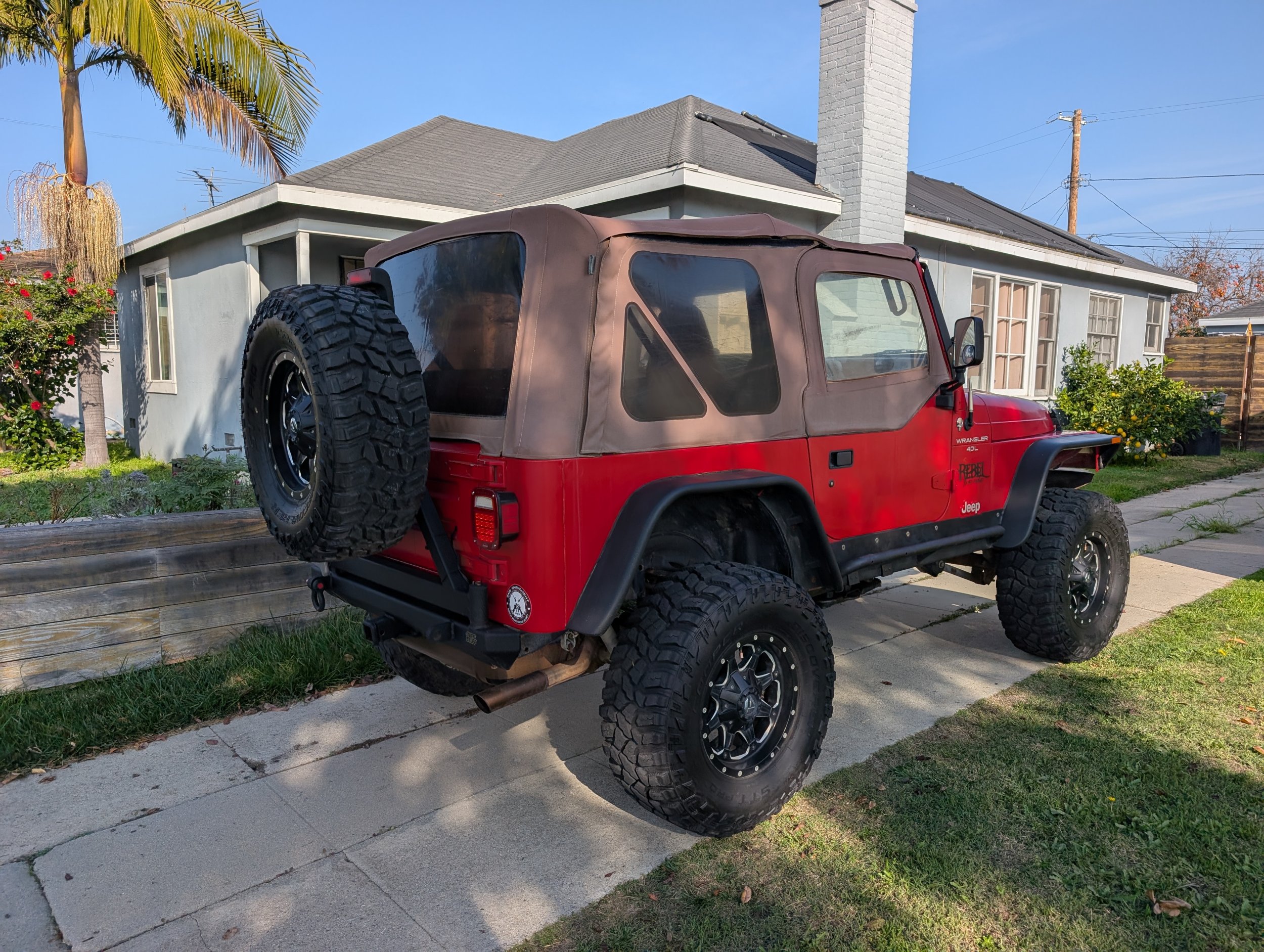

What a beautiful sight in my yard :)
PS My friends are convinced it's time for an intervention for my Jeep habit.

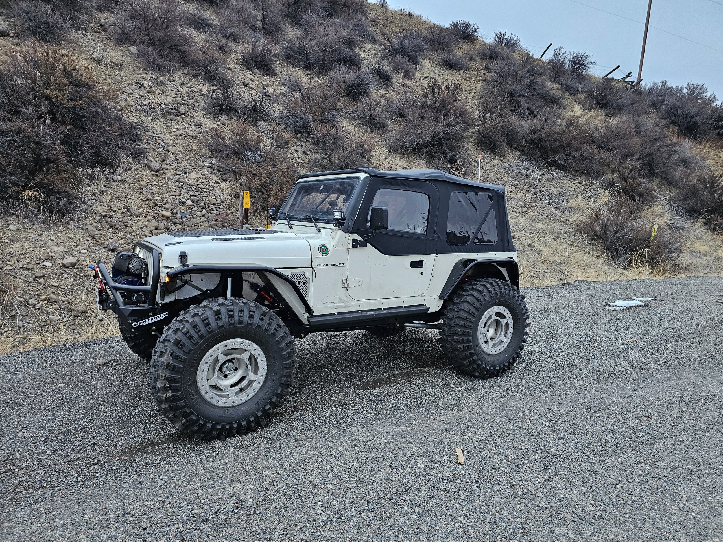

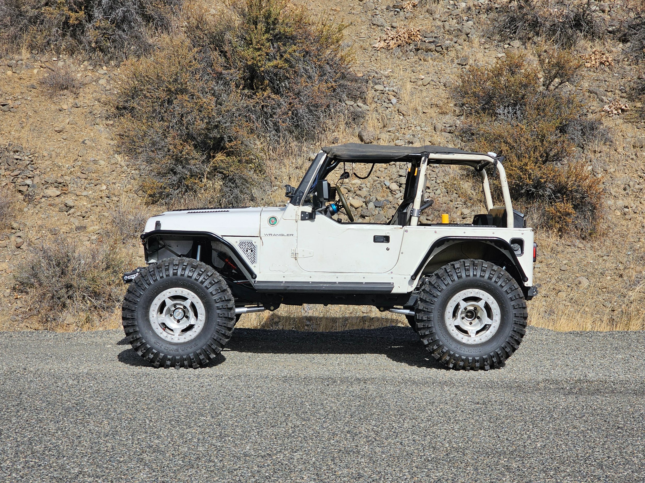

I'm sitting @ 100" with 5" in the rear & 2.75" in the front. I pushed the axle as far back as I could and still get the tires under the MC flares. I've got a 23 gallon GR fuel tank but I've got a thirsty Hemi too.
You might find the Barnes brackets better but most would tell you for a TJ the Savvy midarm is about as good as it'll get.
Reactions: Rancho LJ
How much "problem solving" did you encounter pushing the front forward 2.75"? Did you have to move your steering box? Did you have to get something like the twisted pitman?
I have the TNT steering correction kit which is similar to the kit offered now by Barnes. With the steering box rotation I couldn't use the twisted pitman arm.
I have a flat pitman arm from Parts Mike.
My setup is a little different in that I have a Off-Road Only AiRock system so my ride height is adjustable. And that makes how far I could push the front forward harder since I was making sure my steering cleared when it's sitting on the bump stops.
This is it raised up as far as it'd go. I have 12" travel Fox shocks front & rear.

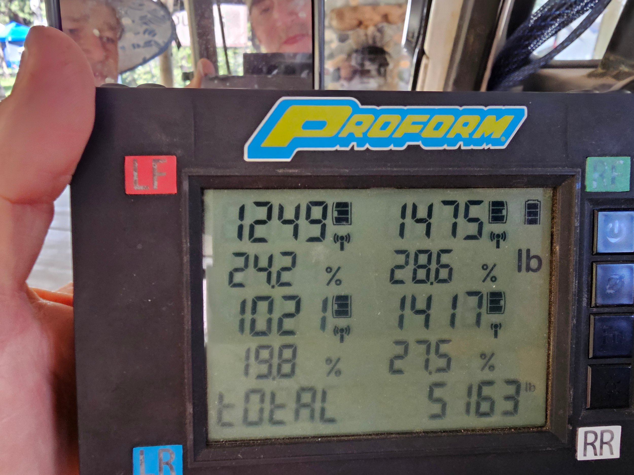

This is what my TJ weights... I've got the steel MC corners and fenders w/8" wide flares. And a UUCF 2" drop steel transmission skid & Skid Row steel engine skid.. Plus a For HP44 front and TeraLow CRD60 rear. Hemi V-8 & 545RFE transmission & STaK's 3 speed t-case so it's not a light rig period but it'd be about 200-300lbs lighter if I'd gone aluminum for some stuff. Just to add to what Tworley said above.
This was with me 185lbs in the drivers seat.

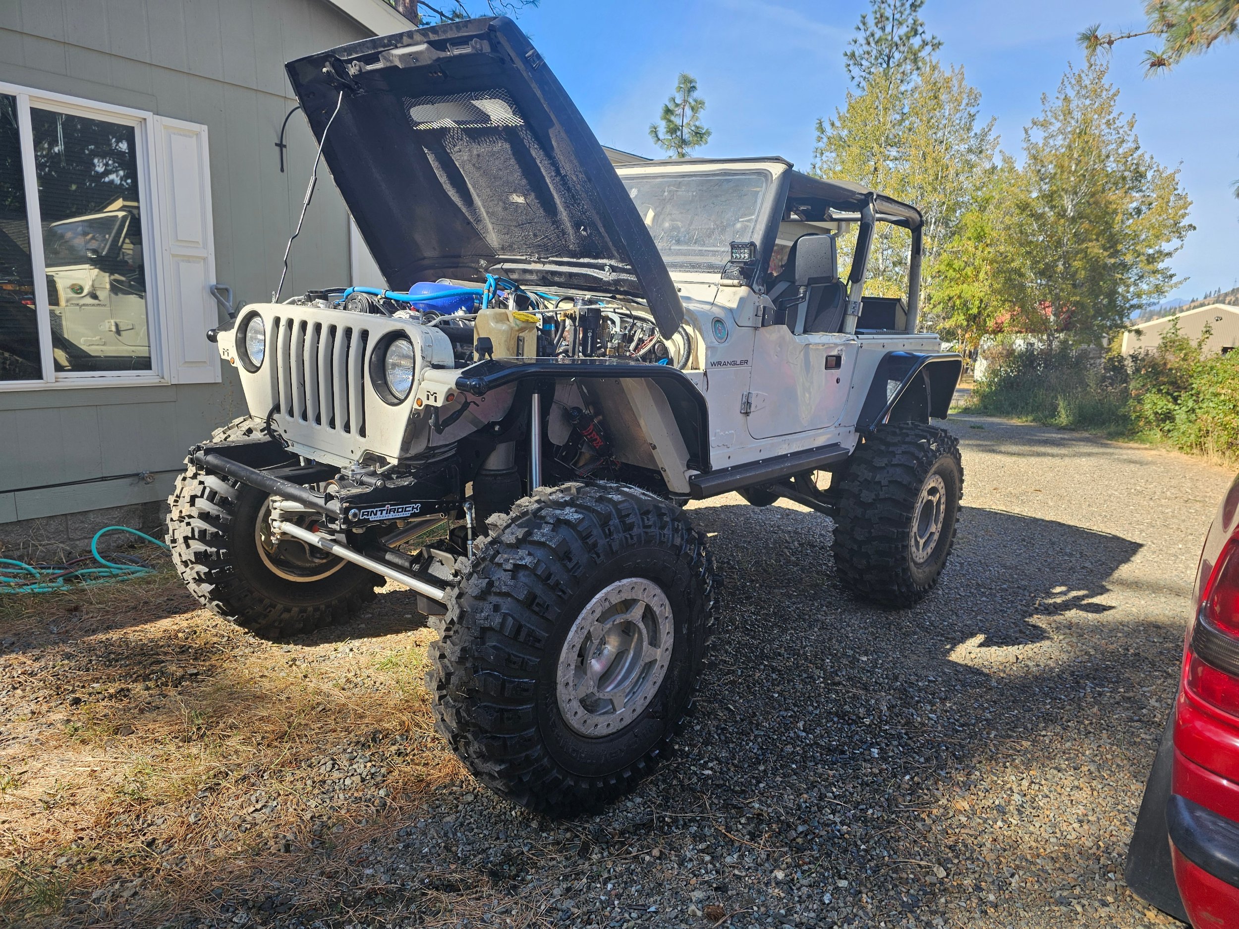

I’ve been spending weekends getting the Jeep ready for the build. Tear-down is complete, and I’m starting prep to build it back up. Plans shifted a bit—I ended up pulling the trigger on DynaTrac UD60/UD44 axles. I’ll either sell the built JK axles or run them on my other TJ (35s).
At this point, the frame is basically stripped—just the motor left, and a few brackets to remove.
Side note: there’s a special place in my vocabulary for POs who don’t keep things clean. The transfer case and trans were caked in mud and ATF (~1/8"), which has been… fun.
