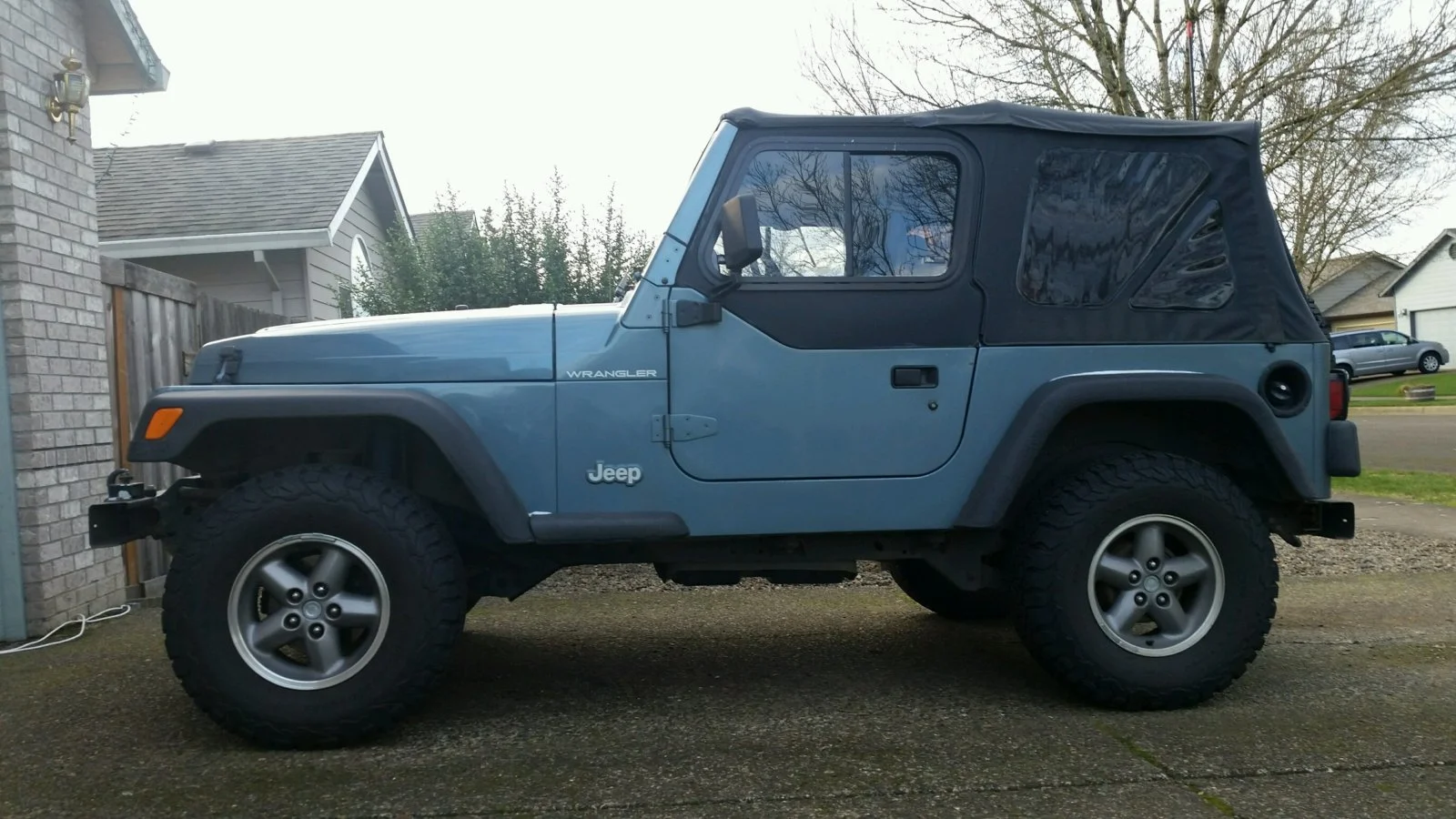

My 2cents worth:
I think that TJ's look good on small lifts, mine has a set of H&R spring that lifted it about an inch and a half, and they do really well on the street and on the trail. I also run 31" tires and the difference in appearance is noticeable. I did mine for off road performance reasons and increased capacity. Works great, but then I've got an SE and 4.10 gears.
This SE goes like stink on and off road.

H&R springs (about 1 - 1/2" of lift)
Bilstein 5100 0 -2" shocks (the valving is a good match for the trail conditions and the H&R springs)
KO2 31x10.50R15 tires on stock Grizzly wheels

That's it. That's all the mods the SE needs to get me way back into the back country and into more trouble than I can stand. Works really well in all the conditions that I've run across so far and I can keep up with most anybody around here. Skill / experience > mods

Thank you I do like the look of your jeep I'm not sure I'd get as much lift since I have aftermarket bumpers and full doors quite a bit more weight. Also what height lift should I start thinking about the adj track bar?
