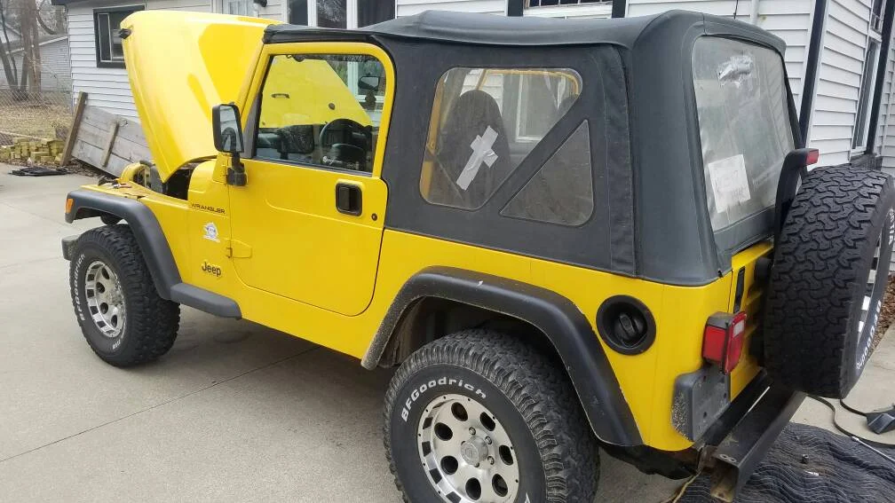

The day I bought her

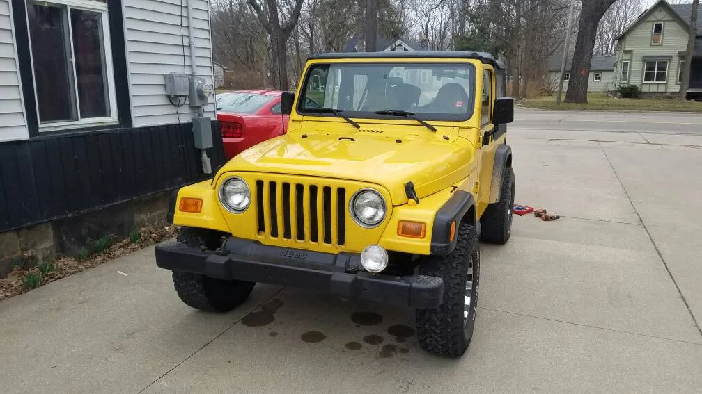

1 week of owning her
