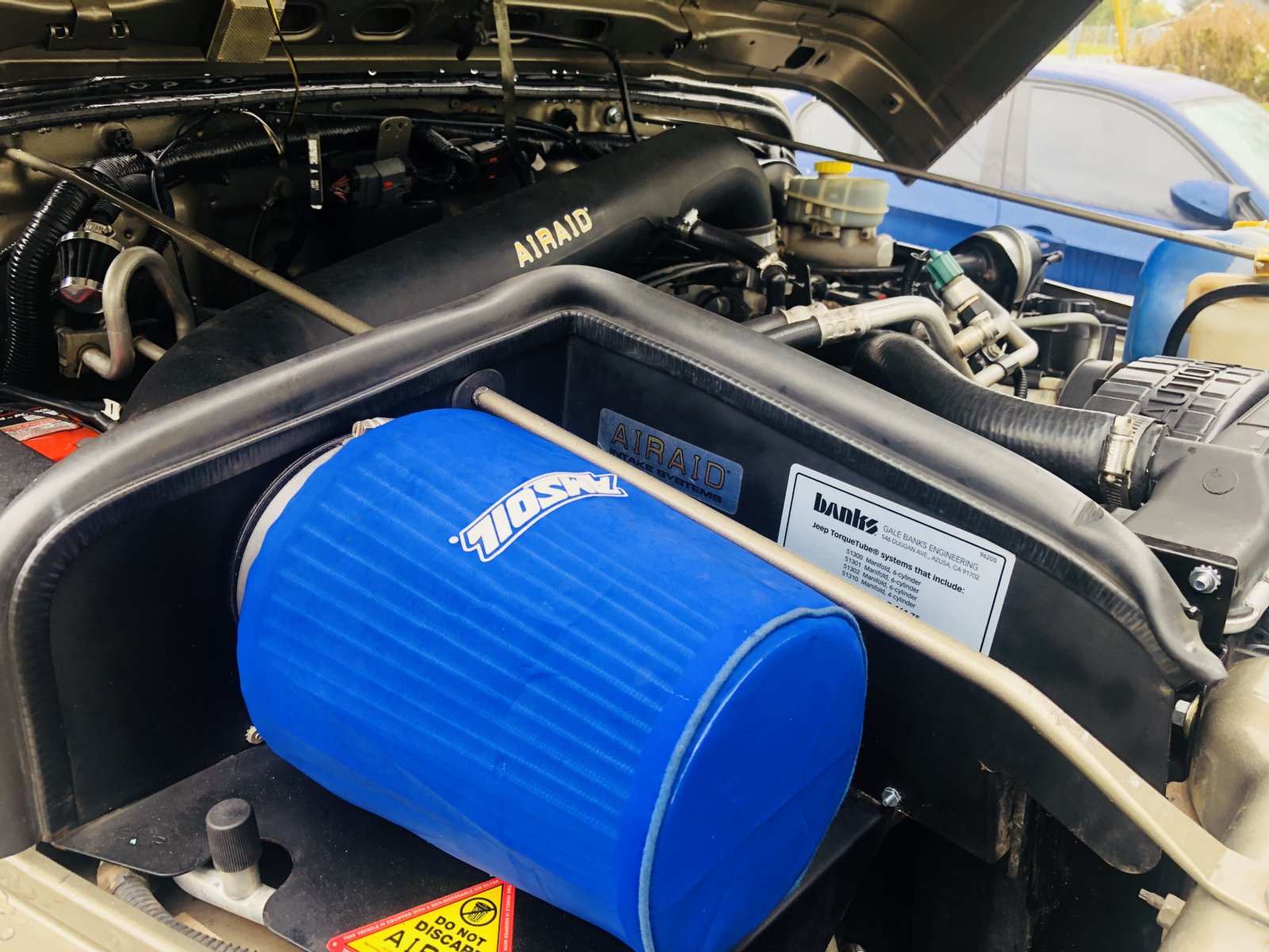

I ended up buying the replacement Amsoil Air filter (dry) and as well as their pre-filter. I looked up my airraid’s filter dimensions (base and tip diameter and the height) and chose the direct replacement off of Amsoils website.
The filter is high quality and looks to filter much better than the air raid filter, though I personally dont have any actual data to support. But just based upon my visual inspection the amsoil filter looks to be much better. I think it’ll be a good compromise compared to switching back to the stock airbox.
These are the part numbers I ordered:
1. EAAU4070 (Universal Air Induction Filter)
2. EAPF19 (Absolute Efficiency Pre-Filter)

Thanks for the info, I have both of these coming via UPS tomorrow!
Just my damned luck - their website has a bug that forces EAFP01 into the cart instead of EAFP19. Got excited when my prefilter showed up, but then saw that it was the wrong one :/

Thought I'd chime in again on this topic. I had replaced the shitty Banks Airaid filter with both of the above, keeping the Bank intake tube in place. My oil is PRISTINE now, before I swapped the original filter out my oil would be nasty after 1K miles. Now, after ~2500 miles or so, it is still hard to make out the oil levels on the dipstick. This setup work tremendously!
