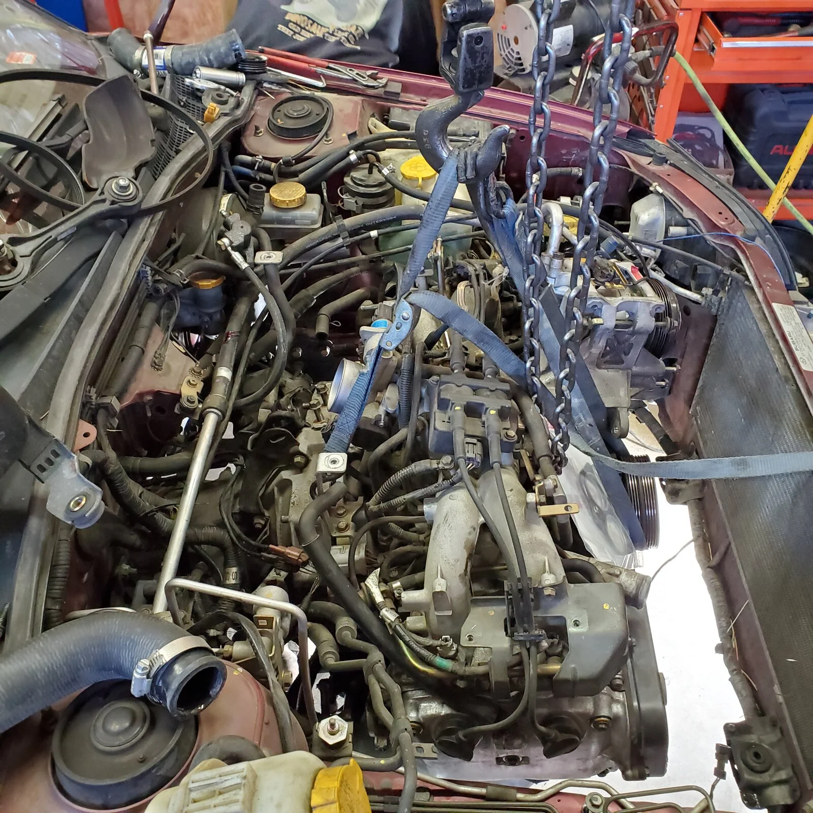

Engine is back in and it's going together. Neighbor is stopping around 1 PM to watch the Sea Chickens play.
Engine is back in and everything is all hooked up and we've ran it once to let it get warm and get the initial filling of the coolant & power steering. Tomorrow in the morning before I head to my VA appointment I'll help him put the hood on. Then he'll take it out for a test drive and check stuff. Then it'll be all done for a while. Hopefully we got all the leaks fixed.

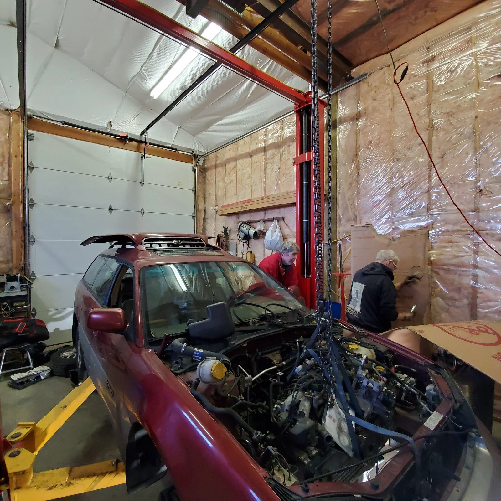

Man I am so jealous of my neighbors shop. He's a retired mechanic who is staying busy by doing odd jobs like this and other stuff. He use to race motocross when he was younger and had a nice collection of Ducti & Bultaco bikes. Plus a bunch I couldn't tell you what they were.
The 2 post lift is a great feature. He's been building a house also during all this and had converted the loft area as a living space while he is building his house.

What kind of hoist is that in there? Is it like a gantry system where it can slide forward and backward?
Just your standard 2 post car lift with the arms that swing out. But it's a heavy duty one I think rated for 9K lbs but I'll have to look again next time I'm down there. The shop was there when he bought the property. The house that use to go with the shop was burnt down during the Taylor Bridge fire in 2013. The neighbor didn't buy the property until 2018 and the previous owner left equipment in the shop. I'd Love to have that shop on my property.
There is also an overhead chain hoist that rolls front to back and side to side.

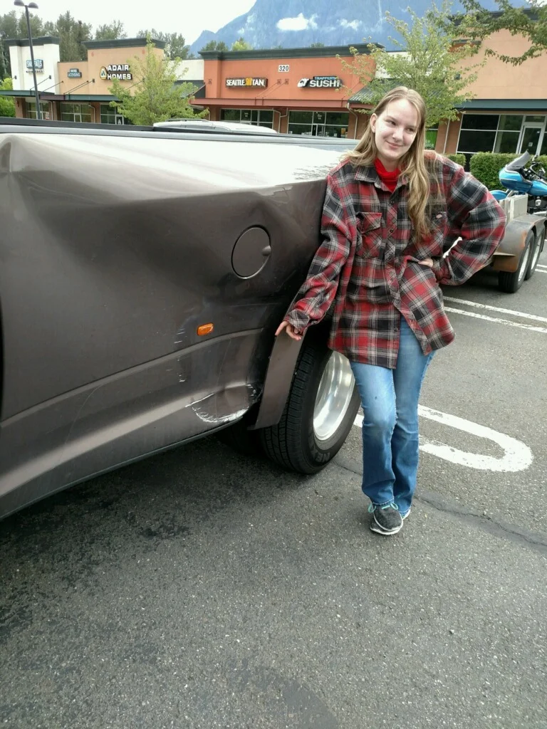

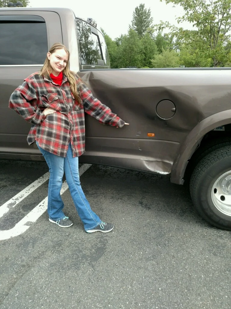

It was her first time driving the truck alone and I was picking up my Harley from a buddies house that I loaned it to when I couldn't ride it. So the bike needed fuel so I'd pulled into the AM/PM and was on the left side of the pumps. She'd pulled up behind me and I told her she needed to pull around to the right side of the pumps to fuel up.
I'd just gotten the nozzle into the tank on my bike when I hear this loud CRASH. I walked around to the other side of the other side of the pumps and see my BRAND NEW TRUCK less than 5K miles on it with the bed caved in. She'd hit the cement posts that protect the pumps.
I didn't lose my cool or anything. Just walked over and told her to back up. Got the truck where it could pull up to the pump and went back to my bike.
