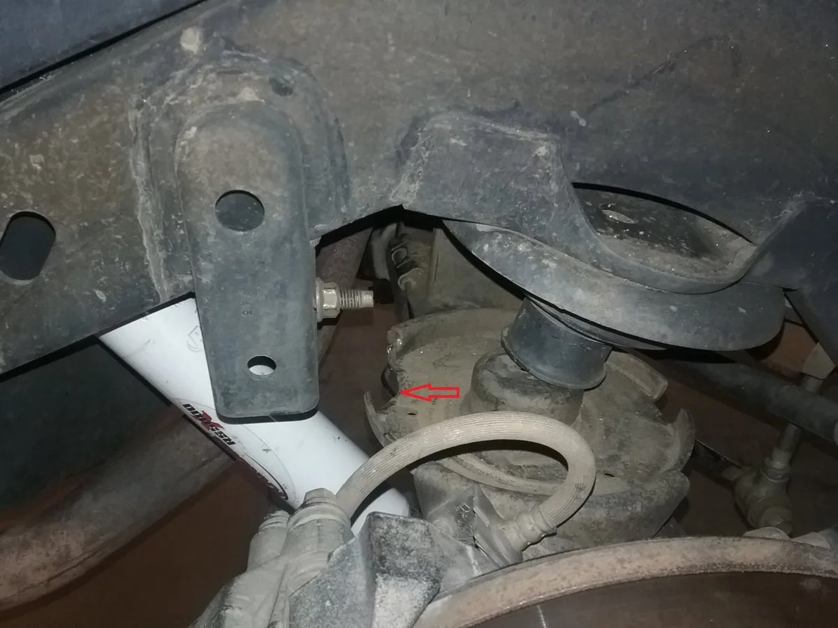

The flip won’t solve what the real issue is. The way to fix it is cycle the suspension with the shock on and cut the bottom spring perch where it hits. The second best option is to reweld the shock mount where it doesn’t contact. The third best option is to buy a shock relocation bracket from someone like Currie. I’ll attach a picture of the notch needed.
The flip won’t solve what the real issue is. The way to fix it is cycle the suspension with the shock on and cut the bottom spring perch where it hits. The second best option is to reweld the shock mount where it doesn’t contact. The third best option is to buy a shock relocation bracket from someone like Currie. I’ll attach a picture of the notch needed. View attachment 157721
