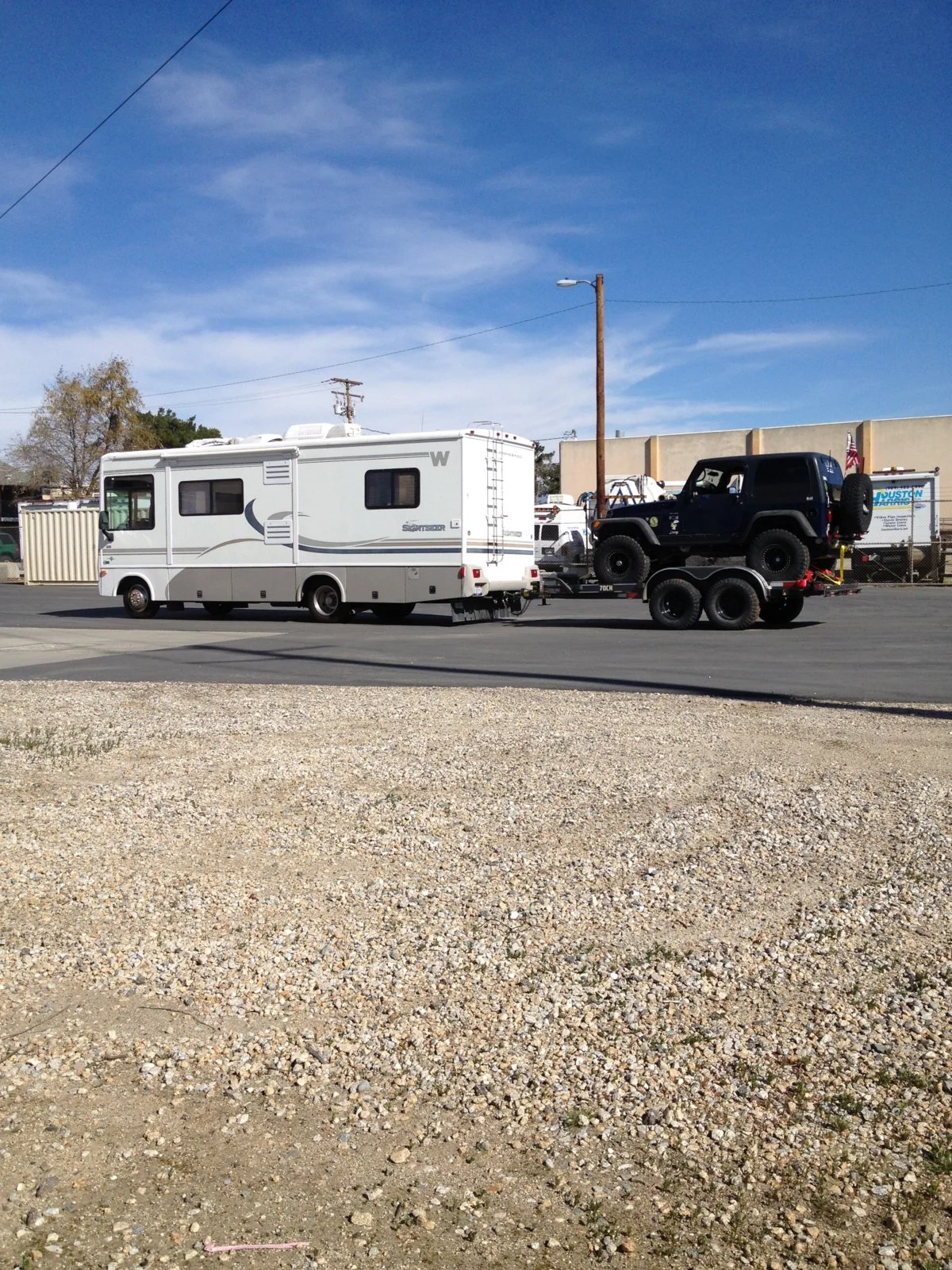

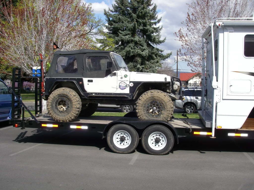

This isn't what you are looking for as far as a trailer but here is my TJ loaded on my RNTH (Red Neck Toy Hauler) with 17' of deck behind the camper.

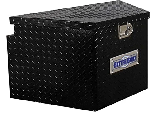

You can also put a trailer tongue box on it for your straps and stuff.

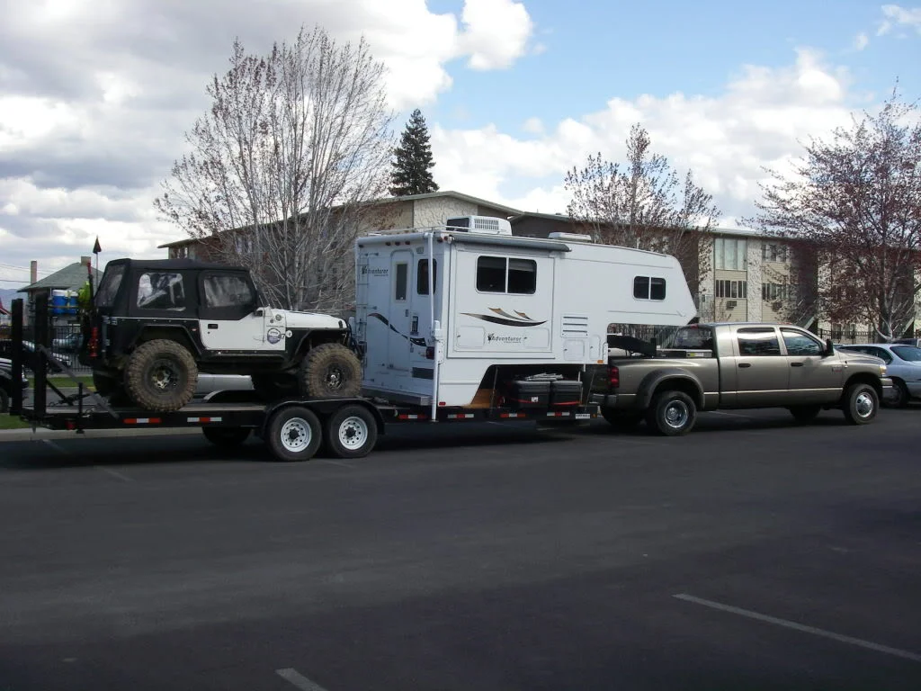

Yep, that's what I did. 13' deck, 20" high front wall, 16" high side walls, drive over wheel wells inside the walls, one piece tail gate, axles where I wanted them for the correct tongue weight, 50 gallon water tank between the axles, and tire storage up front for a pair of spare tires. It is probably 17' ball to end of gate folded up. I built assist springs in tubes to help the gate up so you can lift it easily with one hand.

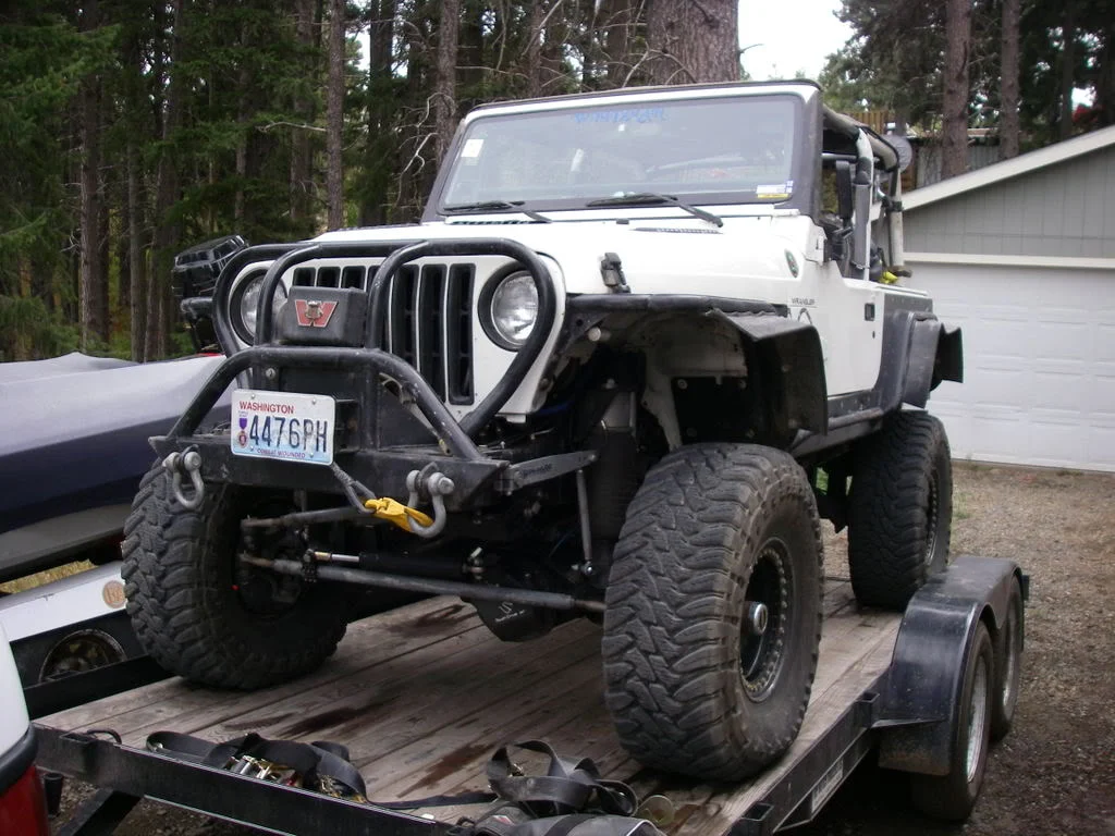

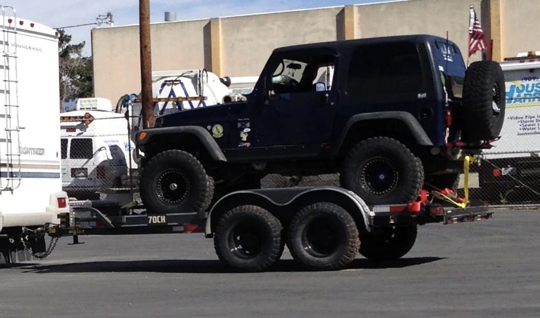

This is what my TJ looks like on my 14' Big Tex, 70CH. The 17' overall length of the trailer (ball to back) fits in my 12'x50' storage spot when it's connected to the 31' Moho.
There is still about 2' of room ahead of the front tires to tie down four 5gal. gas cans and four 6gal. water cans.

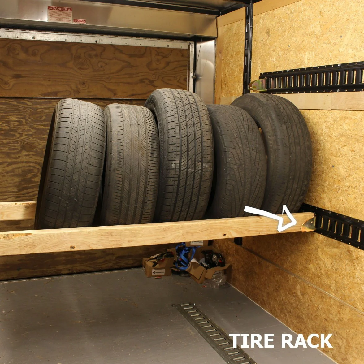

I understand longer is better but considering storage space and fuel economy when towing 1200 miles the shorter trailer makes sense. Tie down using e track similar to the picture attached except with the ratchet under the belly of the Jeep as there won’t be excess space on the ends of Jeep.
Sole purpose of this trailer is to tow the Jeep so other uses aren’t an issue.

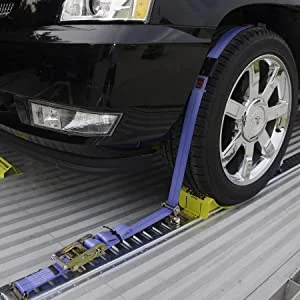

I don't have any experience with the eTrack system but, it looks to use the weight of the vehicle to help tie it down to the trailer.
Rather than using straps to "pull" the axles away from each other.
Someone can /should explain better than me.

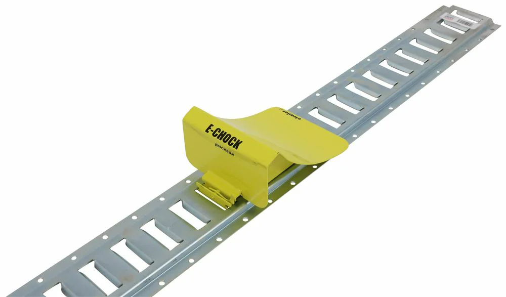

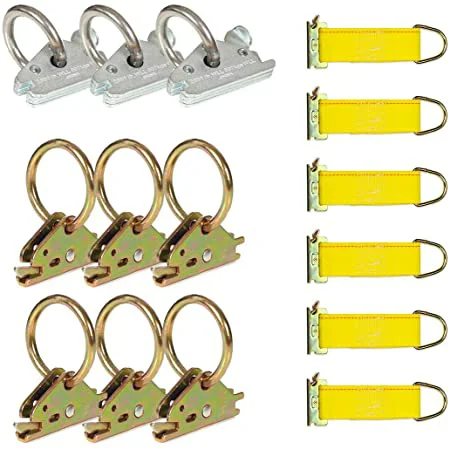

E-track has hundreds of different strap and attachments that fit in the slots.
So you can get a dozen different kinds of rings for tie down points, straps that fasten straight to the track, 2x4 post/beam mounts, chain connectors, wheel straps, secure wheel chocks, etc.
The Ford Boxlink used in their pickup trucks is literally just a single E-track mount.
