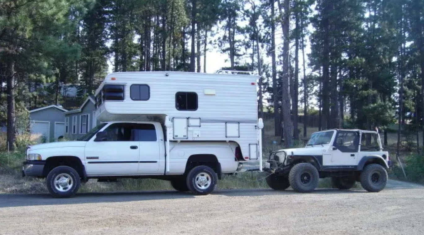

I have done both, and I greatly prefer flat towing over trailering. It's much easier to hook up and get on the road vs a trailer that has straps and ramps etc. I have the Stowmaster flat tow system, and I can be hooked up and ready to roll in under 5 minutes. The trailer pulls a lot harder and is noticeable when going down the road. Flat towing I almost forget it's back there. As already stated, you can't back up with a flat tow. If you are completely strait, you can get back a little, but if it's turned at all you bind up quick, vs a trailer you can maneuver much easier backing up. I may also be a bit salty on trailering after going through 4 tires, 2 bearings and an axle this year on my tandem trailer. Most tandems are junk IMO, and the geometry is crap. Also, 3500lb axles don't belong on most car trailers hauling anything more than a small car. You could drop the flat tow mounts on your Jeep as well to make it line up better.

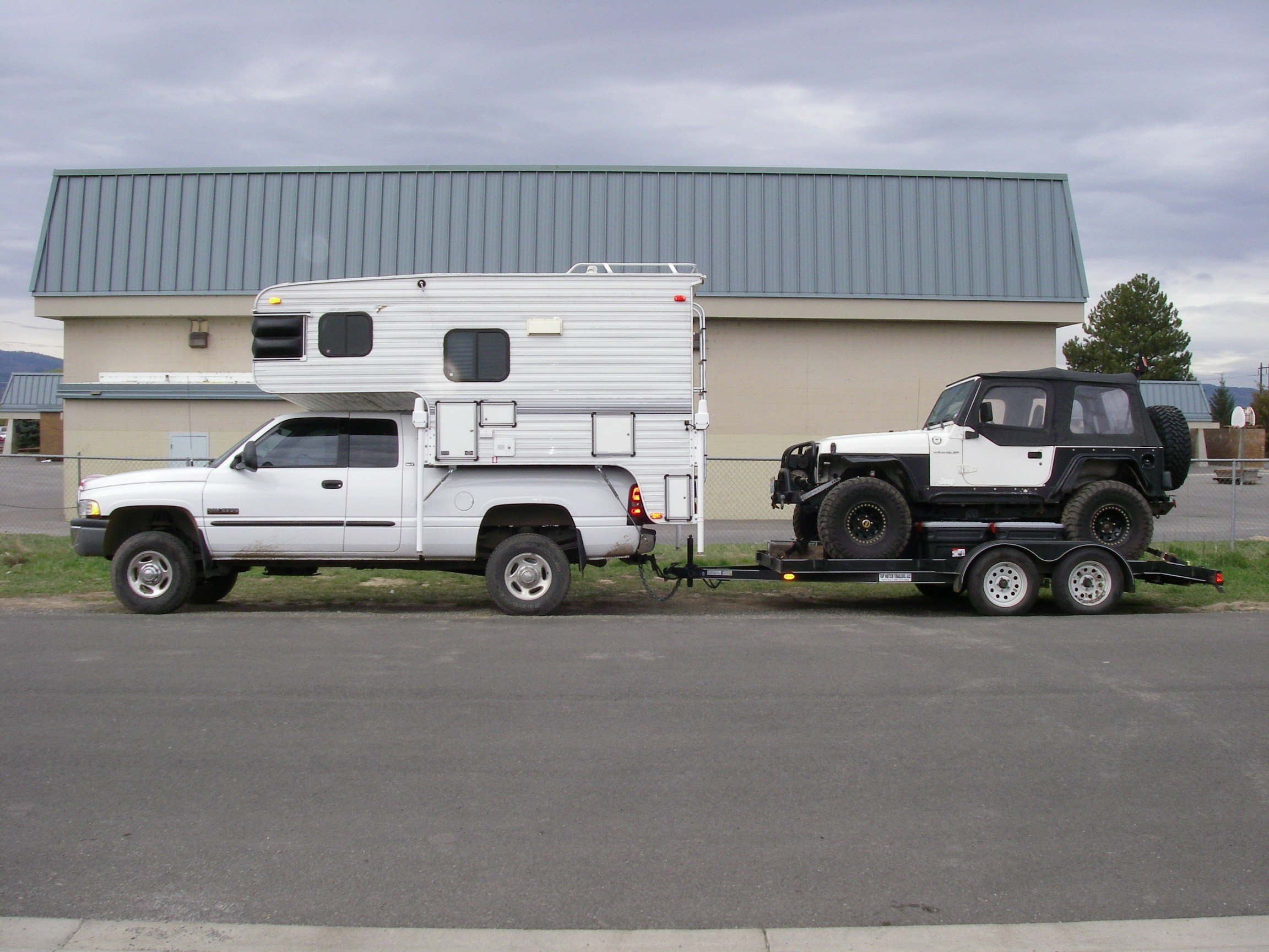

tandem 3500 axles means a 7k trailer, most would recommend a 10k trailer as it will last longer. You'd be at a lower percentage of max weight on the trailer and your tires/bearings will last much longer.

And... you can't flat tow if you tear off your axle on trail, or have some other types of catastrophic damage. I prefer to get it home no matter what I break :)

I've had this trailer since 2007 & the decking on it was never treated or anything and it's just now gotten to the point where it's about time to replace. I've only had the brakes/bearings serviced once since 2007. 2-3 times a year I'll squirt some grease into the Bearing Buddy's. It's only 14' long so about the only thing that will fit is a Jeep or SXS. It tows GREAT behind everything I've towed it with. Might just be I got lucky.
