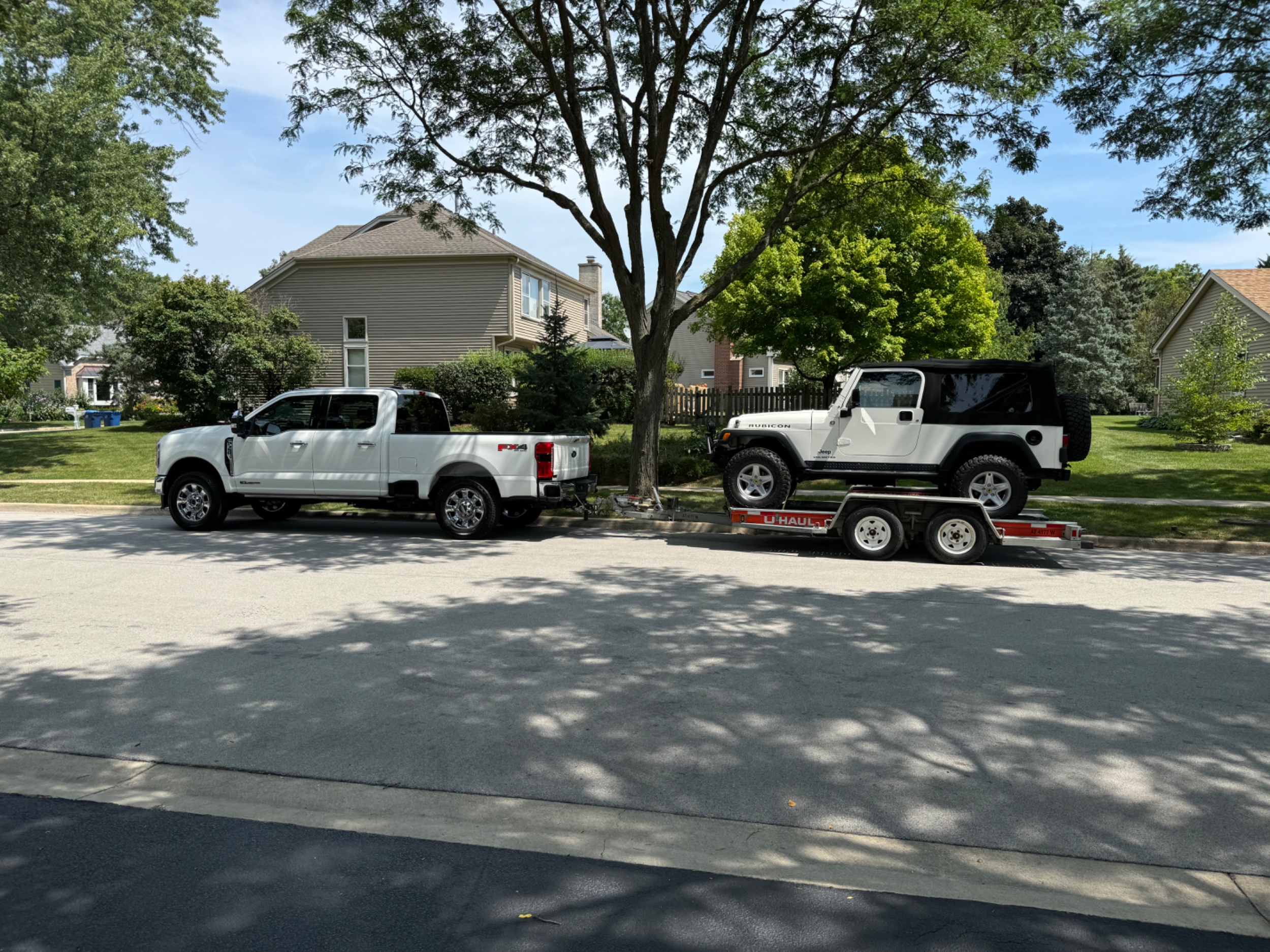

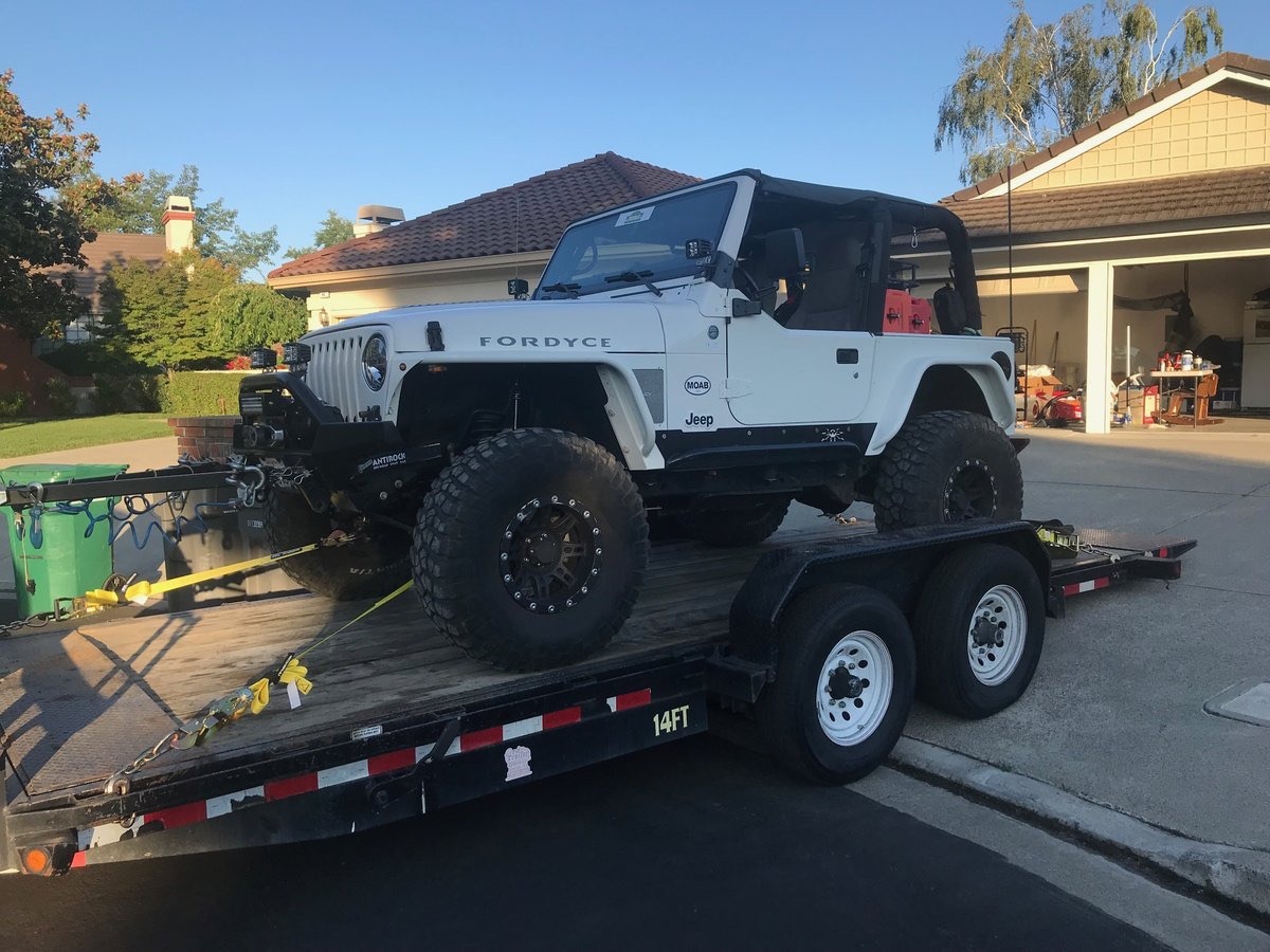

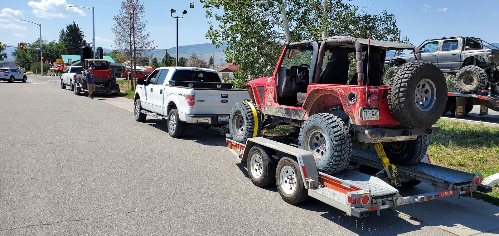

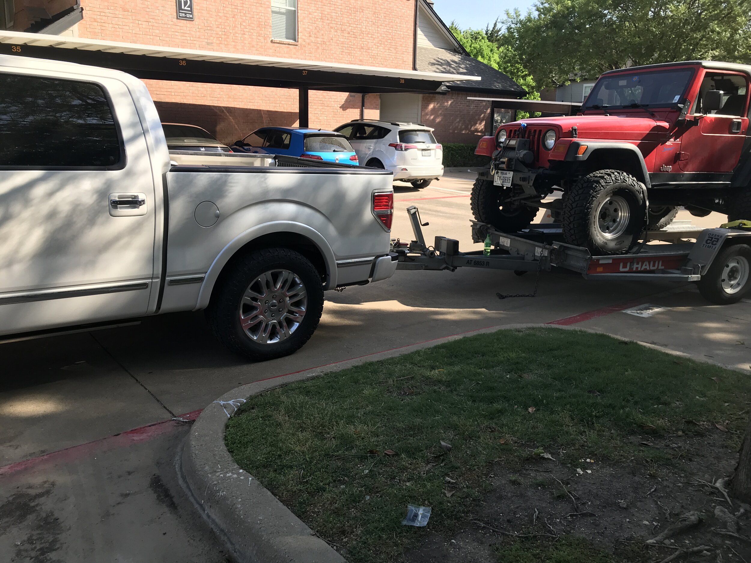

In doing a bit more research, it appears the TJ has a pretty close F/R weight bias, so I don't know that backing it on would have made much of a difference in reality.
I'm not saying back it on, i'm saying secure it about 18" further to the rear, which would put the weight much closer to the trailer axles, thereby taking the weight off the tongue somewhat.
