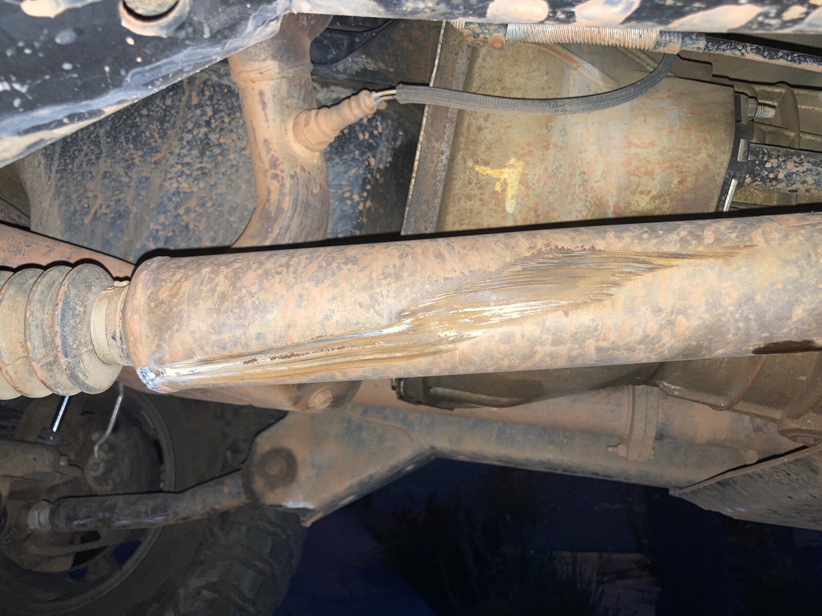

Is that control arm supposed to have a bend? Or is that more carnage?Anyone parting a new 231 driveshaft lol? TOTW trail did this, vibes over 30 mph nowView attachment 248629
Surprisingly enough, its supposed to be like that. Those are the Core 4x4 T1 lowers with the 10$ poly bushing upgrade lol. Theyre temporaryIs that control arm supposed to have a bend? Or is that more carnage?
I think I have a spare you can have.Anyone parting a new 231 driveshaft lol? TOTW trail did this, vibes over 30 mph nowView attachment 248629

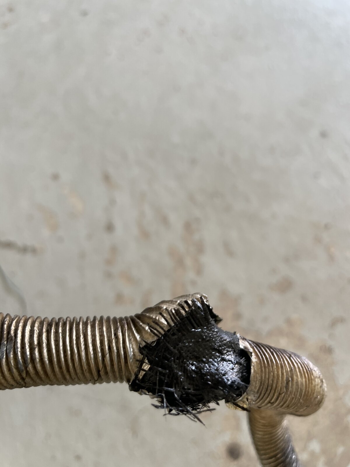

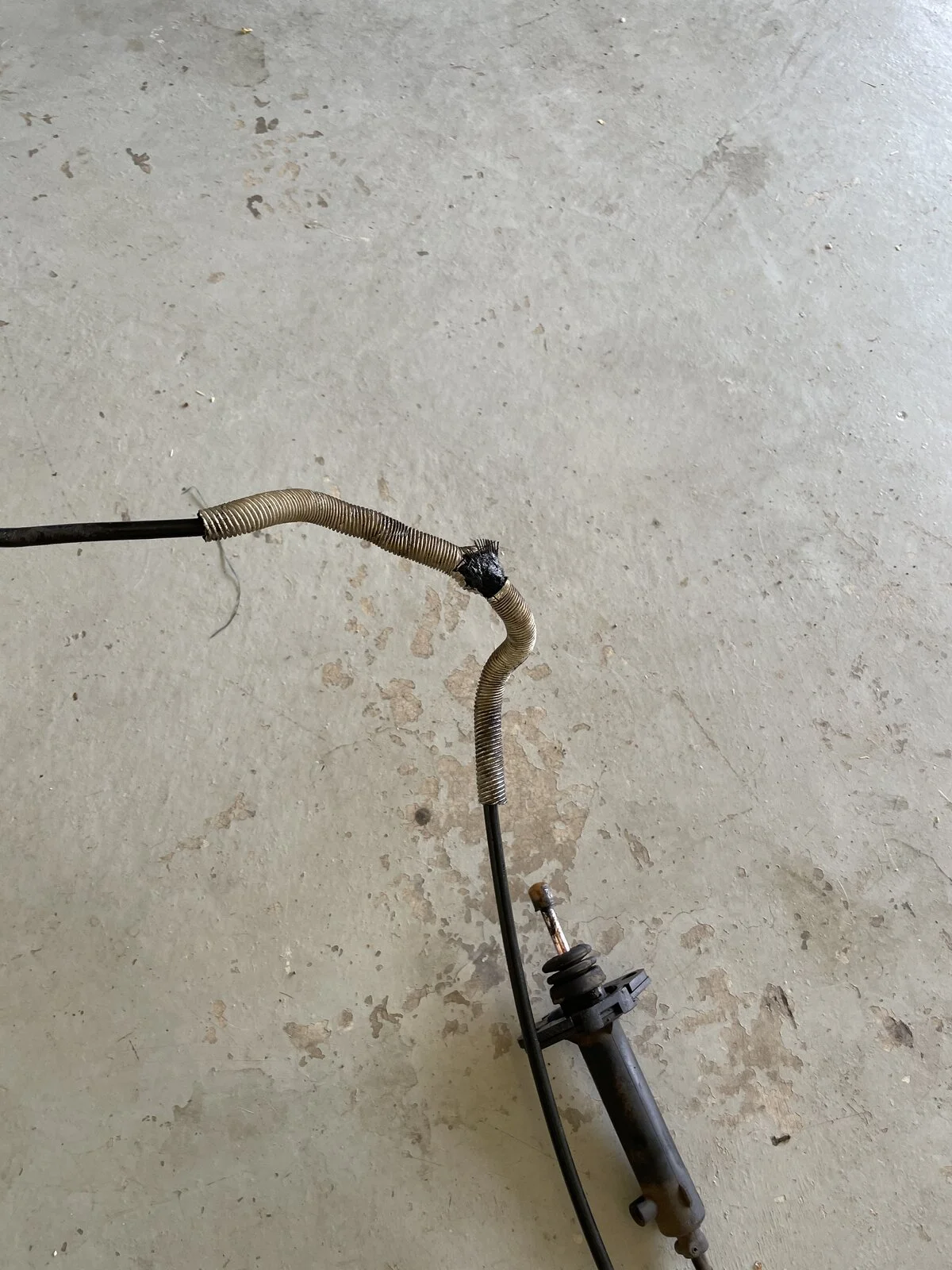

Heat shield failure led to bubble in the fluid line? I've seen that on the auto trans shifter cable but not on a clutch fluid line.Clutch update, replaced the master and slave with a prefilled assembly View attachment 249029View attachment 249030View attachment 249031

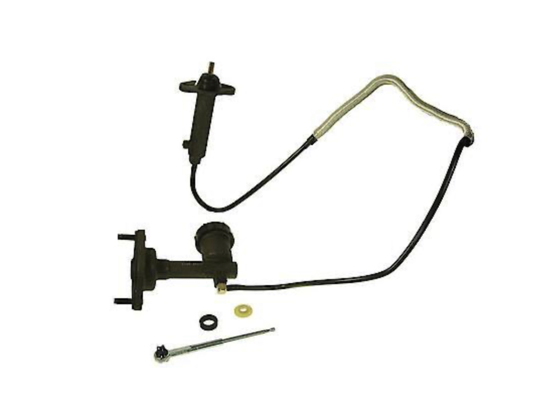

Agreed, Pretty unusual for sure, there are closer places than that to the exhaust and the pinch seam clip that holds it was still connected so it must have got nicked by a branch or brush in the past. There’s worse places it could have failed like 202 yds further down the trail.Heat shield failure led to bubble in the fluid line? I've seen that on the auto trans shifter cable but not on a clutch fluid line.
We have had to use the 32 RH shifter cable on AW-4 swaps because they have a small bit of heat shield. Amazing what a little bit of aluminum crinkle tube can do.Agreed, Pretty unusual for sure, there are closer places than that to the exhaust and the pinch seam clip that holds it was still connected so it must have got nicked by a branch or brush in the past. There’s worse places it could have failed like 202 yds further up the trail.
