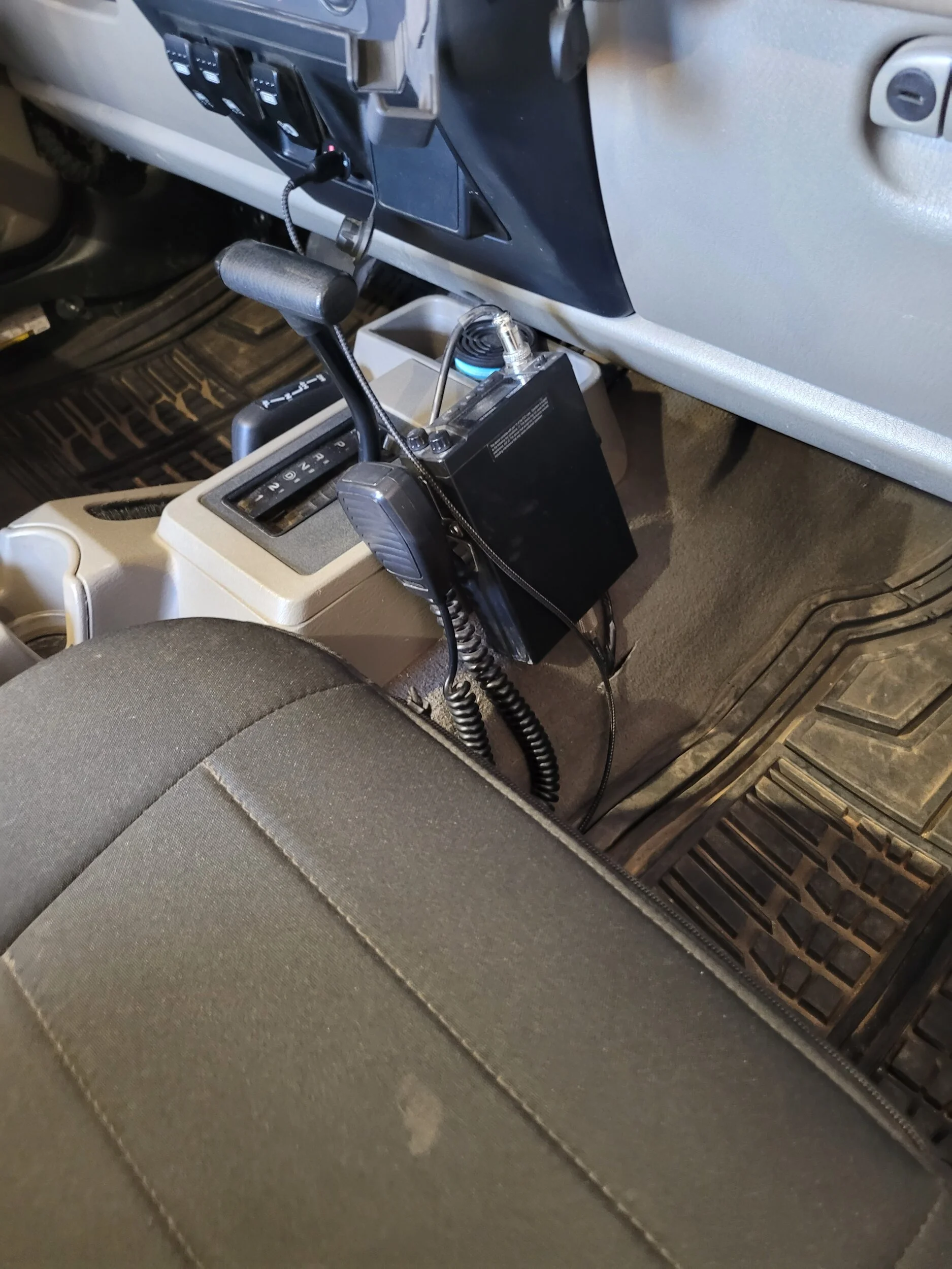

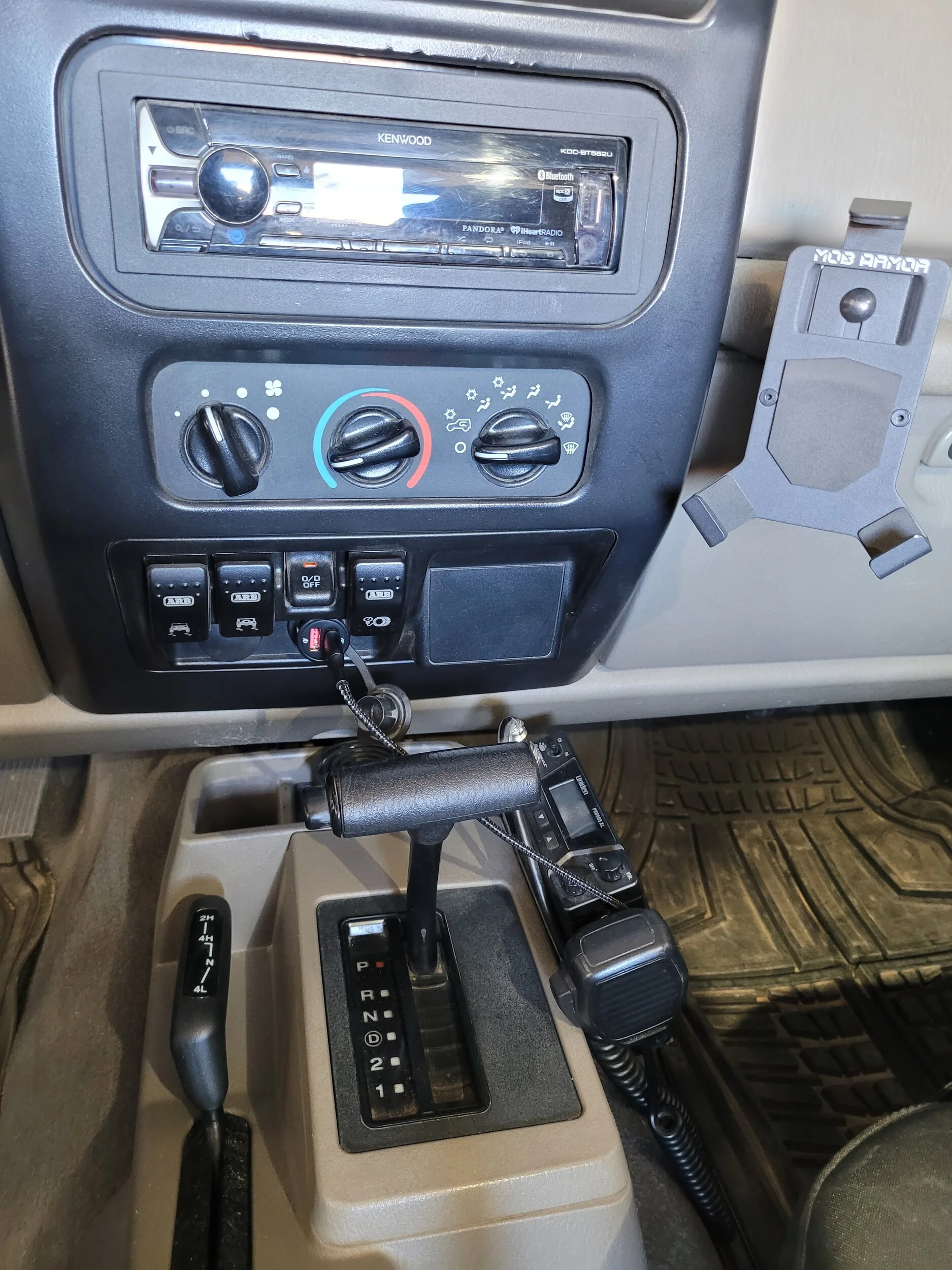

I just used a midland portable unit and just hook it up for events. You just run the antenna and wire inside. The plug just lives near the front of the center console. Range works well enough for the groups.
Midland 75-822 40 Channel CB-Way Radio https://www.amazon.com/dp/B00000K2YR?tag=wranglerorg-20
I went this route because most places/groups are transitioning to gmrs. I keep a gmrs handheld in the jeep too.

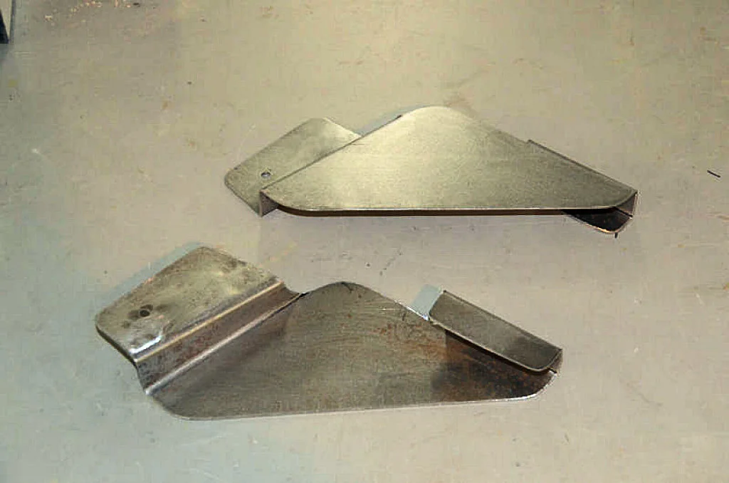

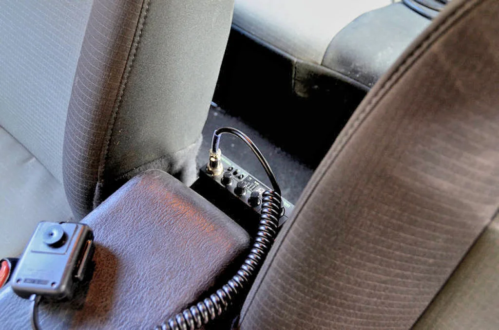

Because I use my CB in both of my 06's, and only use it occasionally, I wanted to be able to mount it in either Jeep whenever I needed it so I designed a no-drill mount that installs in a minute.
The radio sits behind the center console; it's adjustable for angle and there's room between the console and the radio to stash the mic.

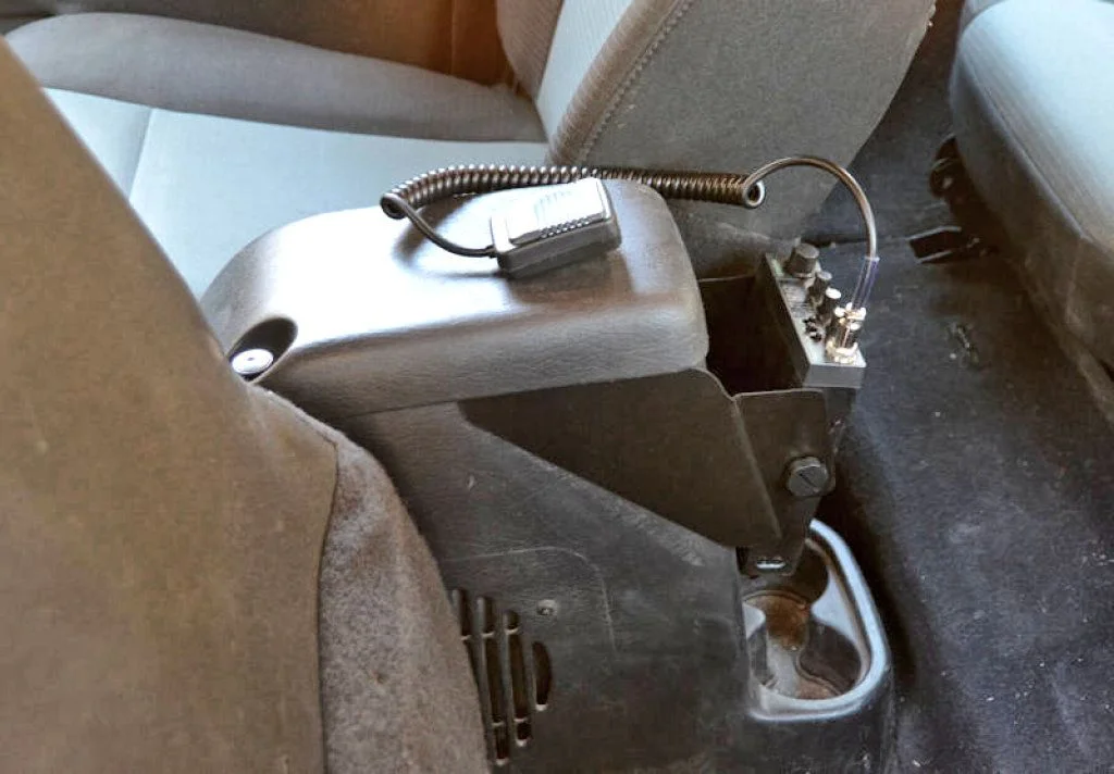

Side view:

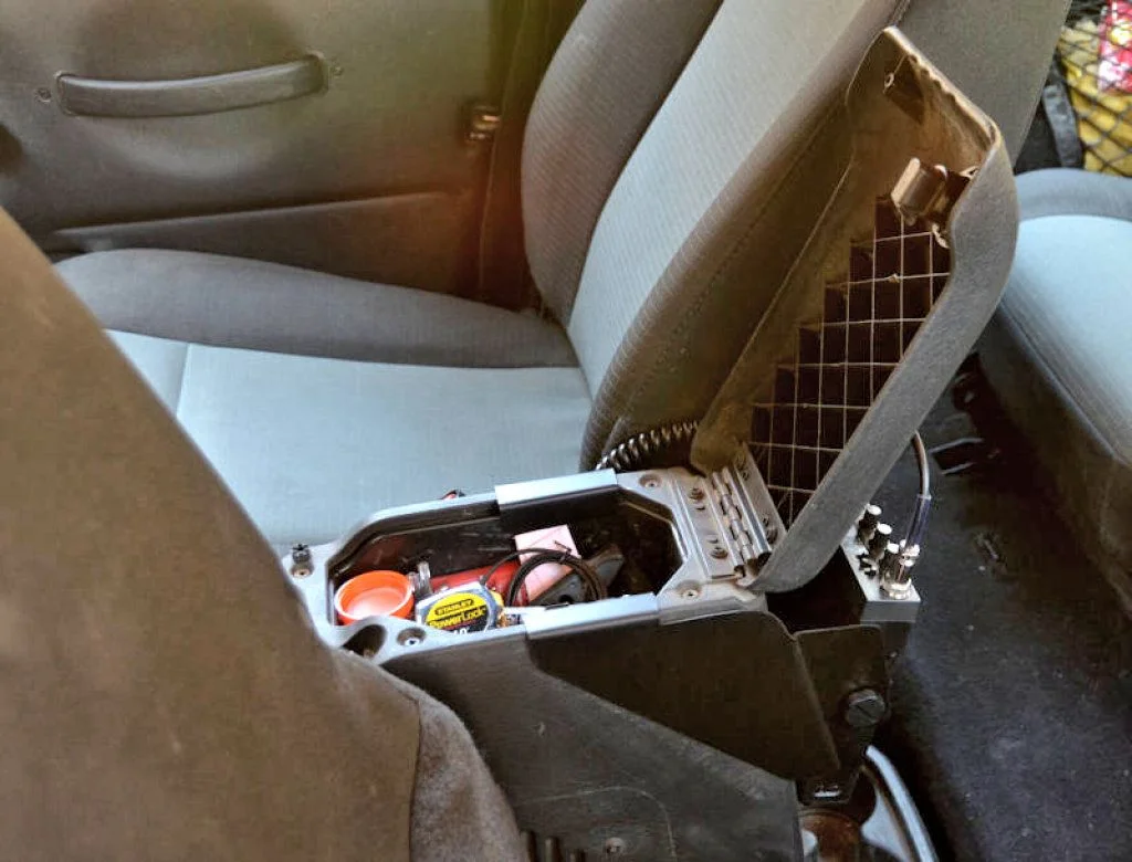

To install it, open the console lid, hook the bracket over the sides of the console, shut the lid and attach the CB to the brackets using the thumbscrews that came with the CB. Installs in a minute and I can swap it between Jeeps easily. You can see in this photo how the brackets hook over the sides of the console:
These are the brackets before painting. They're designed for the width of my CB but could easily be made for other size CBs.
