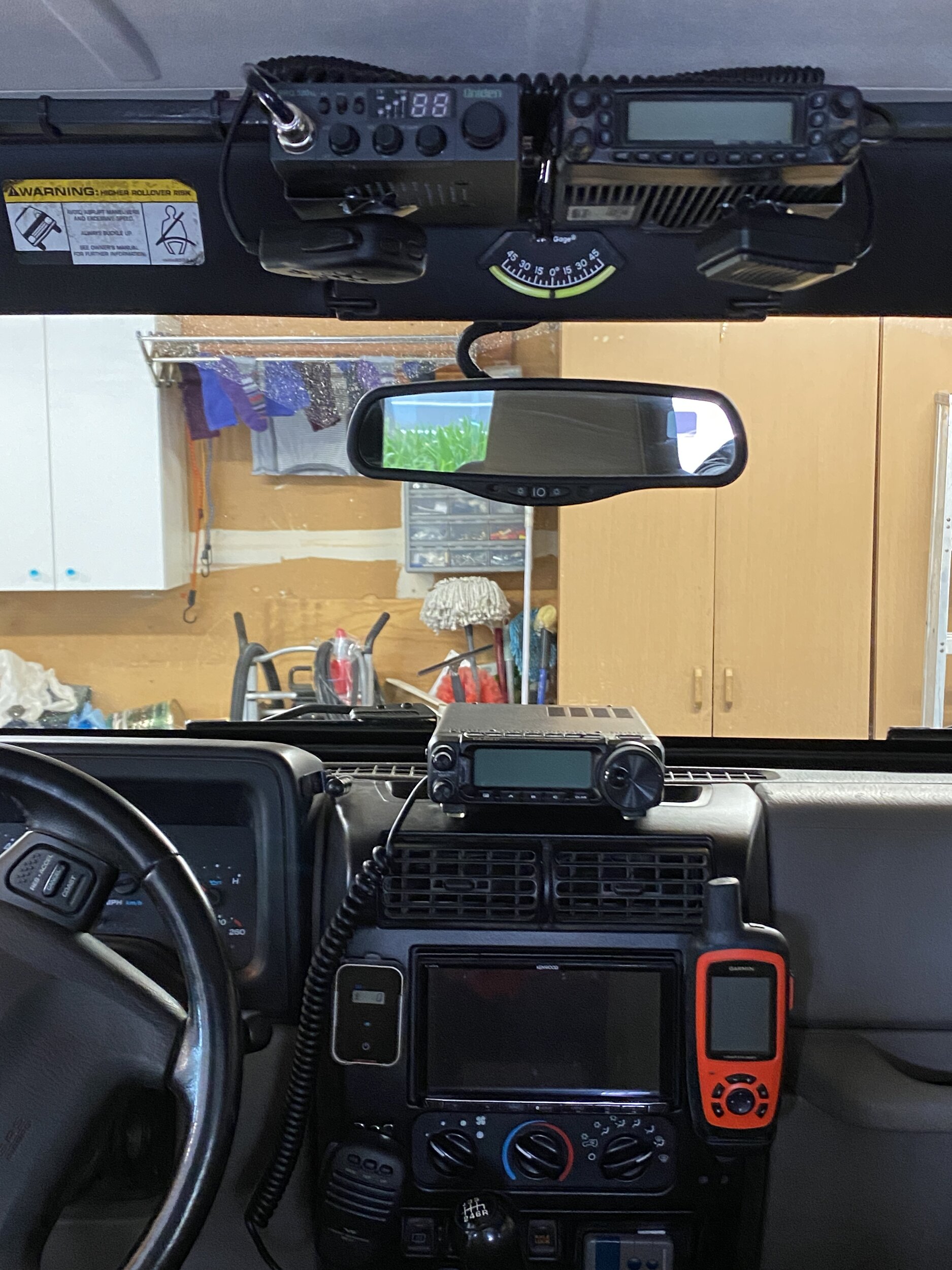

CB in the dash, GMRS and Ham on the overhead Arizona Rocky Road bar.

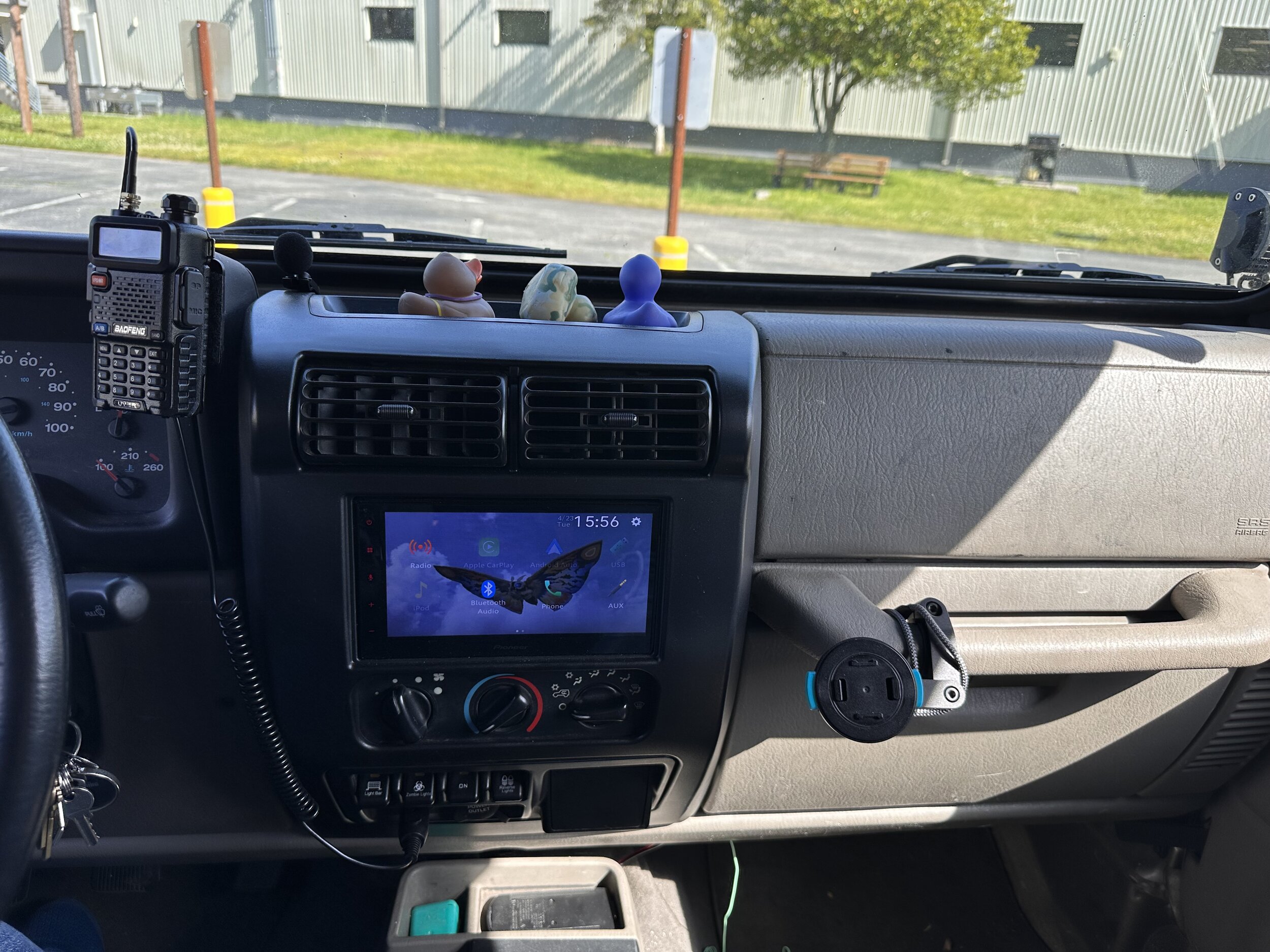

I don’t use CB, GMRS is all we use out here… in the TJ I just use a UV-5R as radio. I just use a bracket mounted to instrument bezel. I have a 12 battery adaptor, and a handheld mic/speaker for it.

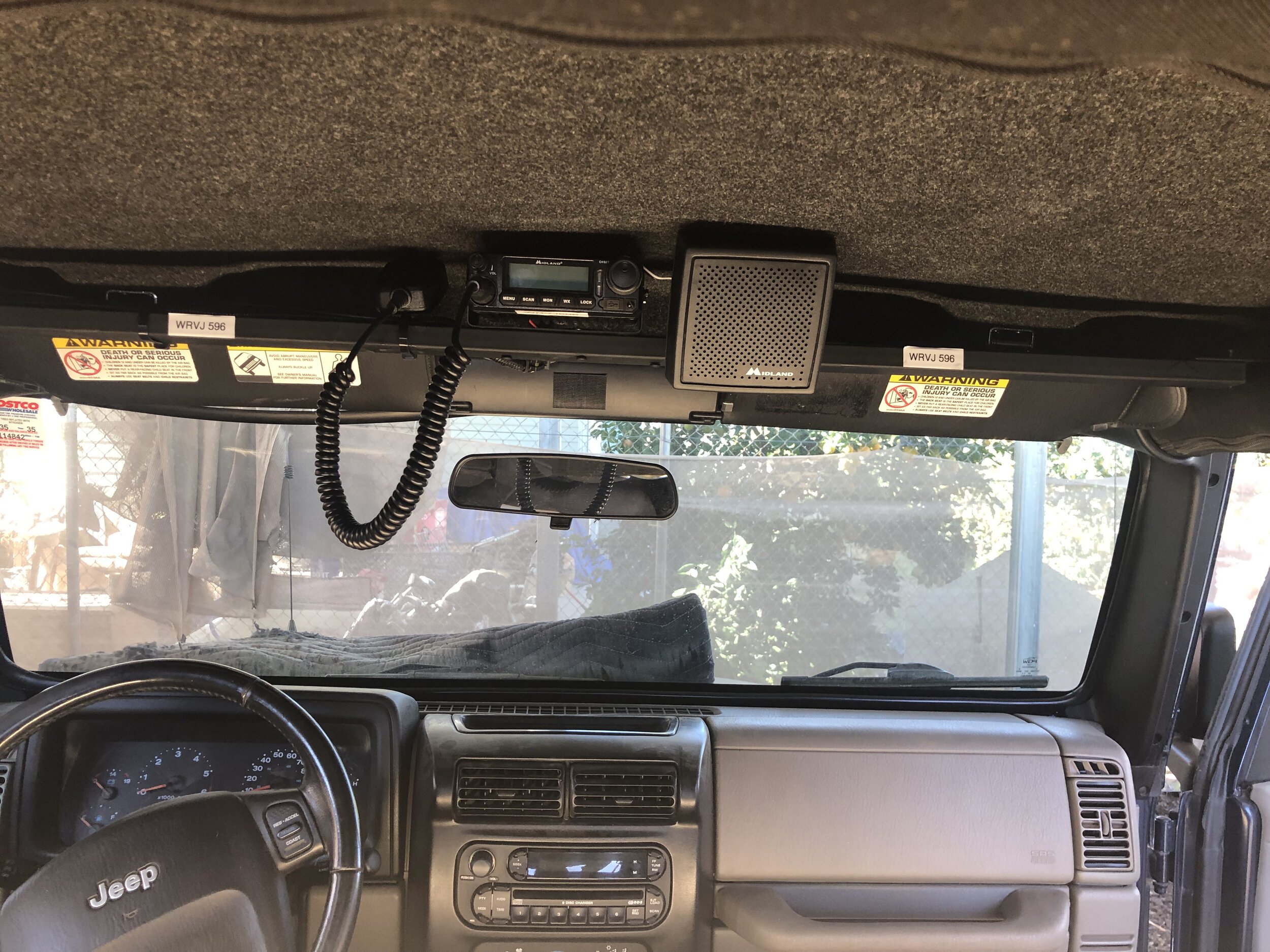

I mounted my gmrs on a Az Rocky Road bar above the mirror. I did this because I have hearing difficulties and added an external speaker. Mines 50watts so I wired directly to the battery. On the plus side it’s easy for the front and rear passengers to access it. The con is the mic cord hangs down in your view. I have a retractable lanyard for the mike. When not in use I tuck the cord above the bar.

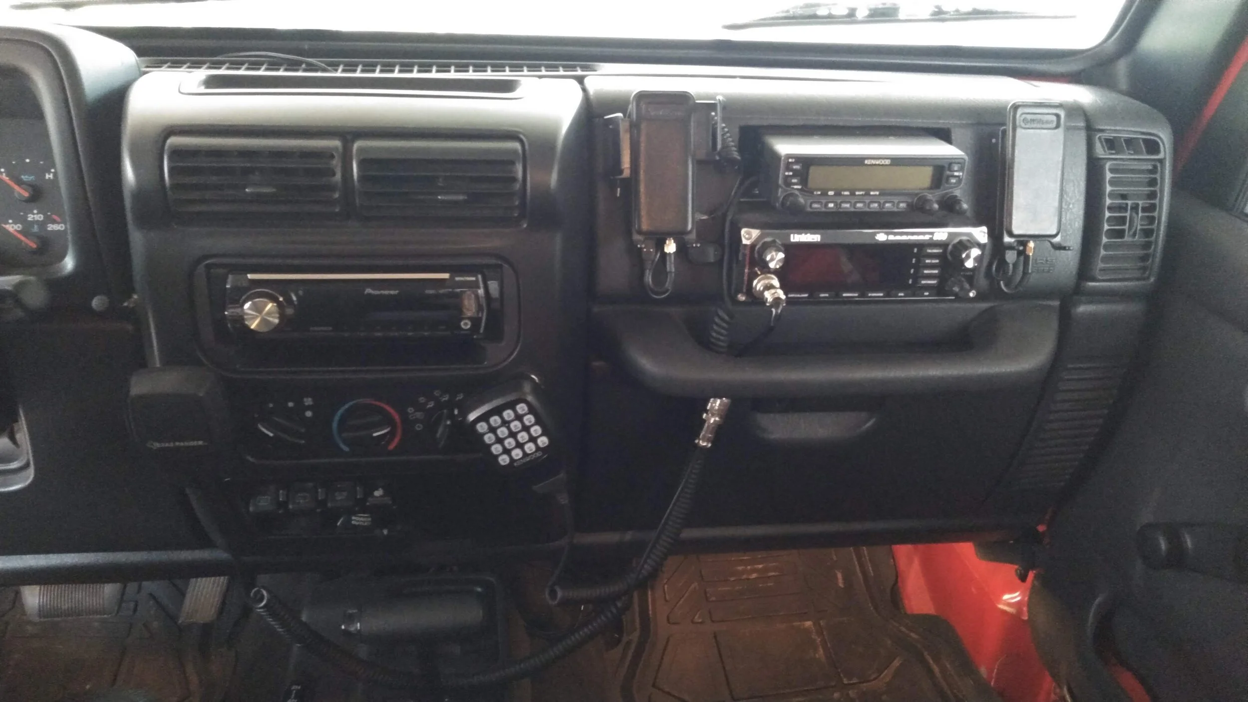

I removed the passenger airbag . We use magnets for mic holders . The hole around the Ham/GMRS is a little big because it was for an older radio before upgrading to the smaller dual band unit . The Wilson Sleek phone cradles are now obsolete , so I found the Phone Buddies to hold on to our phones for us . The antennas that were attached to the Wilson Sleeks now attach to a Cradle Point modem/router for onboard WiFi .

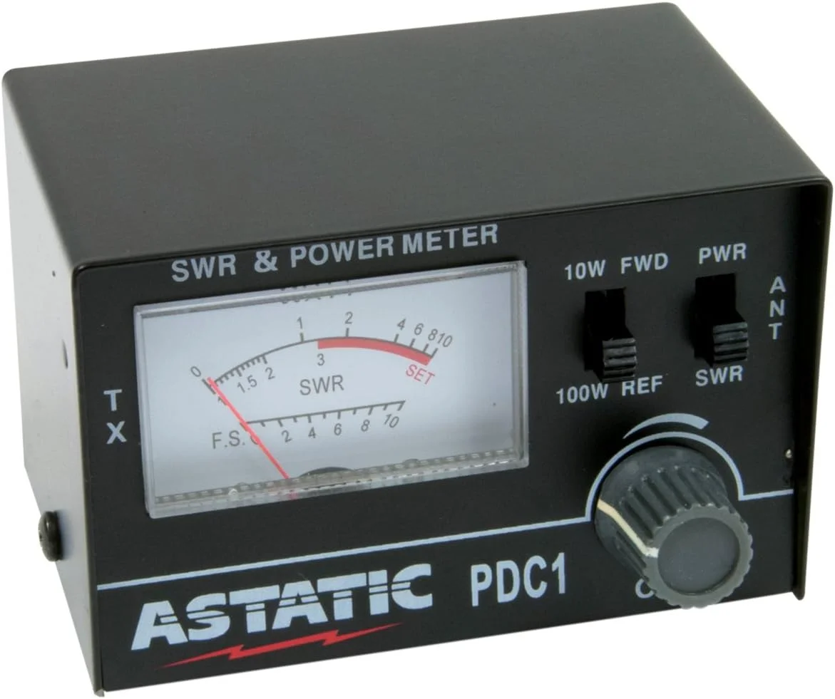

Get a good one, a cheap ass meter is just that: cheap.
One one these will work just fine. However, before you buy an SWR meter, be sure that the magnetic antenna you purchased can be tuned. Most can by removing and trimming the whip.
$21 on Amazon. Available at any well stocked truck stop.
