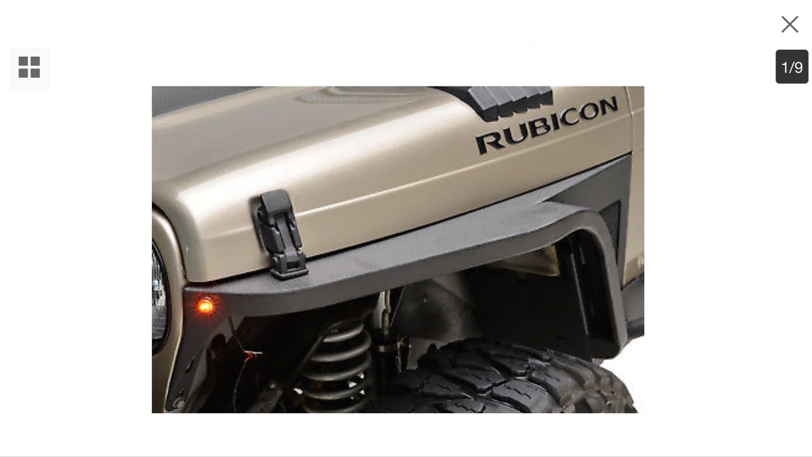

Looking at getting fenders finally. Really like the look of these hoodline tube fenders with a 3” flare. The only issue is that they can’t be ordered bare metal and I know the “powder coat” is cheap and will flake/rust. I want to remove it and paint them correctly. I know chemical solvents don’t usually work on real powder coats but something tells me the Chinese smittybilt-type products aren’t baked on or at least not prepped well. Would aircraft remover work? I would prefer not to have to send them to a shop to sandblast as it will likely be $300+ just to get them blasted clean.

Funny you post these fenders, because I found them on Amazon a day AFTER ordering a set of bare JCR’s. Though Im not quite sure how stout they are, I really like the way they look and for the price, they can’t be beat! Plus, I have no intentions of bashing my fenders around while wheeling....but one never knows.
I’d wait and see how the finish is when the arrive. And by all means, do post a pic when you finish installing!

Where are the smittybilt hoodlines on Amazon. I can find several other models, but not the hoodlines.
I've never had good luck with aircraft stripper and powdercoat. Your best be is mechanical removal. Get a 36 grit flap disc for your grinder and go to town. shouldn't take too terribly long. I would also not preemptively strip them. You might have gotten a good batch of PC. BTW, PC MUST be baked on...it doesn't stick at all (like you can wipe it off with a finger) if its not.
Yea i was thinking that too. I used that method sanding down my roof rack I bedlined for a recoat after winter. It works buts it’s tedious ha
