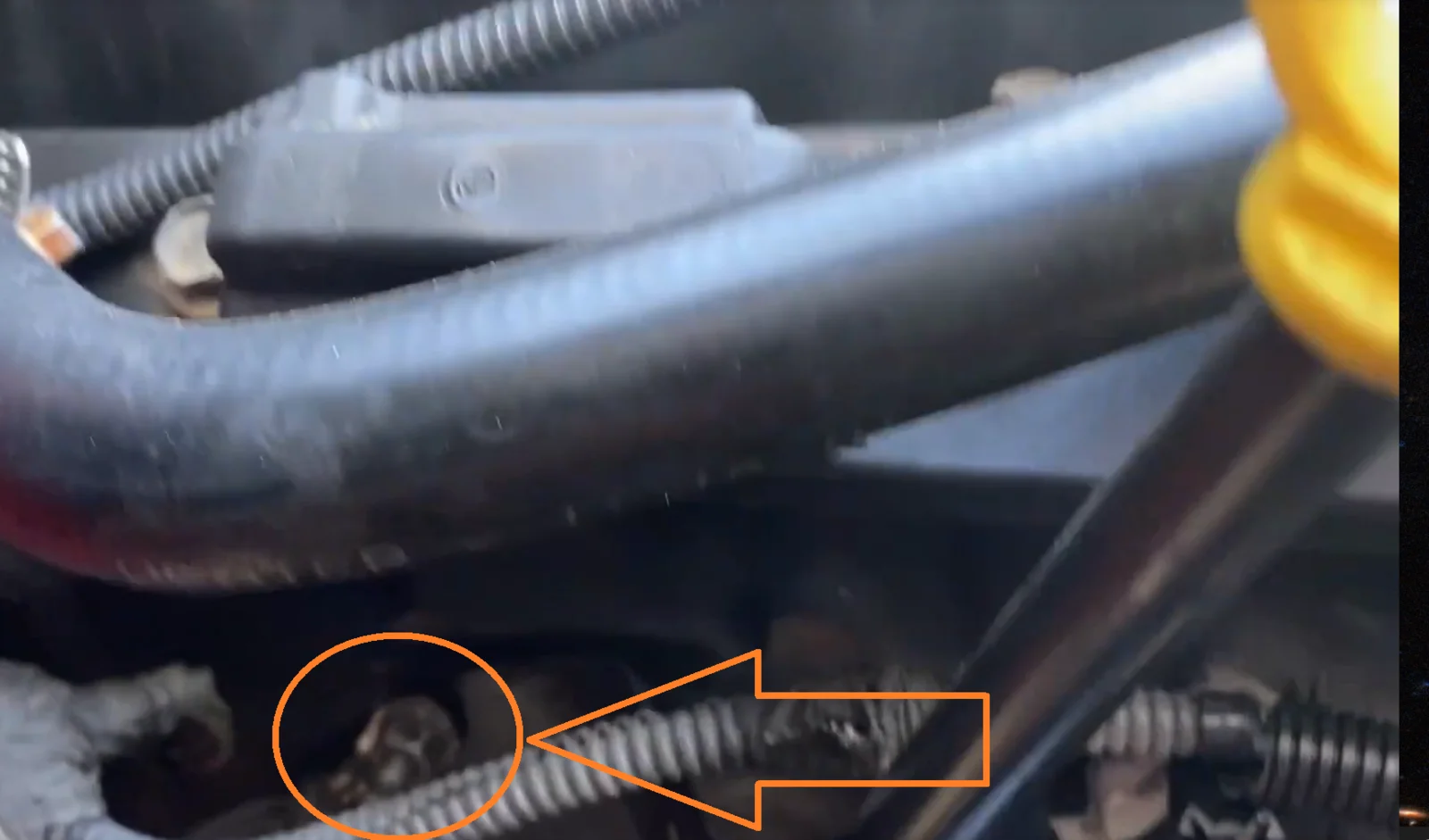

I have a 2006 Wrangler X with the 4.0 (auto), and the same issues:
- Intermittent bucking/surging/limp and P0344, P0340, P0457 & P0456. So far, I've replaced:
  • OPDA (by the dealership. I assume they used an OEM or NAPA cam position sensor and threw out my original one).
  • New (rebuilt) PCM, all four O2 Sensors, Crank sensor, Cam position sensor (yes, again), Intake/charge-air temp sensor (three times!!!), spark plugs, and the catalytic converters (twice).
  • The dealership also removed and tore down the transmission to replace an internal temperature sensor (as part of troubleshooting and trying to fix this exact same problem)!
The PCM change fixed the problem for a few months, but now it's back. :cry:
Per some research I'm going to try cleaning the harness' ground contact on the passenger side of the engine block and look for any signs of harness wear (near the base of the dipstick?). I've also purchased a Crown ODPA, but haven't installed it yet.
  • Update 1: After clearing the PCM codes and cleaning the harness ground contact, the P0340 came back immediately, but no P0344 (yet?). Also tried swapping the cam position sensor again (with the one that came with the Crown OPDA), but no luck.
  • Update 2: After swapping the cam sensor with the one that came with the Crown OPDA, the check-engine light turned off. No more bucking/limp, for a couple weeks now. Not sure if the cam sensor fixed it, or if it just took the PCM a while to stabilize after cleaning the harness ground contact. I'll post again if the light comes back on (fingers crossed).
  • Update 3: It has been a few months, and still no limp mode ... ever!
    • I'm cautiously regarding it as permanently fixed now!
    • Anyone experiencing P0344, P0340, bucking/surging/etc. should definitely remove, clean, and re-tighten the ground wire connection for the primary wiring harness on the passenger side of the engine.
