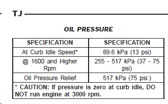

Thanks, what am I looking for with the gauge? How do I know it has good pressure?
I believe the spec from the factory service manual (FSM) is 13 PSI at idle.
Otherwise, 10 PSI per 1000 RPM. So 20 PSI at 2000 RPM, etc.
Edit: Here's the chart from the FSM:
