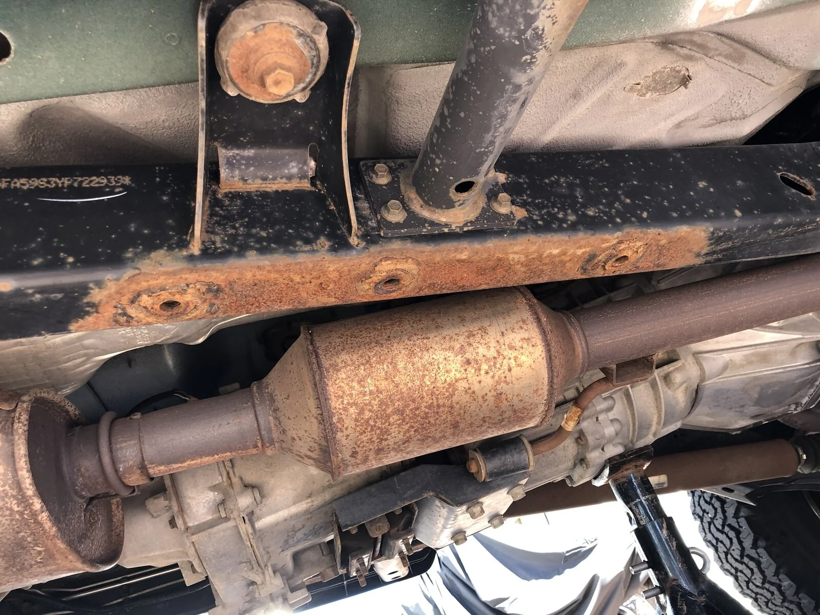

Check your skid plate, it is probably rusty

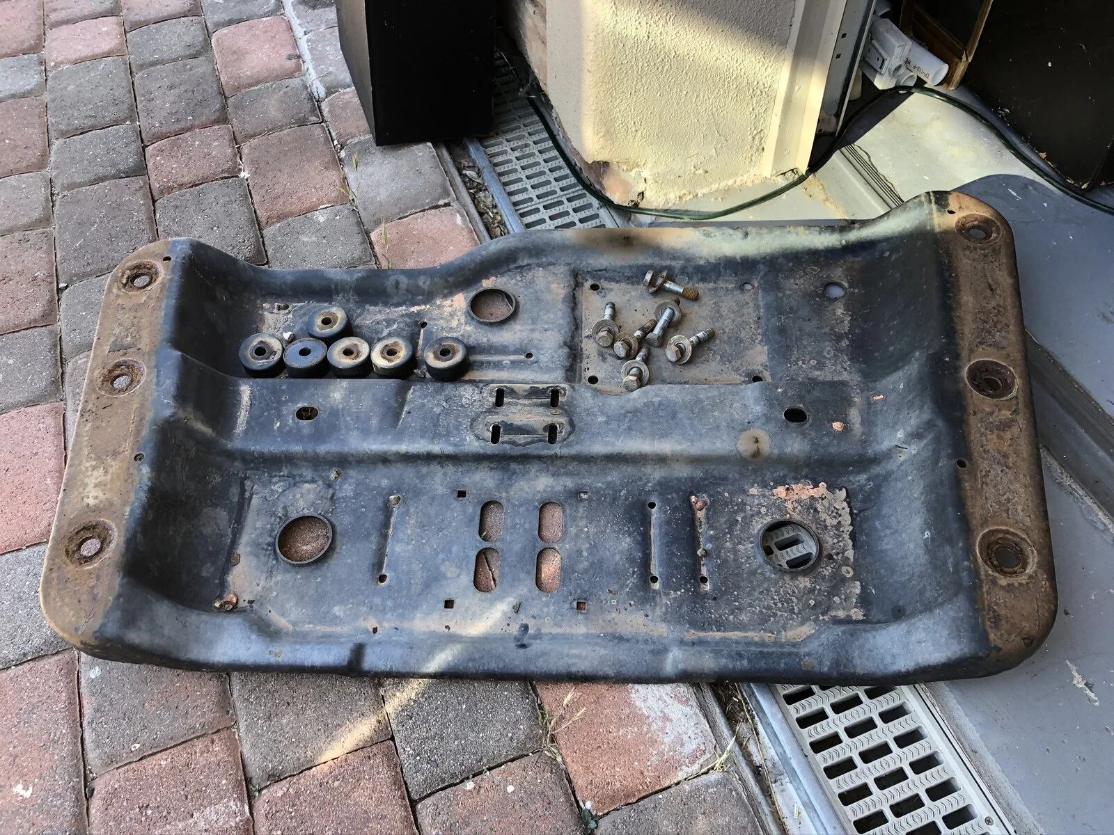

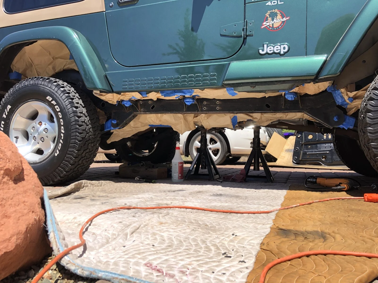

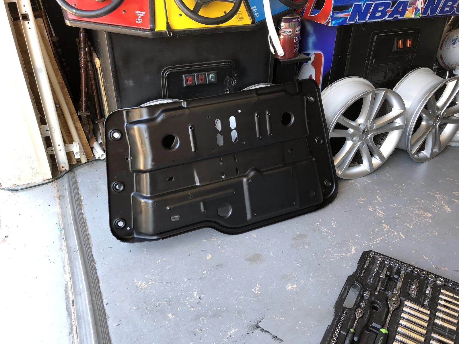

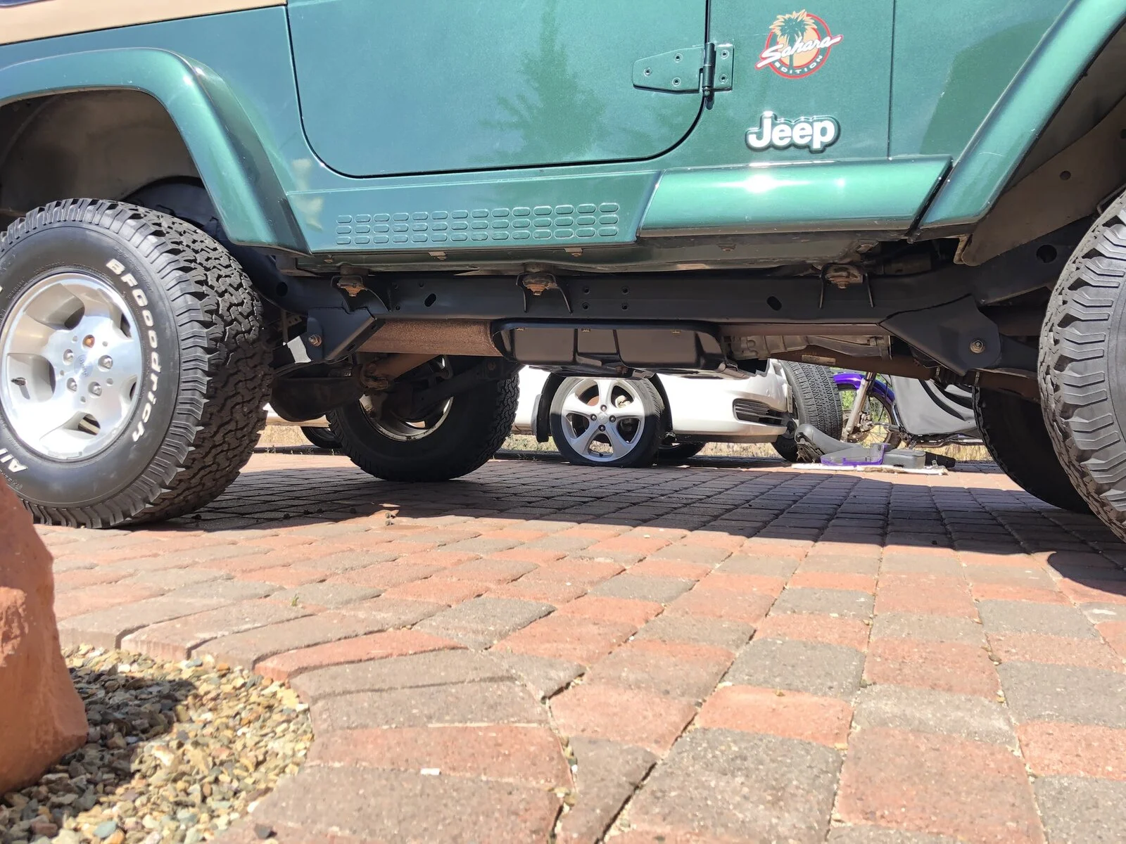

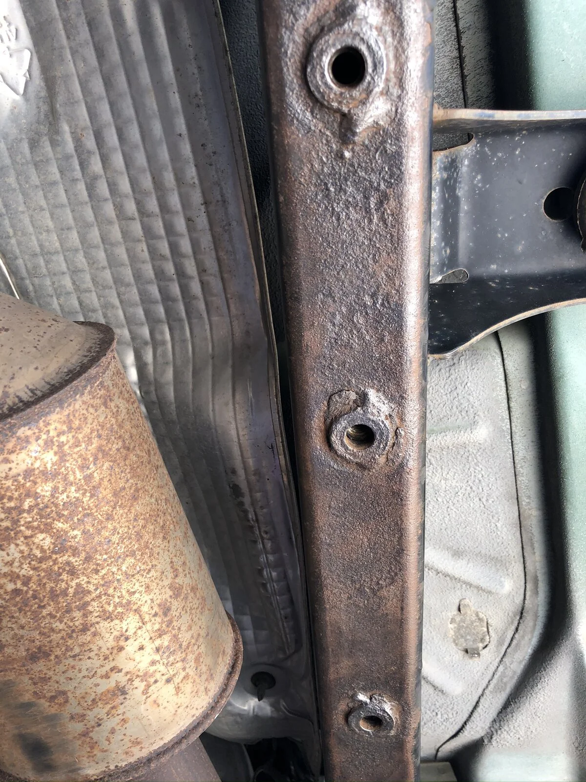

I found similar on my last jeep. The outside had very light surface rust but no rot, but the section between the frame and the skid plate was a mess. Cleaned it up like you did.
View attachment 239485View attachment 239489View attachment 239486View attachment 239491View attachment 239488View attachment 239490View attachment 239487
It was a great project. Saved long term damage and now I know what is going on under there. Learned some new stuff along the way too.

Thanks, I cannot take credit as it was recommended to me by @Chris when I bought my TJ and asked what I should do for maintenance. I posted the thread because it really surprised me how much rust there was on an otherwise perfect frame.

A couple of washers between the skid and frame lets the water out. Zero rust and no painting needed.

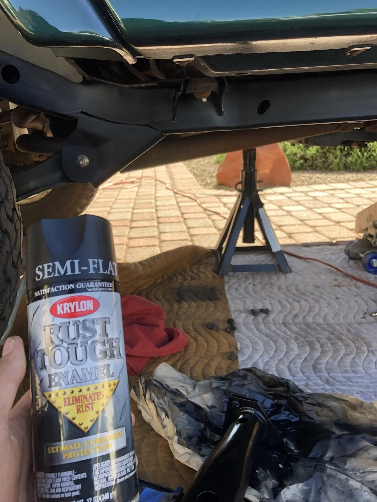

I decided not to do this, it was suggested by a few folks. Frame and skid plate are clean of rust, primed and painted. I also added oil based lubricant between them prior to reassembly. I also plan on checking it again every so often. I am trying to keep things as stock as possible and when I looked at the indentation on the skid plate it would have taken a bunch of washers to separate the two. It would mean the transmission was dropped and I just didn’t want to mess with the look of the Jeep or mechanics of the transmission.

Just an FYI for Jeep owners that can't keep their Jeeps inside. I found my skid similar to the OP's. I cleaned, primed and painted, like the OP. A year later, when I removed the skid for my SYE, I had to clean, prime and paint again.
I believe in certain conditions or areas of the country, skid maintenance is a yearly job. I coat my undercarriage twice per year with Fluid Film, and my frame looks fine.
initially I too was adding lubricant (fluid film in my case) between the skid & rails, but in time I realized it was attracting enough dirt & debris from off road and that it all eventually combined to became an abrasive which grinded on things, not good; despite the fact that the skid appears static, the frame does move & flex enough to present issues.
I abandoned that regimen in favor of adding just one washer to each bolt as a very thin spacer between the skid & rails which is enough to separate these pieces AND for great air circulation; despite that indentation on the skid the protrusion of the nutsert on the frame side fills it enough that the addition of one washer allows me to see a space between the two, a condition lacking in the original design which explains why these areas are rusted even in non-rustbelt states... if you trap water between two pieces of iron it'll rust anywhere, eventually.
On my rig it's a small thing, barely noticeable, but something I believe will go a great distance towards slowing or eliminating the issue caused by this design.
