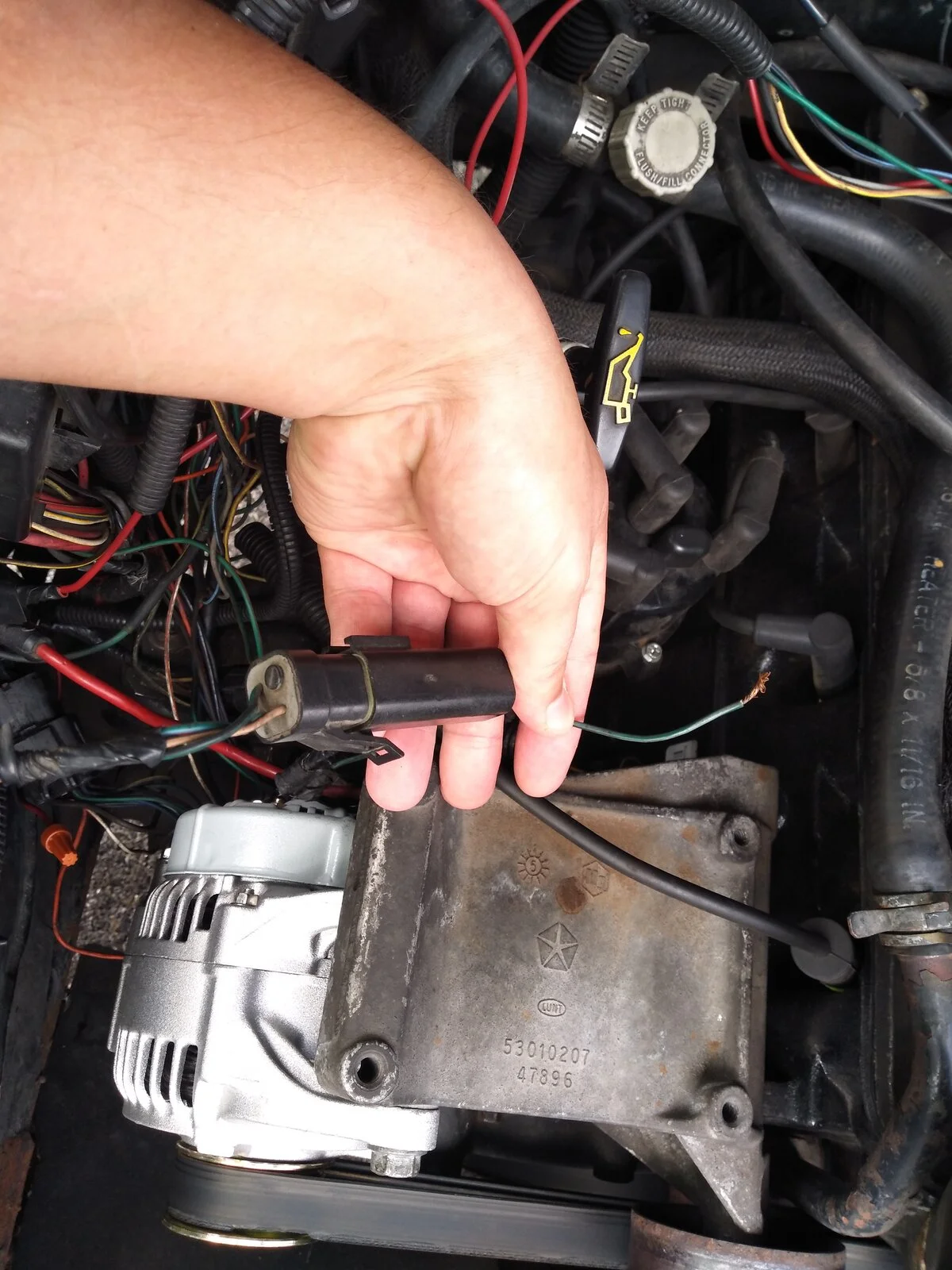

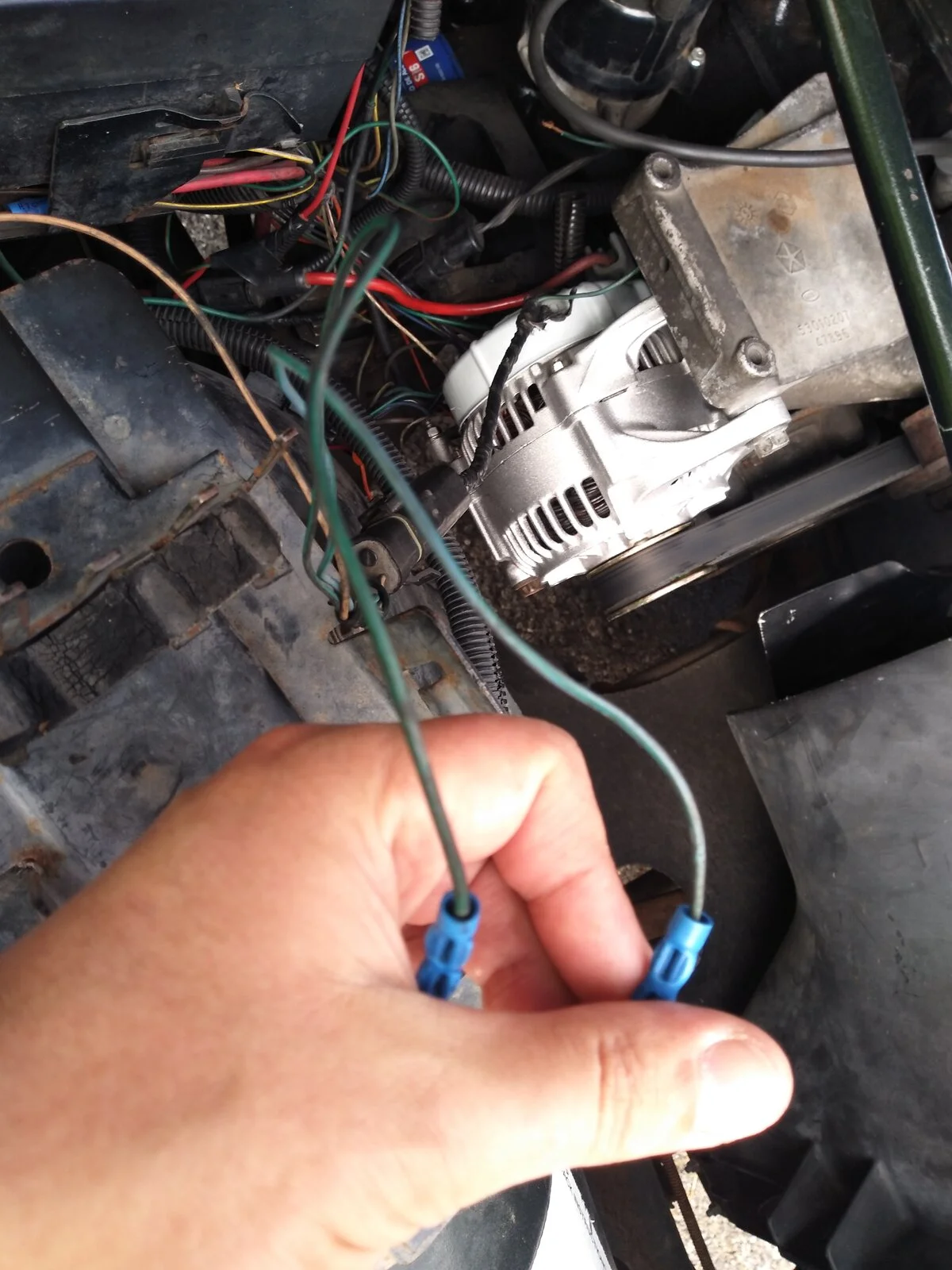

Ok so the wires coming from the alternator going to a plug connector. Green one is loose an can't tell where it's supposed to go or come from. An other loose one is green an black stripe from other side of connector an it's going nowhere also. Also green one isn't going to anything either. Wiring diagram didn't show green wire so I have no clue what it's for
Ok so the green wire is coming from the alternator side but I see nowhere that it would've connected to the alternator. That same wire is loose on the other side of that plug plus the other wire. I'm at a loss cause I don't understand the wiring diagrams very well
