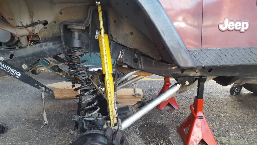

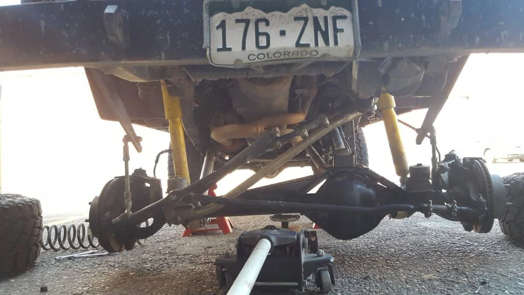

It might be the mid arms. The front axle will fall far enough that the frame side track bar mount will bind. This is after I disconnect the sway bar links. The Currie 4" springs will come out with a little effort.
Reactions: Matt77
You have a mid arm setup?
If so, that makes sense then. With my Savvy arms the steering and brake calipers keep it from dropping far enough to get the springs out. Well, maybe I could get them out with a long pry bar. But they don’t just come out easily like you’re talking about.
Reactions: Matt77
Makes sense. My memory is that short arms bind against the lower axle mount at about 25" between shock mounts. Mine go to 29" because of the shallower angle.
Reactions: Matt77
That explains it then! I had no idea you had mid arms. Is it a Savvy mid arm kit?
Reactions: Matt77
It is. One of the very first to ship. I haven't seen another one in Colorado.

Remove the tires. If the control arms are stock stamped steel, then loosen the bolts. Loosen the track bar bushings. Disconnect the shocks at the lower mounts. Disconnect the sway bar. Lower the axle.
There have been times were I would jack up one side and attached a pair of spring compressors before droopping the axle. Having two pairs of compressors would be helpful if the same springs are going back in.
Having a couple flat pry bars might be useful.
When you cycle the axle, put the tires back on. It is helpful to know what the interferences are both with and without the shocks.
Once you go through the process and see what is going on, things should become far more clear.
