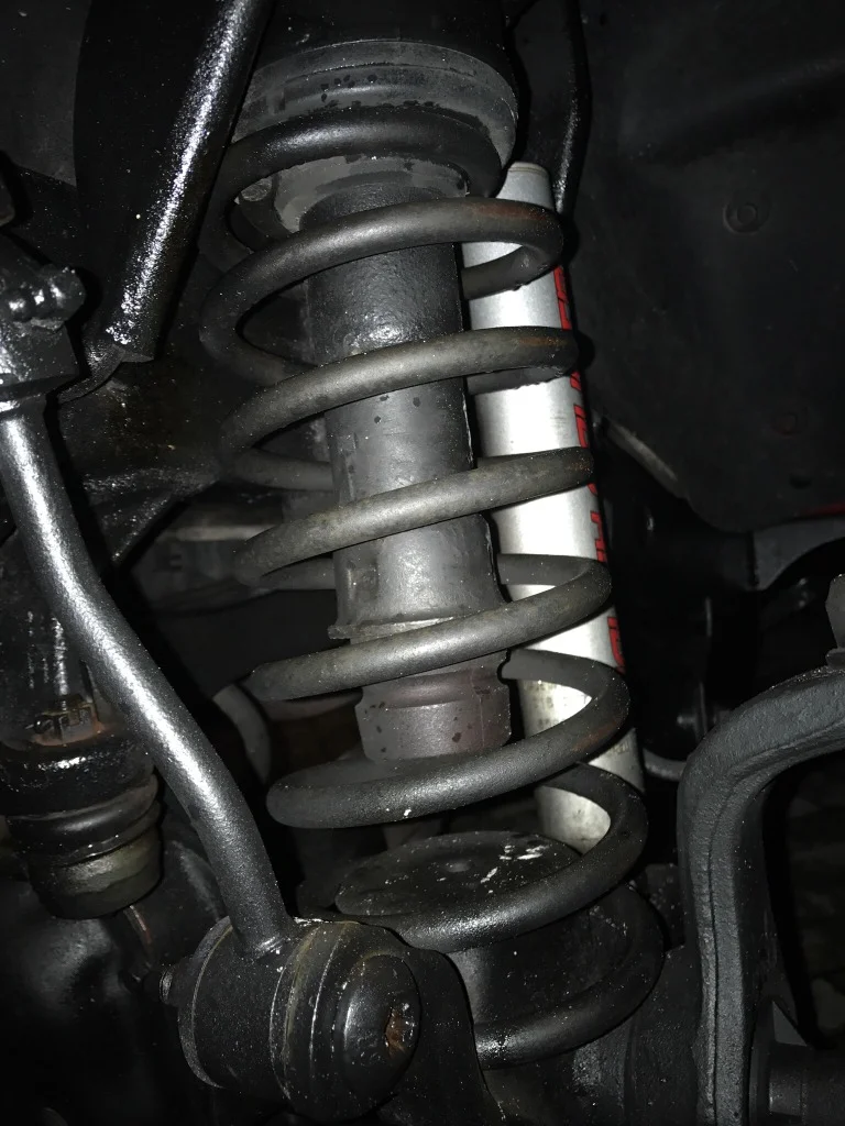

Whoever was reading this here just please don't be like me and throw a 2" bump stop extension on a 2" RC leveling kit. Looking forward to throwing my Rancho 2.5 lift on next week and getting around to taking care of this.
Whoever was reading this here just please don't be like me and throw a 2" bump stop extension on a 2" RC leveling kit. Looking forward to throwing my Rancho 2.5 lift on next week and getting around to taking care of this. View attachment 49113

Yeah man I just look at it sometimes when I cleaned my under body or just hanging around I get mad at myself for doing it!! But I did this leveling kit when I was an extreme noobie and when I never did work on a car like that and just was going buy instructions and a bunch of YouTube videos but I've done honestly a lot of research over this subject lately such as shock extensions spring rates brake / diff fluid lines and sways yata yata before purchasing all the parts to the combo

Man that's rough. And glad your figuring it out at least. Above I just meant my bump stop extensions are way too long and shouldn't have ordered them at all honestly with the spacer lift, limits my travel up front so much and sometimes I think I feel it in the daily ride comfort
