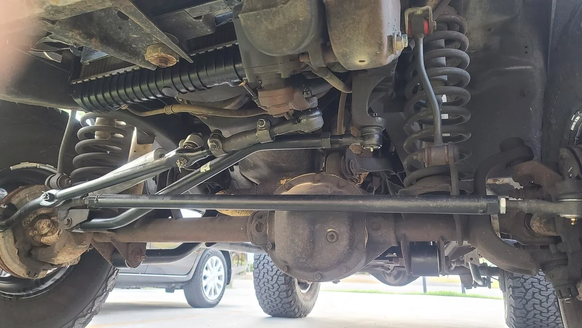

Sorry for the late follow-up, like i said bought the jeep about 2 months ago , I replaced wheel bearings, installed RC tie rod and new ends , new drag link, steering stabilizer, 2 weeks ago. Bought new tires and got them balanced at discount tire a week ago , today I installed 4 new RC lower control arms and RC adjustable trac bar as Jeep previously had the stock trac barn installed, drove after the control arms and trac bar insatll and still shaking but obviously very out of alignment, i will take it for alignment tomorrow, hopefully it will help but i dont have my hopes up as the shaking was completely still there. Shaking starts as about 65mph

There is a good thread on aligning a TJ, surprising easy and as accurate as taking to a shop. If you did any of the work under there, you will have no problems...

Yes, you can take it back. Stress that TJ’s with bigger tires are extremely tricky about balance, and it needs to be perfect, not just good enough. Make sure you tell this to the tech who is doing the balancing.
FWIW, if it was a tire balance issue, I would expect it around 40-50mph and not 65.
I would get under my rig and make sure the suspension bolts are torqued you spec.
I would also align it myself via the link above.
