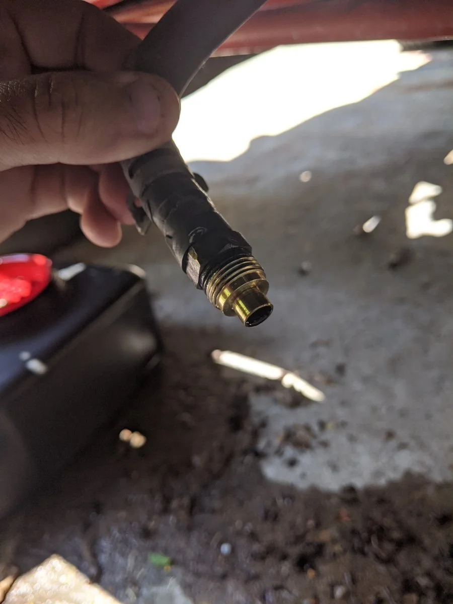

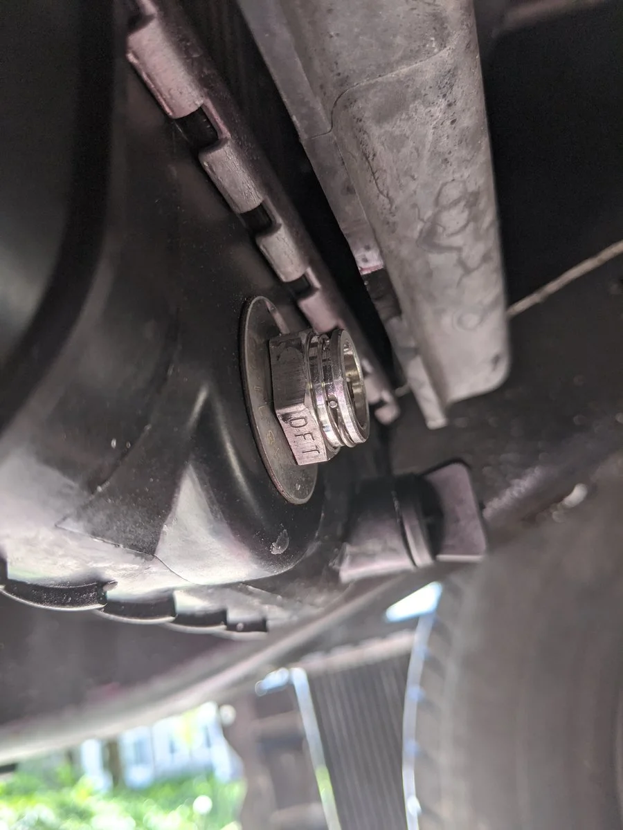

Well it doesn't fucking matter now I guess - the radiator I purchased from Oreilly's that they swore was drop in has different fittings than my A/C and auto trans lines, looks like theirs came with quick disconnect ports with those clips and my lines aren't compatible.
I couldn't find any adapters and they basically told me I could return it and get a different one that is cheaper and appears to have the correct fittings - an option they neglected to mention when I picked it up.
Old port
New Port
If anyone has any suggestions, this is one I haven't encountered before and I'm about ready to pull the unit out and take it back.
You can I get a adapter that will plug into that new radiator port that allows you to slide the hole over it like a barbed fitting and up just put a hose clamp on it.
Give me just a minute and I’ll find what it is for you.
I'd cry ha. I found Dorman 800-605 but that seems to solve the opposite problem (i.e. goes into the original port to convert to a quick clip disconnect style fitting)
You have to remove all the fittings on the hose end,so that you just have a bare hose.
The tube goes in the radiator fitting and the spring clip thing holds it In the fitting.
Ok, so remove the end piece that is currently in both hoses, insert the one you and/or Tom linked into each hose, and then just pop it in the quick disco port on the radiator? Thank you guys for the suggestions, this is a new one for me. I'll give it a shot.
Reactions: MountaineerTom
Ended up swapping the radiator I was given with another that had much more similar ports for the hose connections. They still didn't fit but this one came with new adapters so we cut the old hoses and inserted the new fittings which look quite a bit like the ones you two described. It's all connected now and I'll be filling it shortly. Thanks again all for the help
