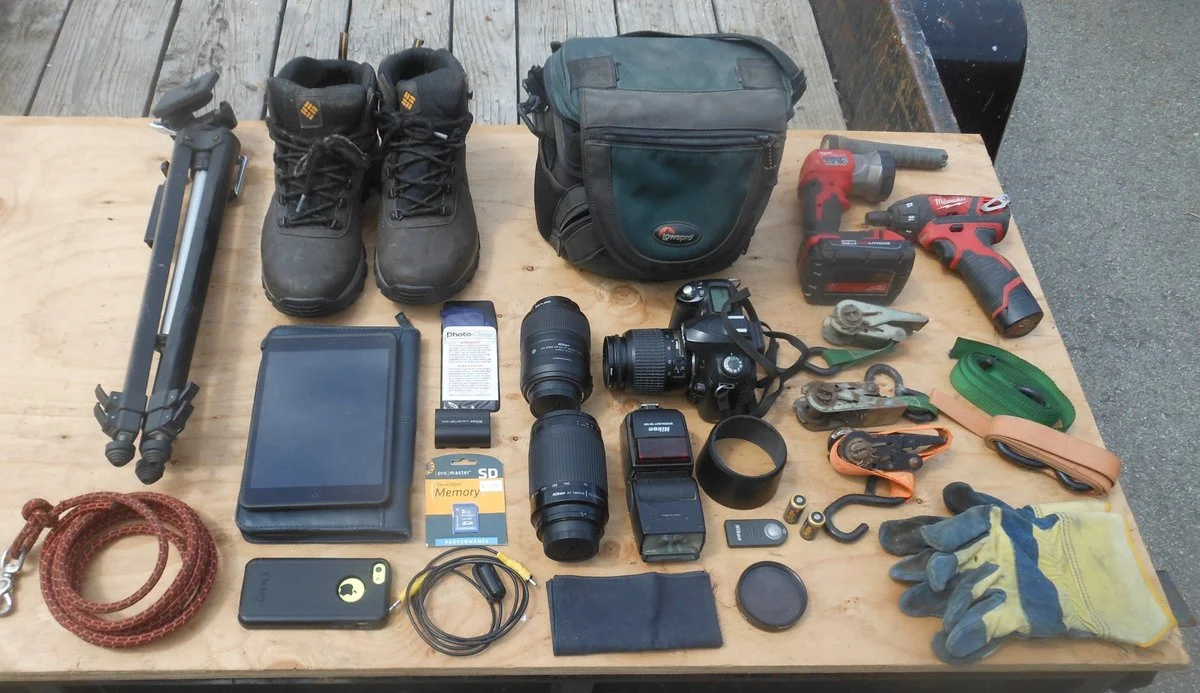

Last summer I made an insurance claim for a stolen watch, they wanted a picture of me wearing it.

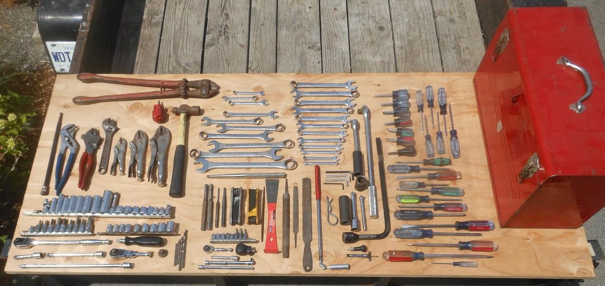

On that note I laid out ALL my tools and photoed everything. If someone stole my trailer there is no way I could list everything. This photo record will definitely ease the pain of a claim.

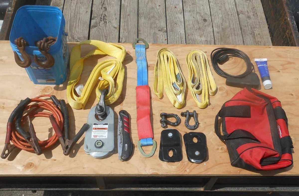

These are my winching accessories

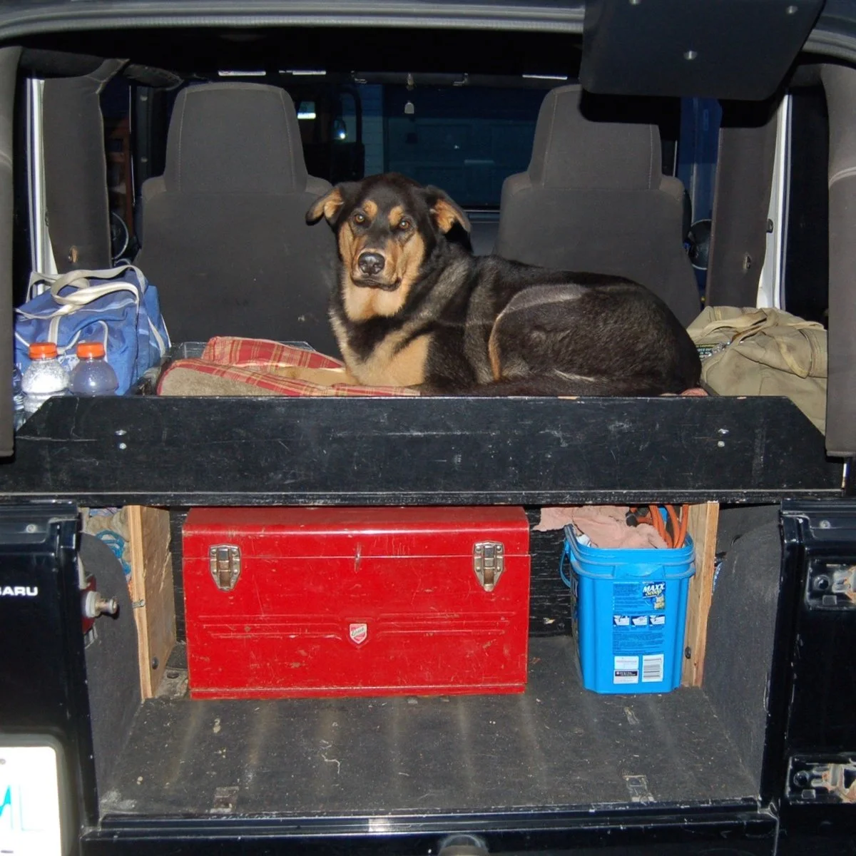

And Misc Shit always in the Jeep.... even a dog lease lol
This tool box is too big with too much stuff but some of the tools are good when overlanding if the trailer needs work or if I need to fix something at my kids homes.
Maybe too much but it all fits so... it'll likely not get smaller.
I'd like to see what that all looks like laid out. It may not be as much as you think.
I will post pics once I get it assembled and organized.

Winch accessories, 2 pulleys, 2 straps, 2 shackles, gloves
This is in my recovery kit.
