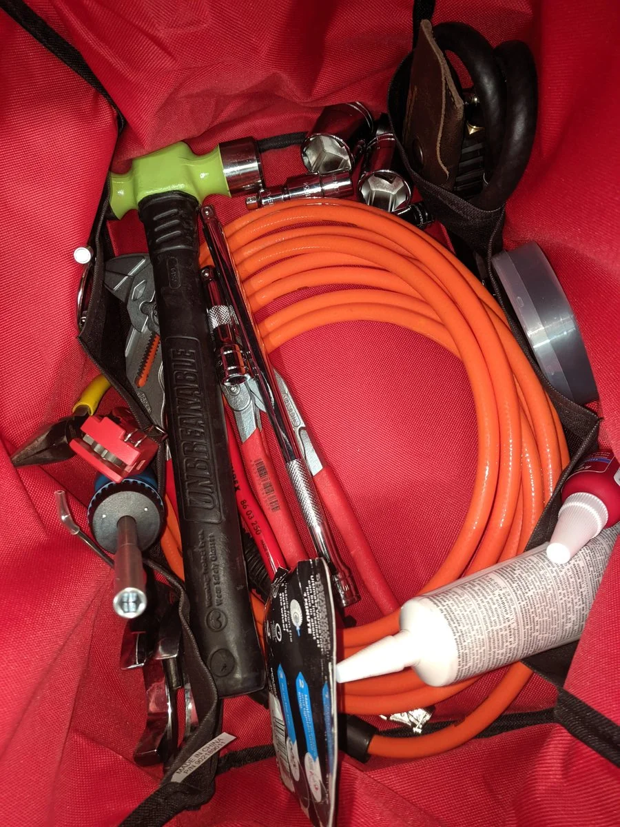

Slowly but surely my Jeep tool kit is coming together.

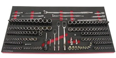

I've been toying with the idea of making a "false top" cover over my fuel cell with a hinged top so I can place the tools in 2" thick foam cut out to make a toolbox of sorts.
Pros are that everything will have a place, even tools too big/long to fit in a bag. And nothing will rattle or clank like in a bag. Cons are that I'd need to grab what I need through the front and if it's rainy or muddy that'll make the seats messy. The foam will only be a few pounds heavier than a bag (if that much) and if the tools I carry ever change I can replace just a section of the foam and make new cutouts in it.
Thoughts?
Since you carry your spare in the back, have you considered the the void under the rim for tool bags?
I need to figure out the best way to utilize that space; otherwise it's wasted space. The 37" tire is wedged in the tub and isn't fast to lift up. I want my tools quickly accessible along with recovery gear. I don't mind if spare parts take a little longer to get to. Camping gear, cooler, and other "luggage" will be going on top of the spare. That'll all be out normally while offroad but will still be in for overlanding type trips if I'm between camp sites.
It might be a good space for jumper cables which could come out through the center.
