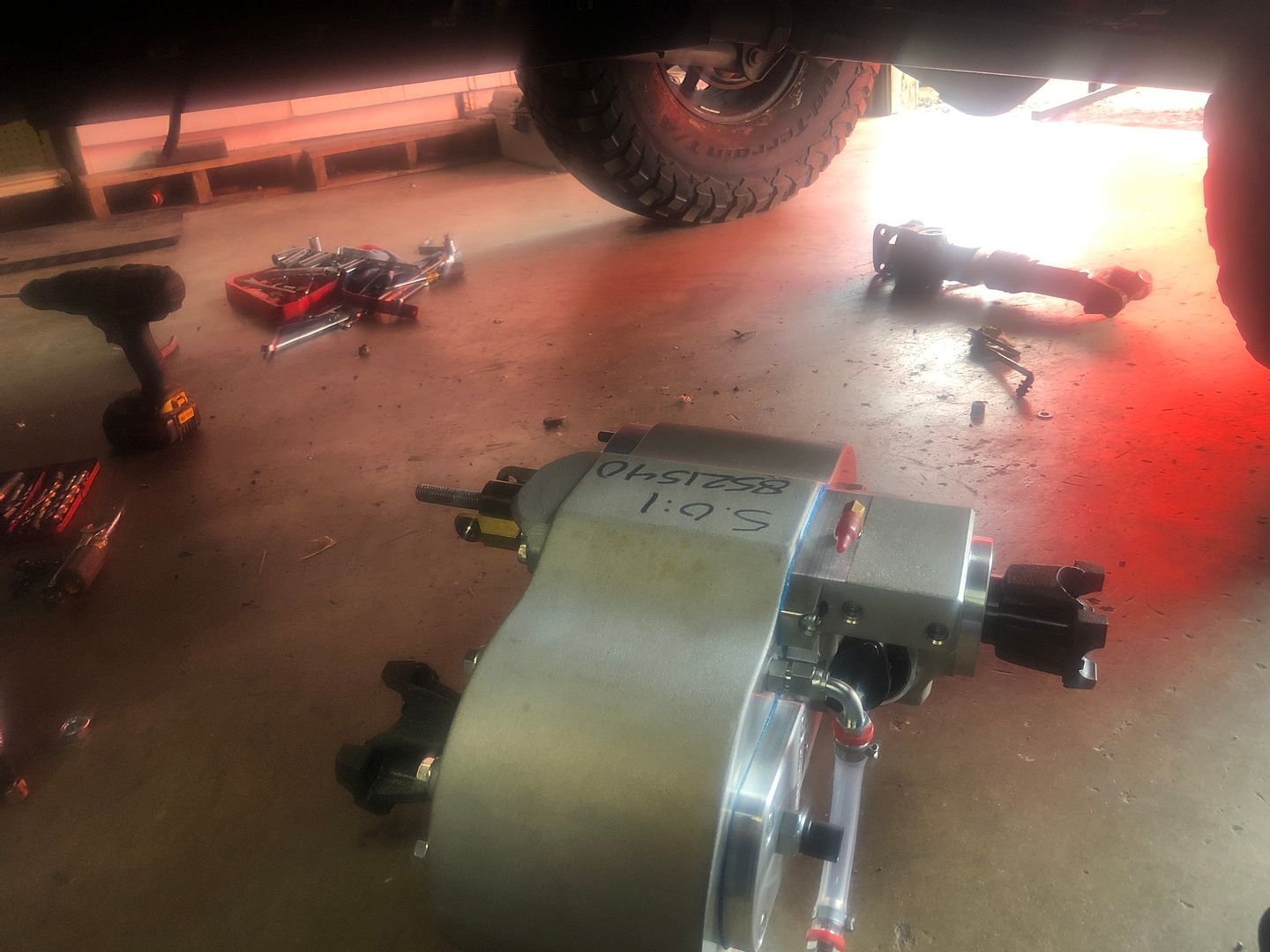

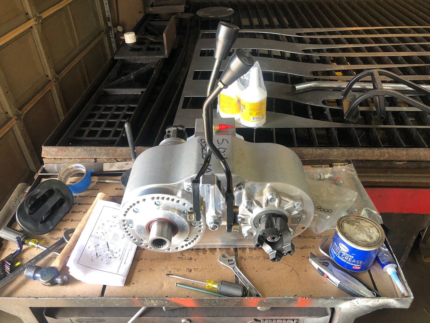

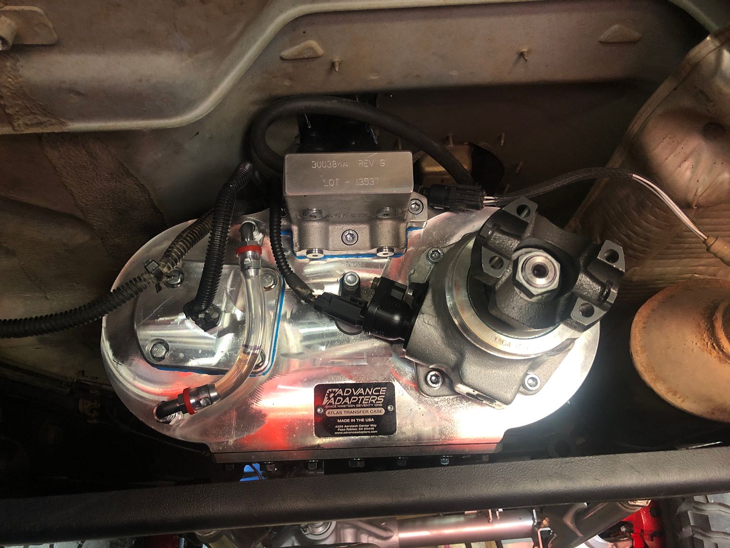

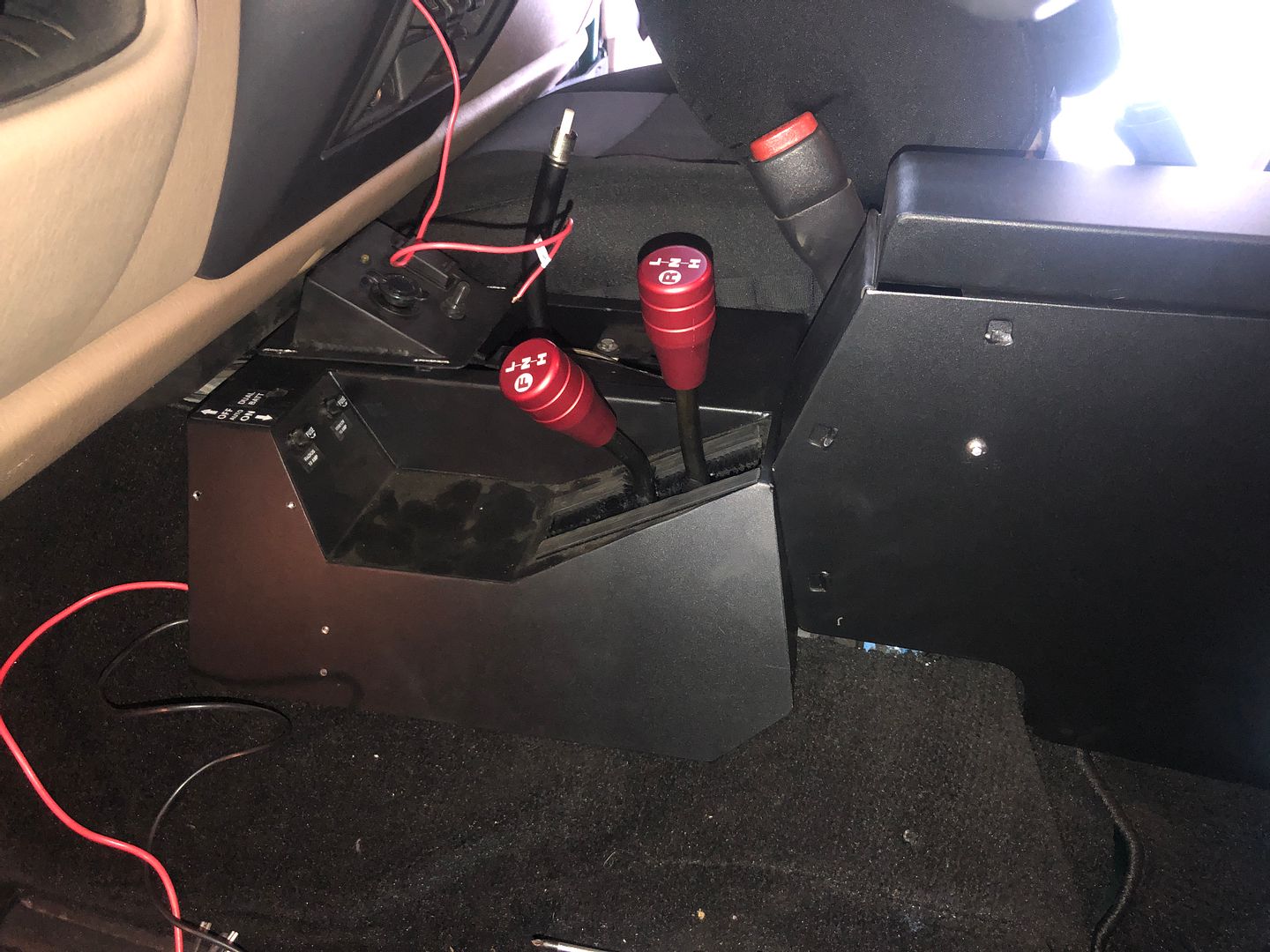

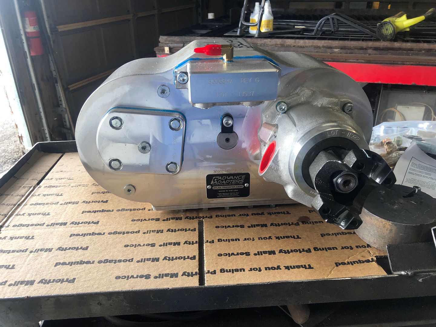

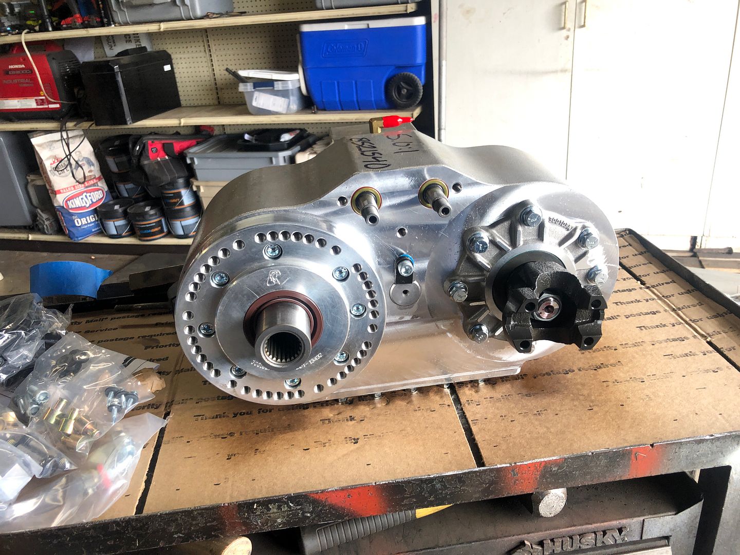

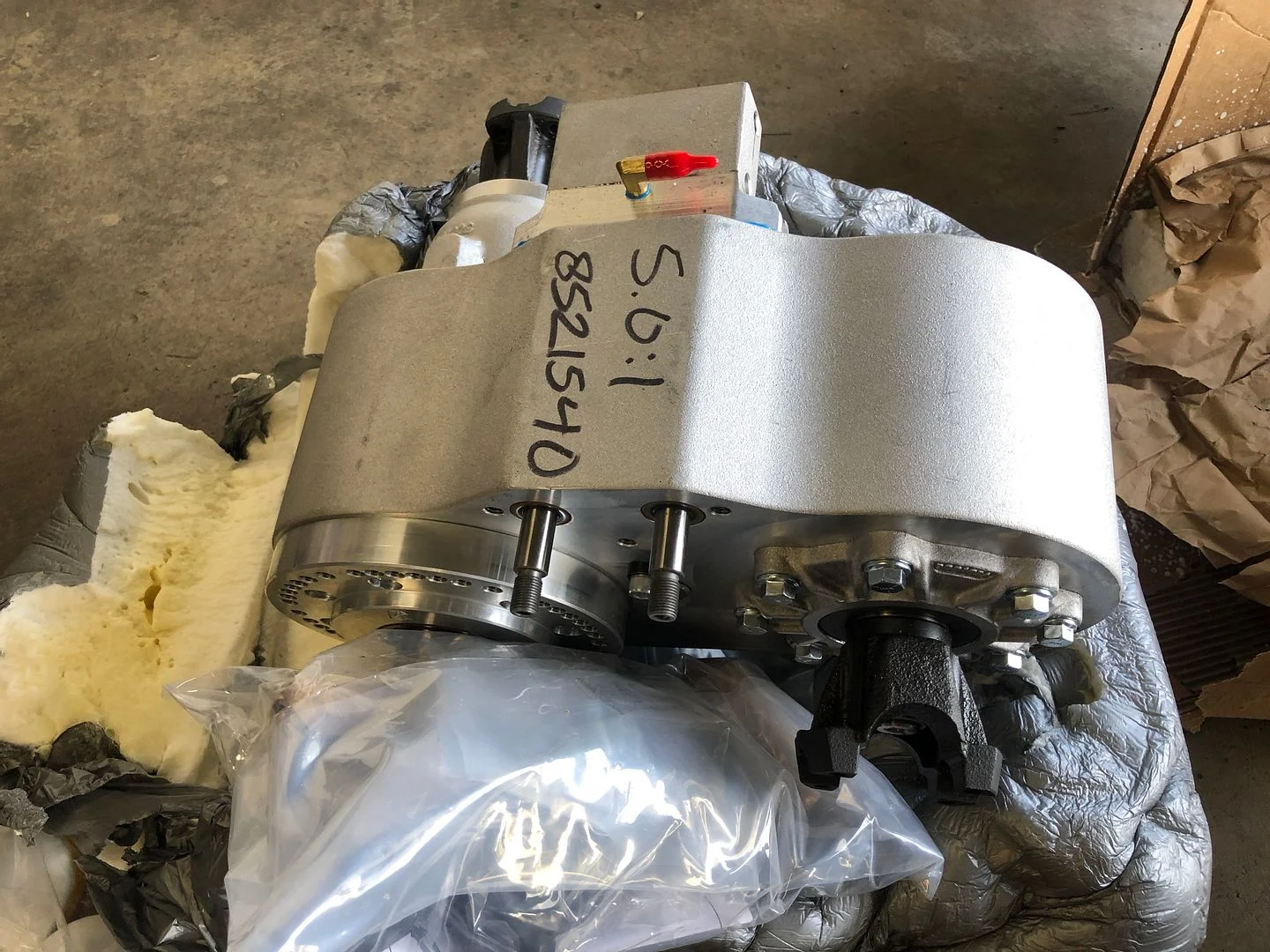

Shall we show some pics just keep everyone happy while they wait for theirs??
I did spray mine with a clear acrylic to preserve the beauty.
I even went deep for the red knobs.
Vic Carrol explained a few things that I was not clear on, one was that a 5:1 case in low with the engine spinning 2k, the output is spinning 10k. The Atlas II can handle it but that is some perspective. 50mph in lo is probably not a good idea. Shifting gets much easier after a few hundred miles, still need to be rolling, but not very fast.
