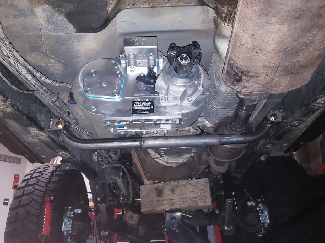

I didn't do a a step by step write up, but I can tell you that I did a lot a hammering for the both the case itself and a little for the 1350 CV joint on the driveshaft. I also had to cut a fair bit of the tunnel so the shifters would work. I think because mine is a 2.5 its a little more forward that with the 6.0. Otherwise it was a pretty straight forward install. Trans jack was a life saver.

When I had my Atlas up and in for mock-up purposes, I noticed the shift tower came reaaal close to the tub. I'm using a TT, which I'm sure has alot to do with it but was yours close, too?

I had to cut the tunnel to fit the shift tower itself. I used sheet metal to create a "new" section of tunnel. I'm running the UCF ultra high clearance with a highly modified stock trans mount. I'm waiting to install my TMR crossmember when my friends with welders open up. Hopefully I can lower mine a little with that crossmember. We shall see.

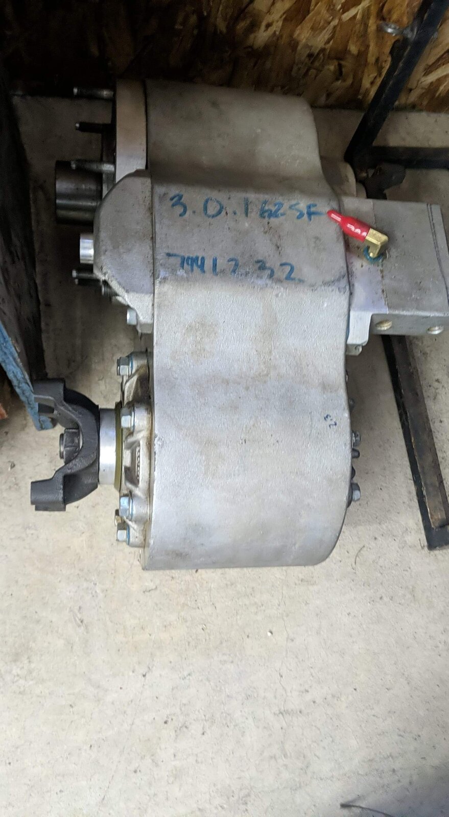

Bought this from a buddy last week. 3.0 Race case. Used but rebuilt with new yokes. Wasn't even looking for one, haha.

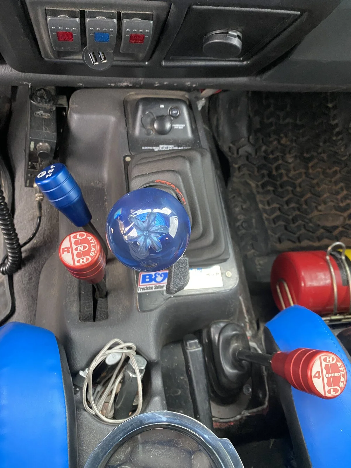

I did. I got an amazing deal on it as I was only planning to get the 2 speed. I was coming from a 4:1 case and occasionally wished I had less gearing in low. And this is perfect. I thought I would never use the doubler but as it turns out it is awesome and I use it quite often.however the best part is 2wd low ranges.

Do you have a stretched wheelbase? I've been worried about the fit on the 4 speed. I have planned to do some amount of tummy tuck. I have an extended range fuel tank as well, which won't leave me much room for even a small stretch. I'm running a GPS speedometer, so I guess I can at least make the 4speed a bit smaller.

Yes I’m stretched 5” in the rear. But I think if you went with the non speedo tail housing it would be doable.
