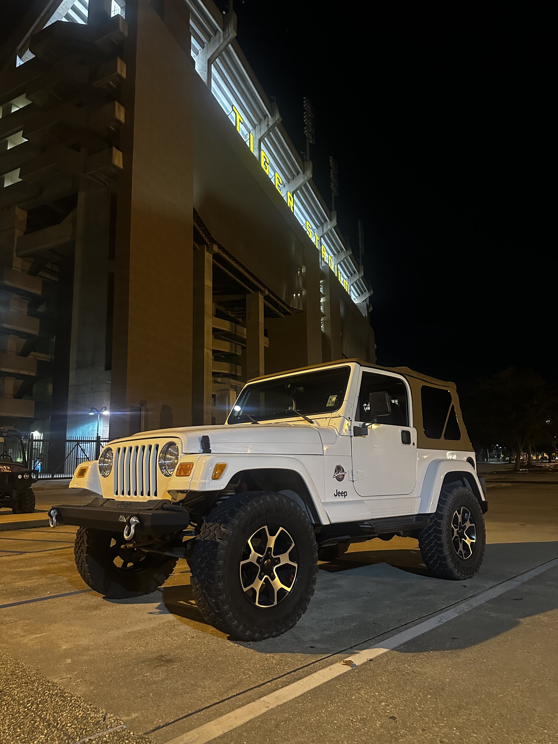

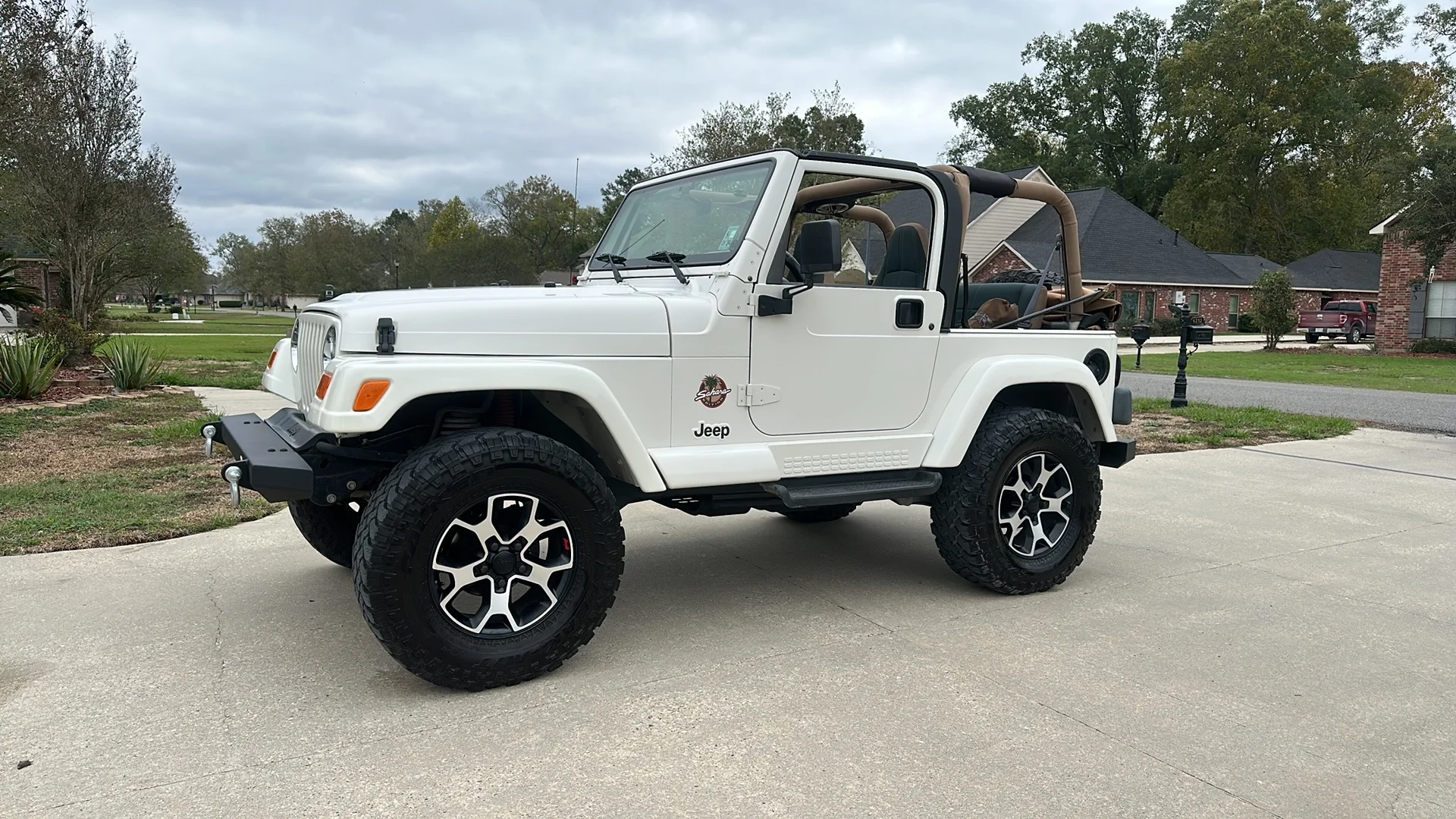

I’ve owned TJs with the 4.0 for the last 24 years and have always wanted to put a V8 in one. My 18 year old daughter thinks it would be cool to help put in a Corvette V8 and I don’t have a good argument against it besides the 5.9L Magnum being an easier swap.
I think I may finally be ready to just do it. I’ve got a 2000 Sahara currently with the 4.0, NV3550, and Dana 44. I’d always thought I’d buy a 4 cylinder TJ to do the V8 to but I think this might be a better candidate. First of all, it’s a nearly pristine specimen of a TJ so it will be nice to own for many years with the V8 vs. a “clapped out” 4 cylinder that I find for cheap that needs all manner of other stuff addressed. Also, it’s got a transmission that can handle the power (at least for a little while) and an adequate rear axel. Finally my 4.0 is currently a runner with 85,000 miles on the clock so I can probably sell it to recover a significant portion of the price of the donor motor whereas a 2.4L would go to the scrap yard.
I think I’ve settled on wanting to do a Corvette LS III. They’re plentiful, it saves 100 lbs over the 4.0 and it would just have the cool factor. I’ve also successfully performed an LS crate motor replacement myself before, albeit on a GM vehicle that already had one in it. So, I’m confident I can do the electrical and minor fabrication necessary to put one in a Jeep.
Is anyone aware of any particular gotchas with a true LS III out of a corvette vs. the more typical 5.3-6.2L truck motor swaps? I do want to retain the AC so I’ll need to have custom lines made to match up with whatever compressor people are using on TJs (Trailblazer maybe?). I also think I’d delete the TJ ECU and set up a custom gauge pod with all analog gauges. Will all of the HVAC controls work without the ECU or do they require modifications to make them work standalone?
