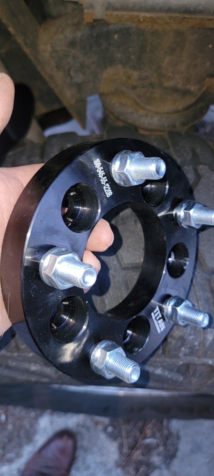

Unlike the thicker versions, the 1" Titan wheel adapter is lug centric. This means I don't need to drill these out. All is not completely lost on the pair I drilled. I will need one for the spare tire carrier.

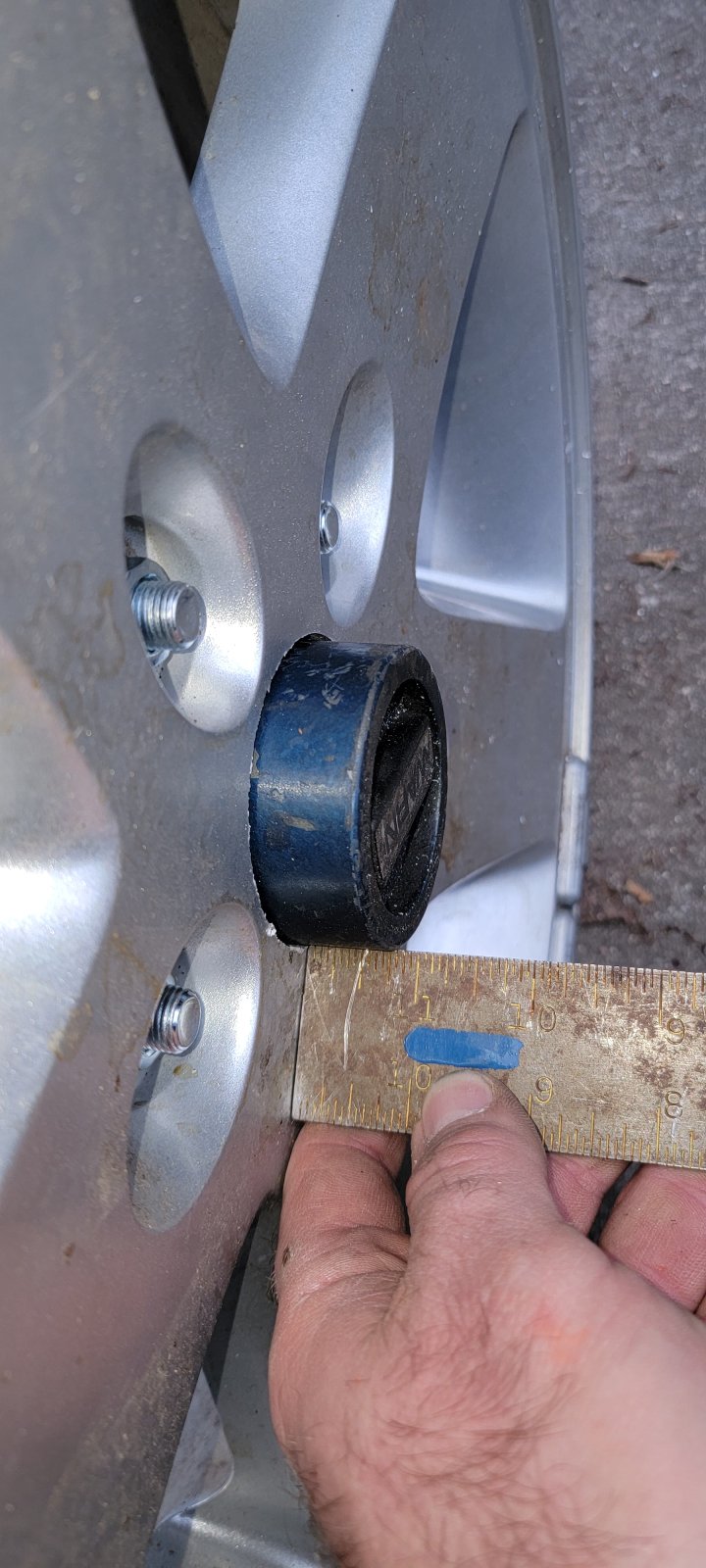

Here is the final stick out of the locking hub. About 7/8" from the wheel face.

I used those 1” titans as well but in the rear. Glad you got it figured out.

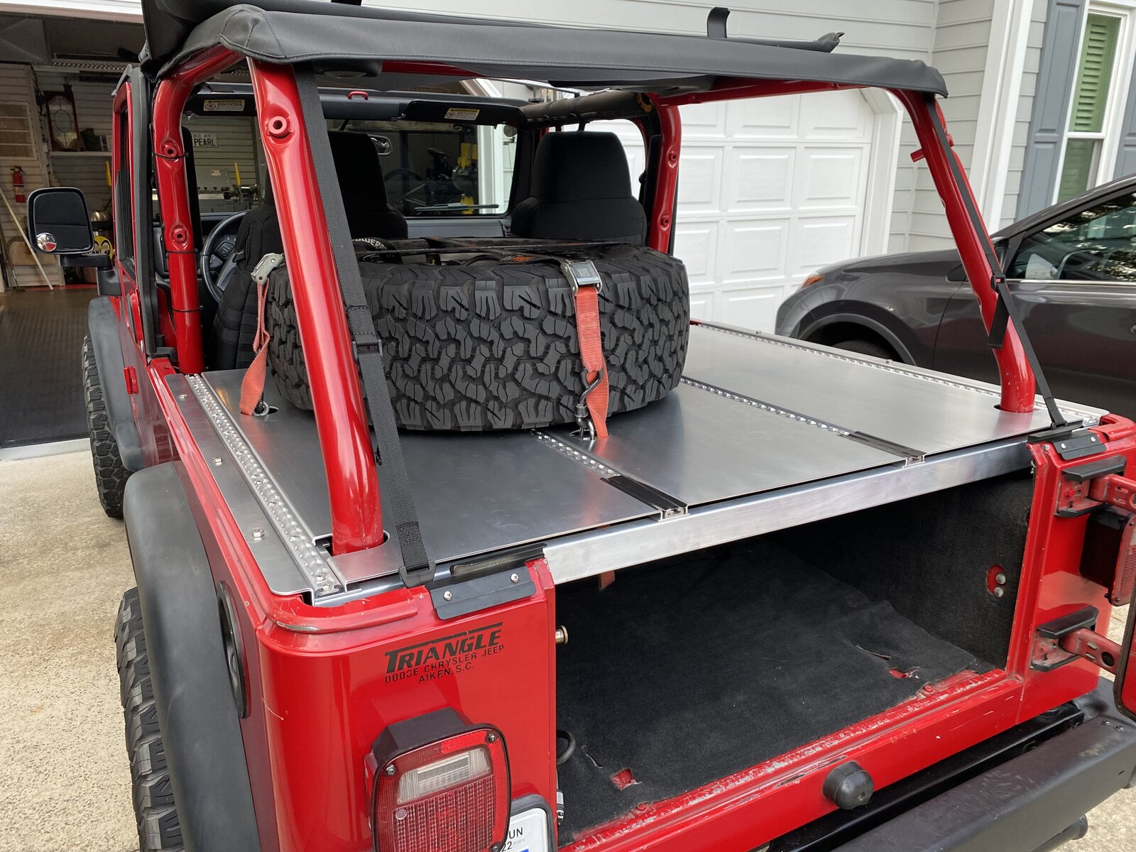

I’ve thought about doing something like this for the spare tire and have the fuel cell and tools inside. Another forum member posted this storage in a build thread at one point.
Reactions: lBasket and Tob
My thinking would be to keep the bed open for accessibility. Plus, if you do a traditional fuel cell, your filler will be above the tub so that much needs to be open anyway.
You've already spent enough time off camber that you know you don't want a higher center of gravity. That and those channels will fill up with dirt, dust, sand and be miserable to clean out. The sand bits land, the aluminum flexes, and then the sand works down in and gets wedged so you have to chisel it out. That is a 100% street driven storage that will never work well where it gets dirty.
That and the second time you need to dig something out of the front you will absolutely despise that it doesn't lift up.

There is very little about a fuel cell that has a filler neck above the top of the tub that does not suck.
Very true. I guess I will pay attention to the under seat gas tank because that seems to be the least compromise. I don’t like losing space and having filler above the tub, and I don’t like going to a 15 gallon under the tub…
