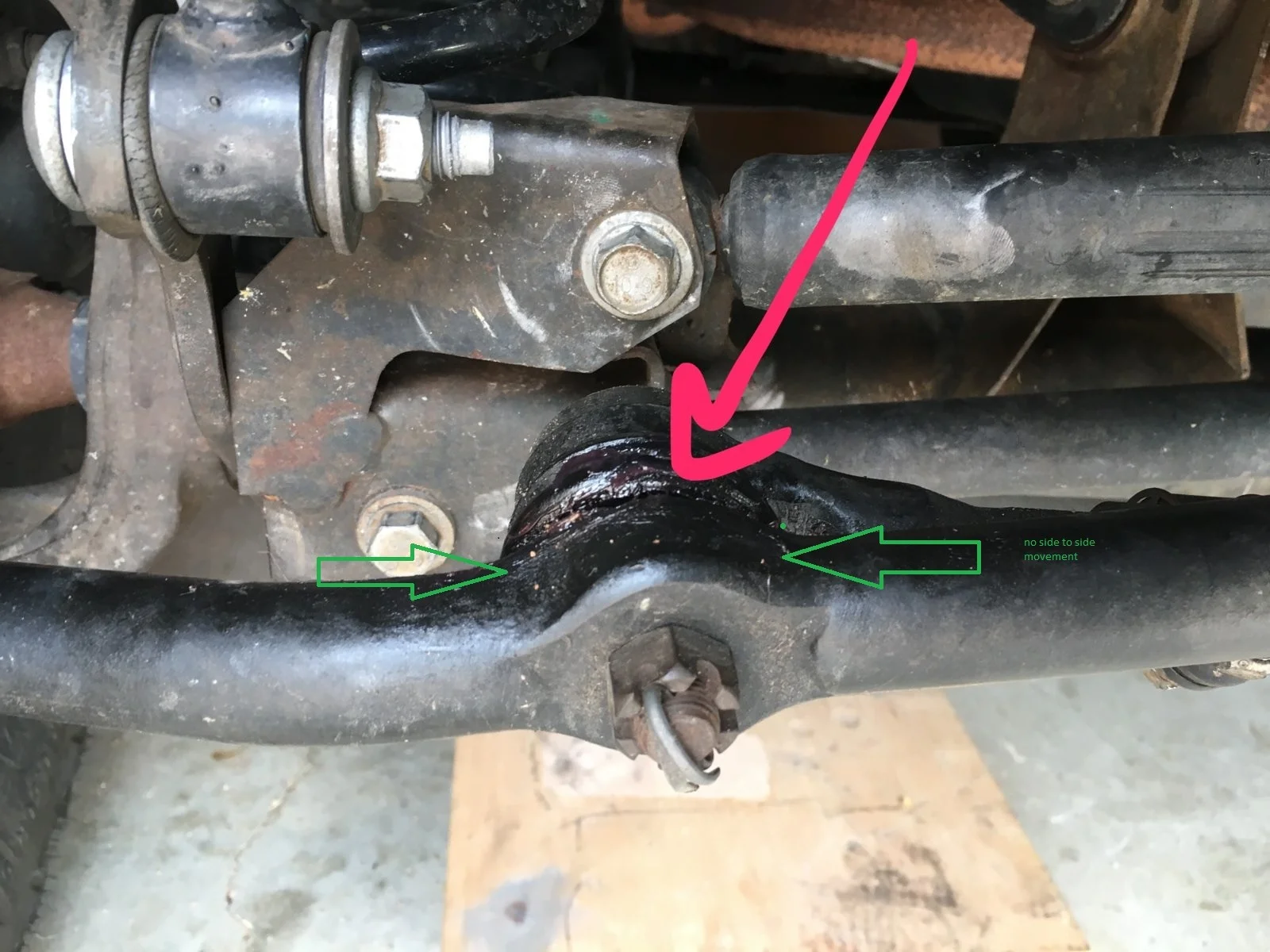

Ok, my axle is shifted toward the driver's side 1 1/16". The grease fitting (bushing???), not sure what it's really called, where the tie rod meets the drag link is busted. What are they called and where can I get a replacement?Keep in mind that a loose or bad track bar can never be the actual true root cause of DW. It can allow DW to develop more easily once triggered by something else like a bad tire but the track bar can never be the actual root cause trigger of DW.![]()

No side to side play. So that's positive! The other positive is the MML allowed me to remove the TC drop and not have vibes, and the oil pan is higher!View attachment 16573
Just because the grease boot is puking grease isn't a deal breaker. Do a dry steer test here and make sure this drag link joint doesn't have any side to side play.
